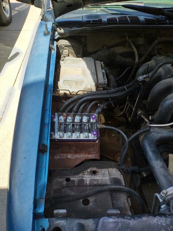

Decided to do front batteries delete. Use a Jim's Machineworx fuse block.  Voltage is 14.5/8 at idle. Full till it drops a volt. Got 40 more headway lifepo4. Going to add and have a total  144Ah.  All that wire. 2 runs of 2/0 welding wire from 270alt, 1 run 1/0 from 145alt to fuse block. 2 runs 2/0 to battery, one run 1/0 to the air compressors and mid/high amp. IMG_20220409_134844663_HDR.thumb.jpg.f4452e9e362d1ee3dbd0028cc3d5f027.jpg

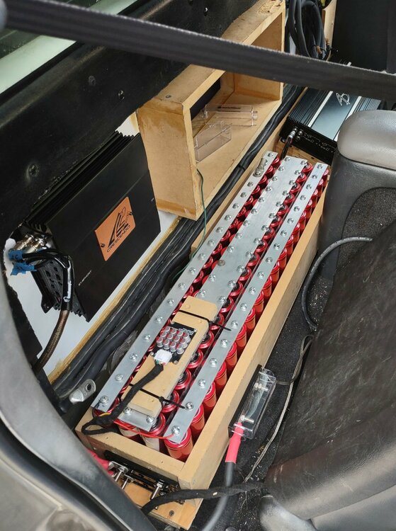

So I had to replace the mid/highs amp. It's starting to go. You could listen to music loud/low and on occasion you would get no sound for a few seconds. Tried different RCAs/deck same thing. I also did a complete front batteries delete/added headway cells.  Cells were charged then connected. Since they are used from batteryhookup.com instead of being 8ah per cell they are prolly 5ah at a min, so we can say 100ah minimum. Can I play all day and voltage not drop yes. Also fuck Google photos. New phone saves everything to it. And I don't like it. 454499550_IMG_20220420_1642458002.thumb.jpg.cc29c2ad2c828429aac0113f88ae98a2.jpg
