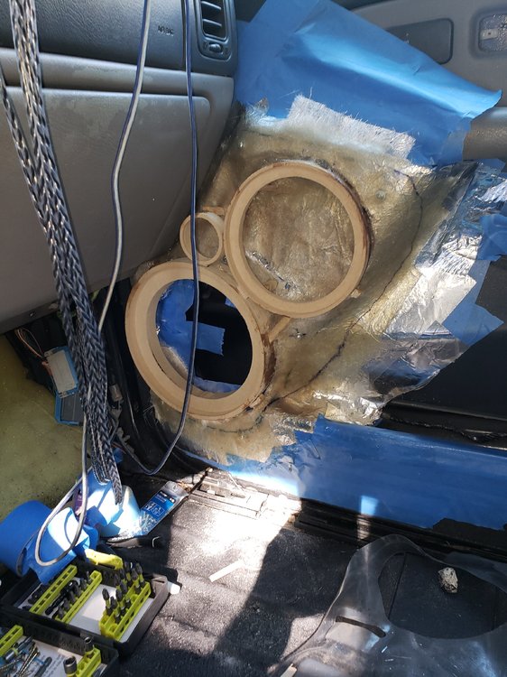

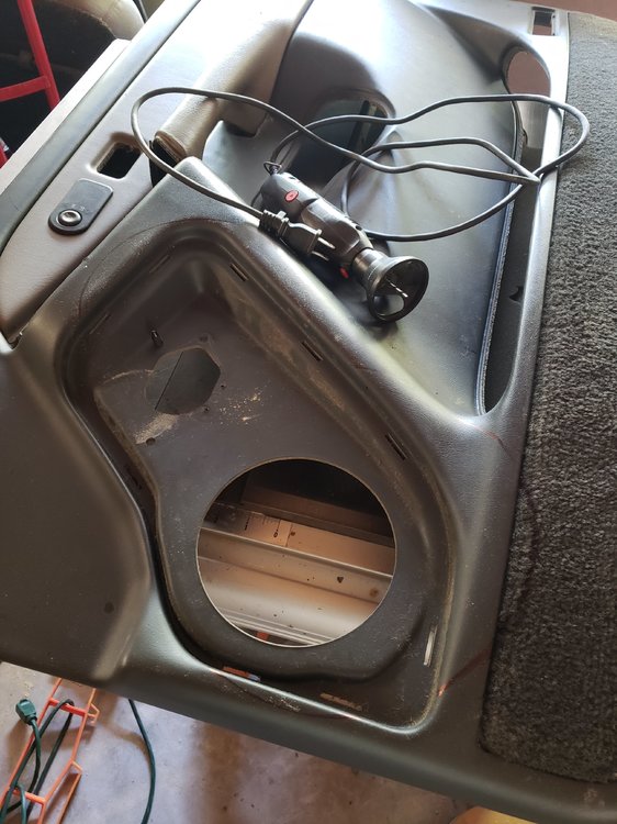

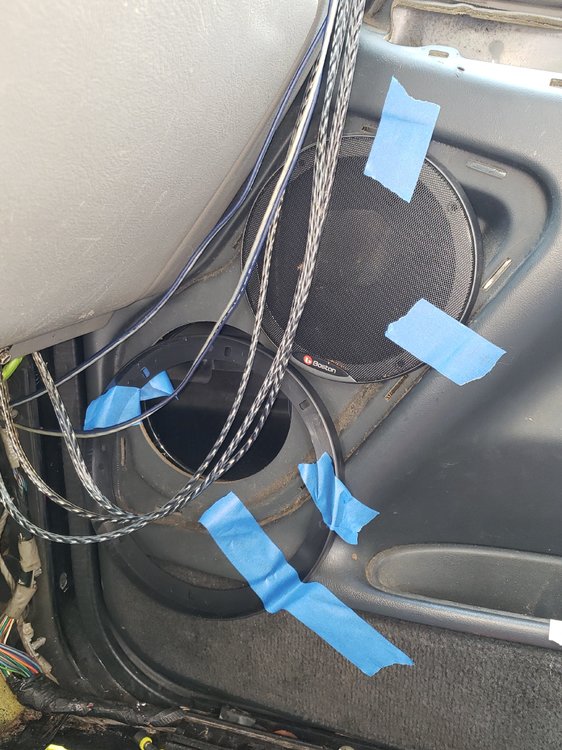

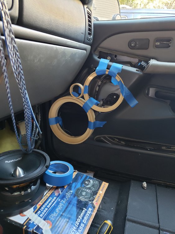

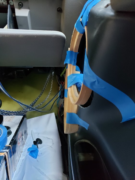

Been trying to figure out where I wanted to put the 8's. Was gonna put them in the front of the console but didn't like the looks. So back to the doors. This is gonna have to be the location I have to do. It'll have to be out further than I wanted. Every spot I wanted and figured I could cut a little metal. Had window or door bracing in the spot. Never done this before so I really hope I pull it off decently. The wires will be removed and new ran. Was gonna leave the rca but have better ones now. Just have to pull the dash cap and front off. To remove the rcas and run the new ones.
I actually moved the speakers up another 1/4" and should work out much better.

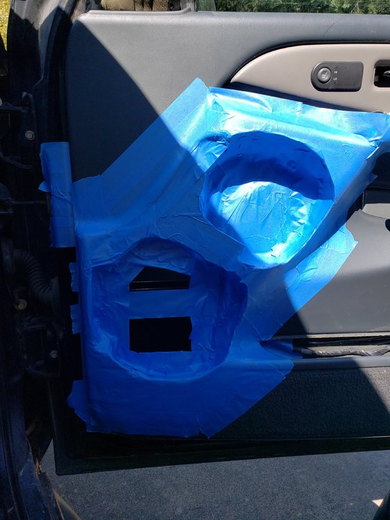

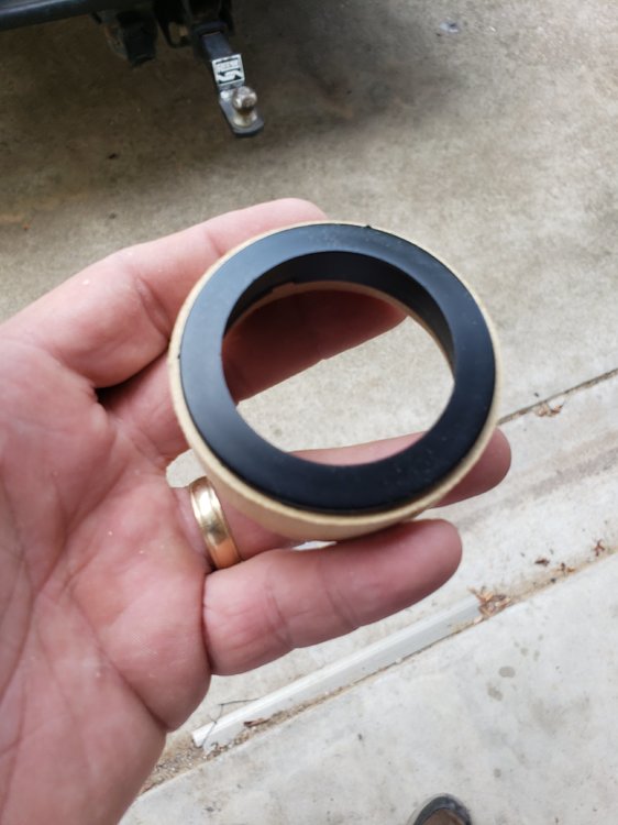

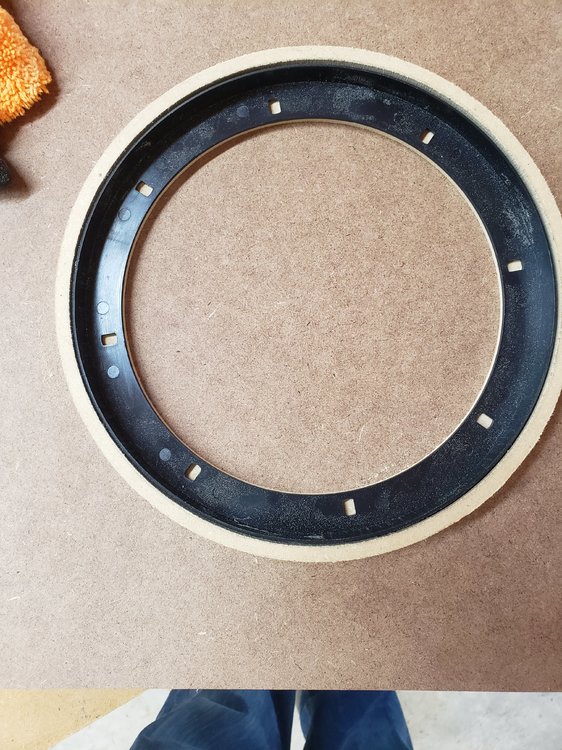

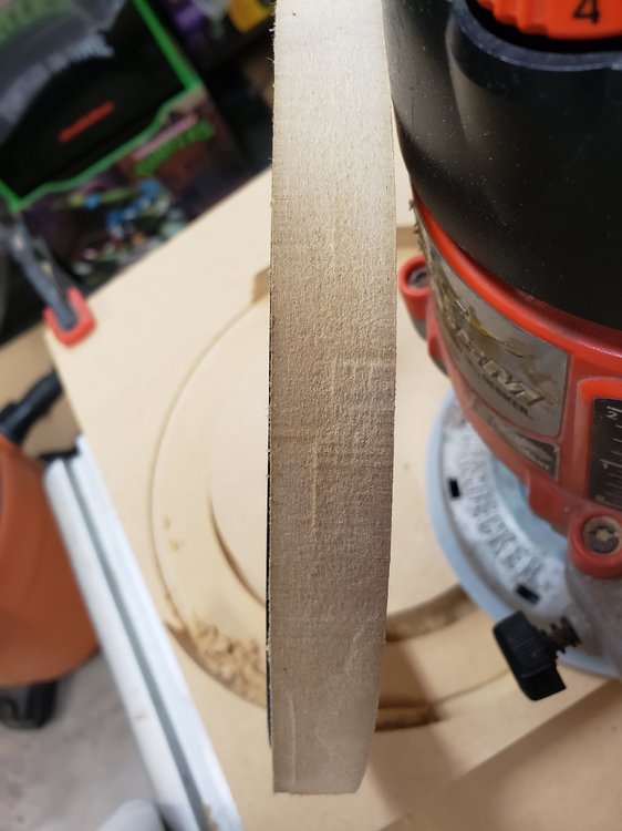

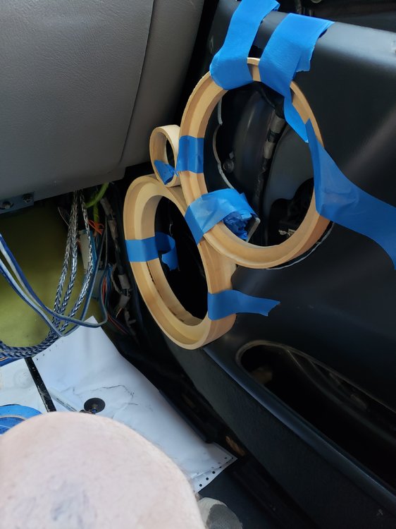

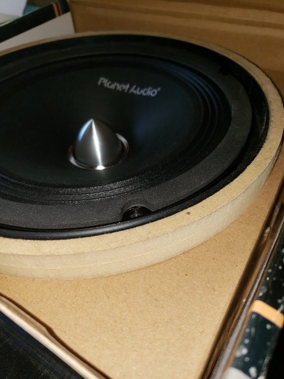

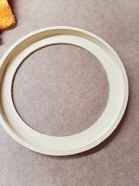

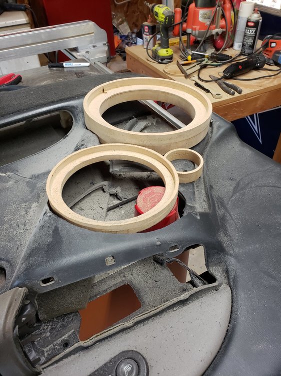

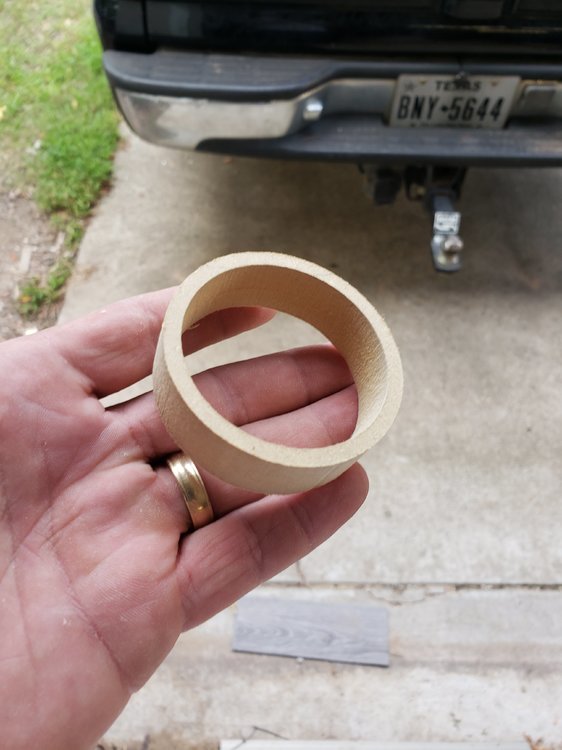

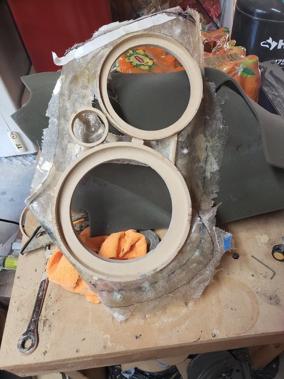

First time making rings. The 8's will have two rings. These for a little countersunk look. The side view has the grill mount in it. So I actually did it right i think lol. Tweets are done. Just have to do the ones for the 6.5's. Then I will get to start mounting and cutting up the doors 😳
