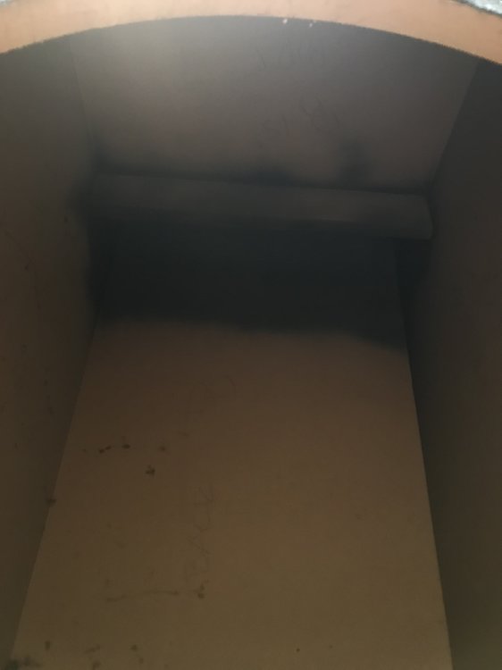

1point21gigawatts Posted September 23, 2020 Report Posted September 23, 2020 Are you sure that the port walls overlap like that or could it be vise versa and the smaller port wall overlaps the bigger port wall instead? And I need to know the width of the port slot. “How can we help you?” “And don’t forget to tell them that the customer isn’t always right.”

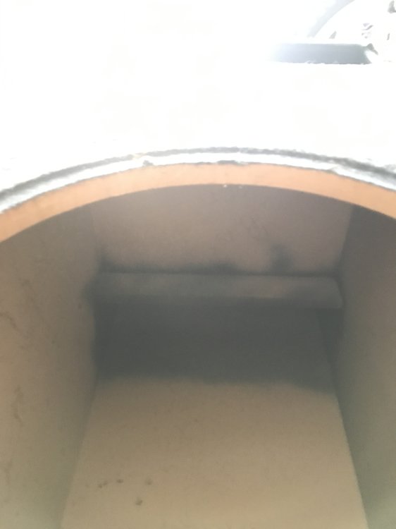

Humbol Posted September 23, 2020 Author Report Posted September 23, 2020 I think so, heres a pic of that piece 89 Toyota P/U Single Cab HU - Kenwood x-396 Front Stage - Kenwood KFC-1094PS Rear Stage - Kenwood KFC - 6984PS Sub - Alpine SWR 823D Amp - Alpine MRP M500
1point21gigawatts Posted September 23, 2020 Report Posted September 23, 2020 Reach in the enclosure and feel the corner and feel how it overlaps to make sure, because I can’t tell when it comes to them pictures. “How can we help you?” “And don’t forget to tell them that the customer isn’t always right.”
1point21gigawatts Posted September 23, 2020 Report Posted September 23, 2020 I just though about it and don’t worry about how the port walls overlap I just need to know is it 3” from the inside corner (green line) or 3” from the outside corner (orange line)? “How can we help you?” “And don’t forget to tell them that the customer isn’t always right.”
1point21gigawatts Posted September 23, 2020 Report Posted September 23, 2020 Backwoods was right. No matter if it’s 3” from the inside corner or outside corner it would be tuned at 41.4hz-41.63hz. “How can we help you?” “And don’t forget to tell them that the customer isn’t always right.”
1point21gigawatts Posted September 23, 2020 Report Posted September 23, 2020 And if it’s 3” to the inside corner then the net volume before subwoofer displacements is 3.68 cubic feet and if it’s 3” to the outside corner then the net volume before subwoofer displacement is 3.73 cubic feet. “How can we help you?” “And don’t forget to tell them that the customer isn’t always right.”
