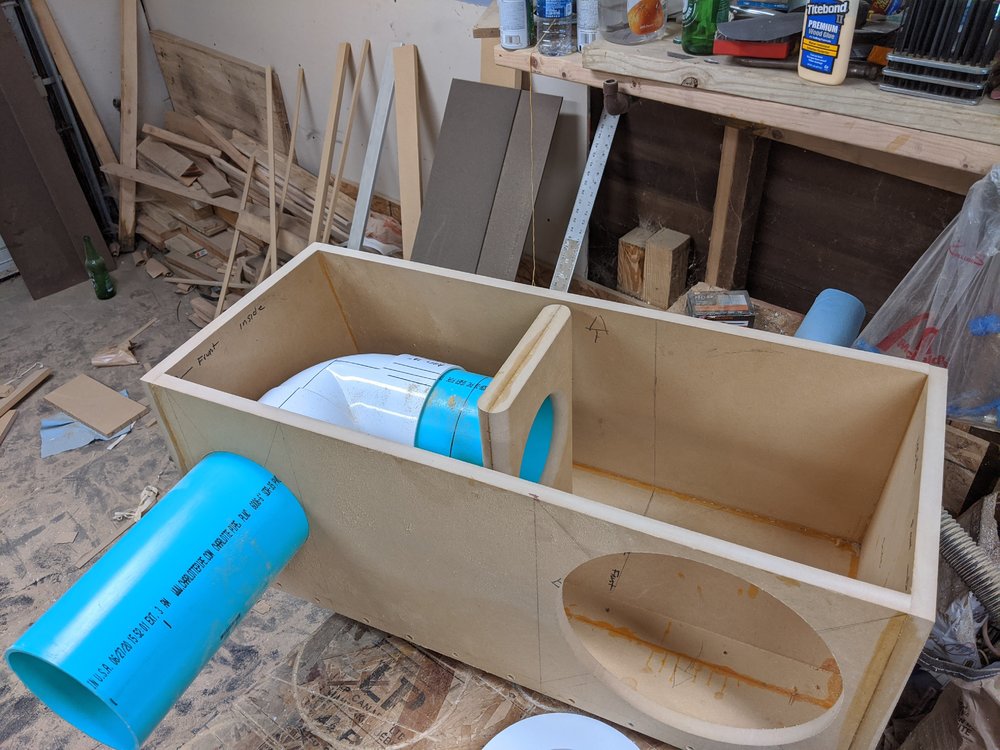

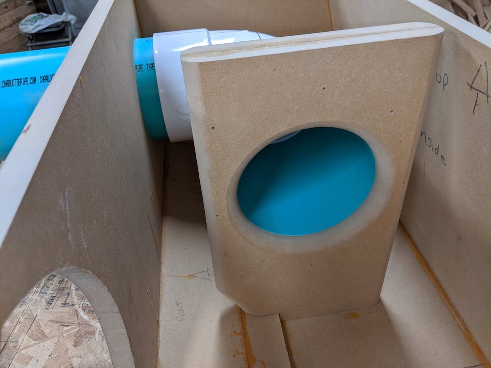

This is the current box before I cut to the port to length. The final port length only sticks out ~7" and has a donut on the end.

If you were to have a more shallow angle on that 45 I would assume it would perform better. Looks to be a tight 45 with a near 90 degree bend at the "armpit" or inner curve. You could try to adapt it with two smaller fittings, say 20-30 degrees instead?
I think the other issue is the port location. They should be furthest from the subwoofer, yours is right up on the basket it seems. I would assume this causes the sub to act as if it is in a smaller box. If you were to straight pipe it you might achieve better results but that also means a Mario tube outside the box...
As much as I wanted to use aero ports they seem quite the beast to fit into a builds without deep boxes. Best of luck man

Yeah its definitely a sharp turn, I have decides that next box I'm just gonna go with a straight port with no bends, bumping up the size will let me get away with a slightly shorter port length.
I never new having the port too close would do that.

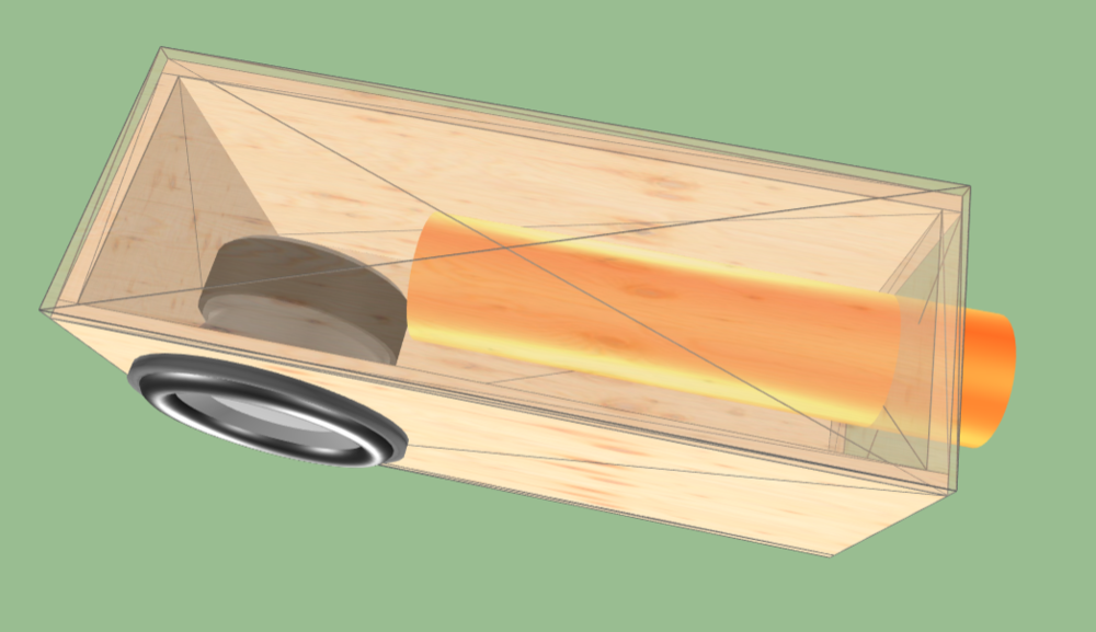

That’s not gonna work out. Let me design you an aero port enclosure you can make with a 6” pvc pipe and some wood that would be ideal for that vehicle and that subwoofer.
How about something like this?
