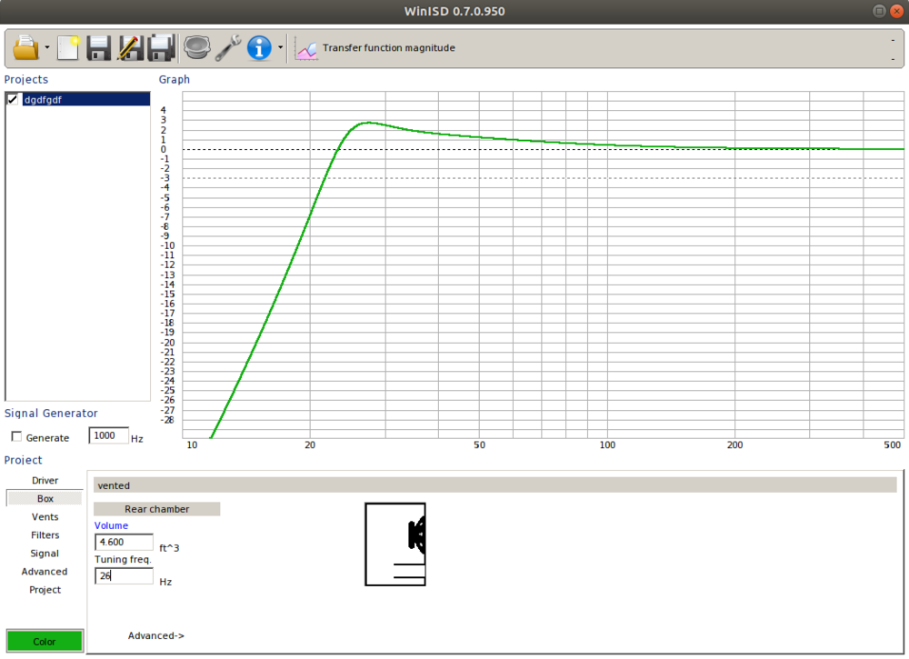

4.6 cu. ft. (before sub displacement) big old big giant big port 12 inch subwoofer box tuned to 26 Hz. WinISD plot of that box with a Power Acoustik GW-124

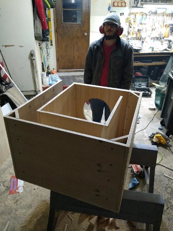

The big stupid 12" box now with actual corners, port width corrected, less retardedness, and more brace.
Actually going to build this one out of some nice oak I just picked up (and made my back sore with) and see how it womps.

It states on the title of this thread, free designs, and now you are charging people money. And when a subwoofer enclosure’s port(s) has more than one bend then it shouldn’t wrap around the subwoofer and line the inner walls of the enclosure. That decreases output a bunch. So let me understand this correctly. A guy who just learned the difference between net volume and gross volume and then thinks it’s ok to wrap a port around the inside of an enclosure is selling enclosure designs on a world renown car audio forum?
