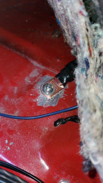

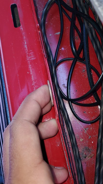

Angel Galvan Posted November 2, 2020 Author Report Posted November 2, 2020 Its like about the width of a quarter where I'm grounded. I feel like Its my ground being too thin.
Angel Galvan Posted November 2, 2020 Author Report Posted November 2, 2020 Update i just grouded to the fram and now its much better. Now when I do start to up the volume more I can see the voltage drop from 14.2 14.3 down to minimum 13. But way better now after I grounded to the frame I'm bumping harder. But this sub has more potential for sure and I can't get the volume higher because u see the clip light flicker on heavy bass notes. Rpms slightly drop.
Dafaseles Posted November 3, 2020 Report Posted November 3, 2020 5 hours ago, Angel Galvan said: Update i just grouded to the fram and now its much better. Now when I do start to up the volume more I can see the voltage drop from 14.2 14.3 down to minimum 13. But way better now after I grounded to the frame I'm bumping harder. But this sub has more potential for sure and I can't get the volume higher because u see the clip light flicker on heavy bass notes. Rpms slightly drop. The truck is working too hard to handle the car electronics and the system would be my guess. What are you using to get this 45 hz test tone you're using to set your gains with? 2011 Chevy Silverado under construction My build log here. Check it out!
