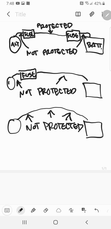

Dafaseles Posted November 24, 2020 Report Posted November 24, 2020 7 minutes ago, Angel Galvan said: Oh okay thanks i was ust thinking of getting 1 fuse holder only 1 fuse holder going to the amp, if you're going to fuse from the alt to the battery, you'll need 2 holders. You'll have current coming from both directions and the chance of that current exceeding the limits of your cable from both directions. Not just one. And fuse as close to the battery and the alternator as you can, protecting as much cable as you can. Usually people don't tend to fuse from the alternator to the battery because it's such a short run and you only really end up protecting a foot or 2 of cable. It is safer though. It's up to you 2011 Chevy Silverado under construction My build log here. Check it out!
