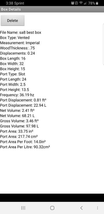

greg4510 Posted October 5, 2020 Report Posted October 5, 2020 Hey guys doing a rather small build but still want it to sound pretty good. I have an 07 Honda accord 4 door. I have 3 sa v2 8s d4 voice coil and a taramps md3k. Looking for box help on what size and tuning they would like to give me pretty good sound. I pretty much wanna face it forward through the back seat. I have 15 h x 32w x up to 20d. Any help would be greatly appreciated
Rpg663 Posted October 12, 2020 Report Posted October 12, 2020 Sundown's own suggestions are pretty reliable. Tune to 35 Hz, about .7 cubes for each subwoofer. Here's the old product page for them, which will help you enter info on something like Sub Box Pro where you can play with measurements and port sizes until everything fits.

greg4510 Posted October 13, 2020 Author Report Posted October 13, 2020 On 10/12/2020 at 3:43 PM, Rpg663 said: Sundown's own suggestions are pretty reliable. Tune to 35 Hz, about .7 cubes for each subwoofer. Here's the old product page for them, which will help you enter info on something like Sub Box Pro where you can play with measurements and port sizes until everything fits. Right now im coming up with 2.45 after speaker and port displacement. 33 sq port tuned to 36hz 14 in per cu ft

Rpg663 Posted October 14, 2020 Report Posted October 14, 2020 18 hours ago, greg4510 said: Right now im coming up with 2.45 after speaker and port displacement. 33 sq port tuned to 36hz 14 in per cu ft Send a link of your box design and I’ll look it over.
greg4510 Posted October 14, 2020 Author Report Posted October 14, 2020 1 hour ago, Rpg663 said: Send a link of your box design and I’ll look it
