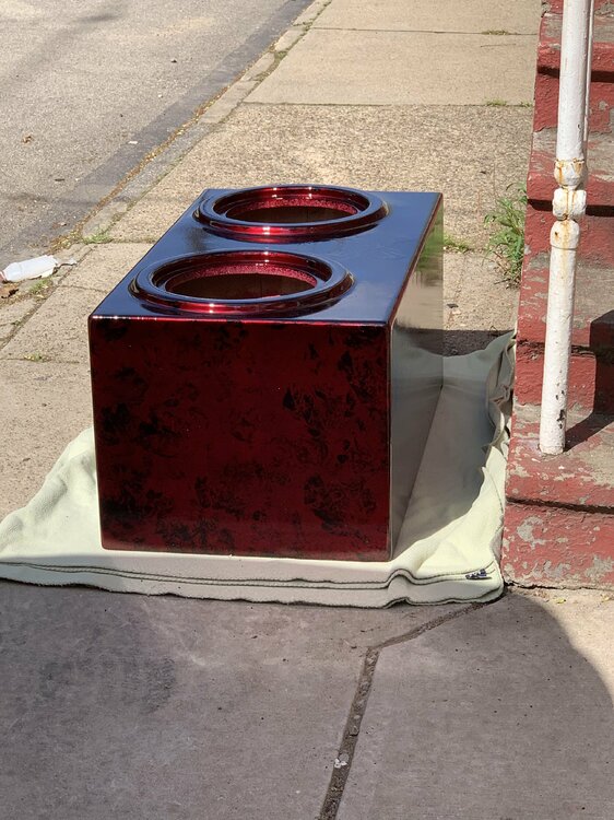

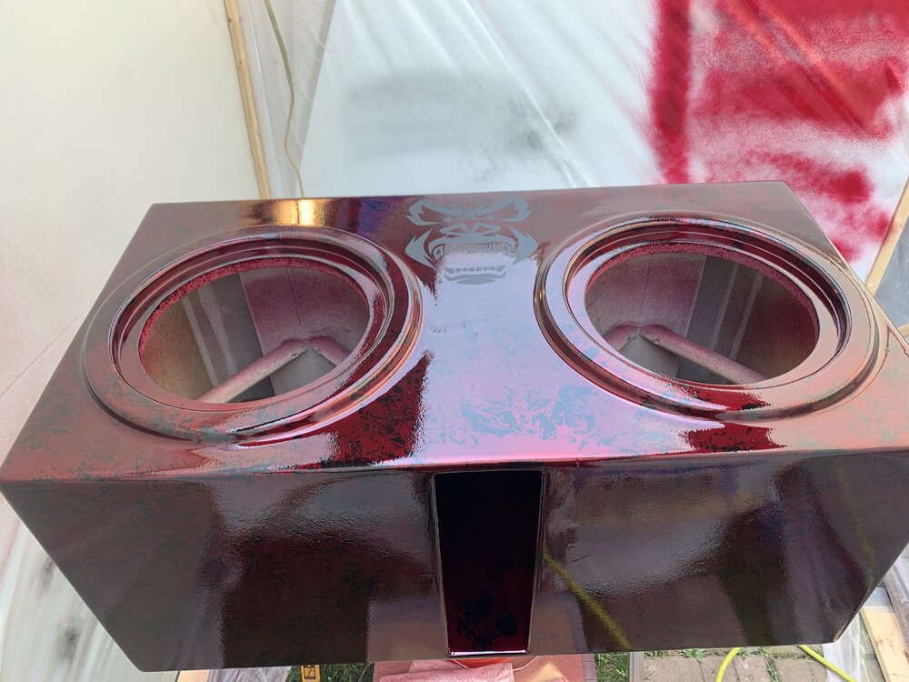

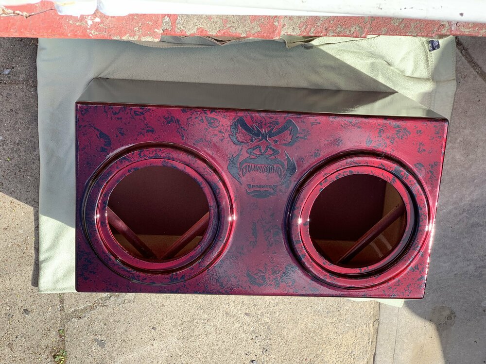

Kinda did a bootleg bowling ball, base coat with metallic silver, spray plastic bag with black paint and blot it, candy wine red over and clear, it’s a motorcycle kit from thecoatingsstore, was cheapest way to go as a kit
