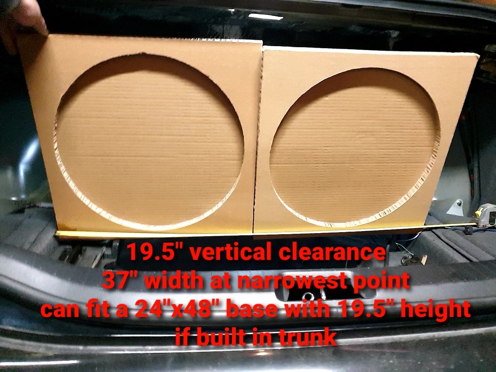

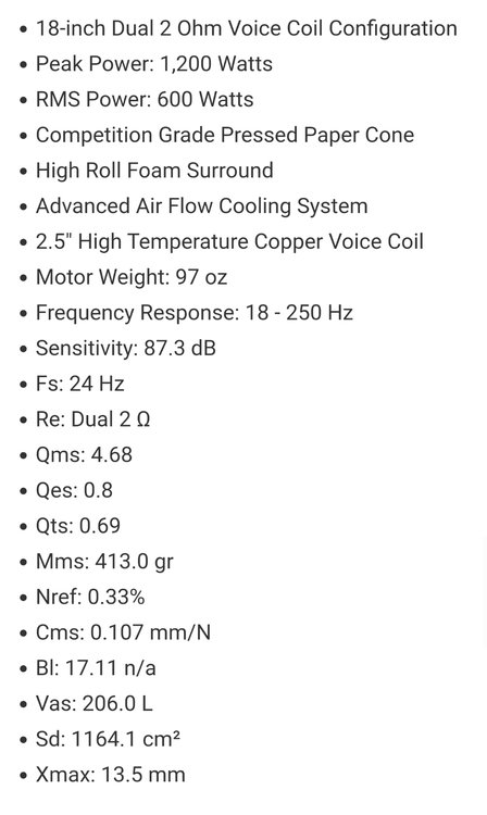

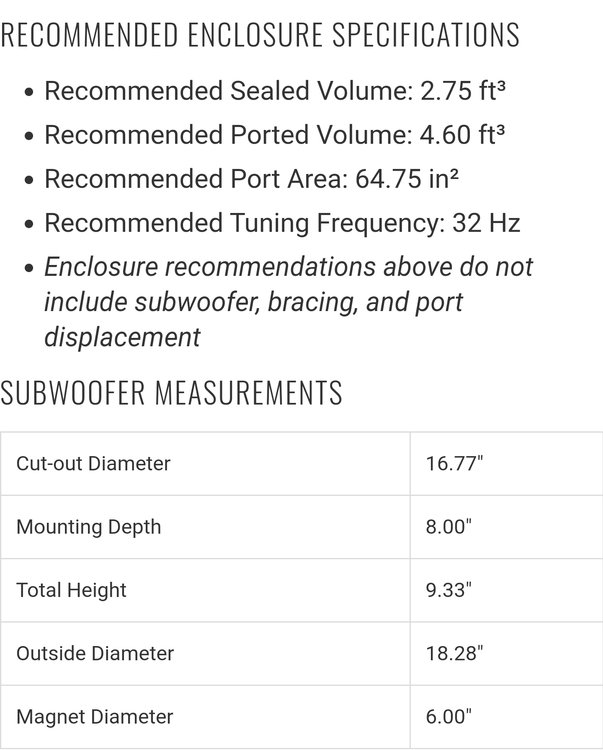

I picked up two brand new Skar SDR18D2's which as far as I can tell are exactly the same motor, 2.5" voice coil, and power handling as the SDR12's that I was running but obviously a much larger cone area. I am unsure of what kind of box I should run these 2 subs in, they are going into the trunk of a Lexus LS430 that is sealed off from the cabin except for the factory subwoofer location where I removed the 8" subwoofer in an attempt to port some of the sound into the cabin. I have a fairly large trunk and should be able to run up to a 10 cu. ft. box if needed. Skar recommends a 2.57 cu. ft. sealed box or a 4.6 cu. ft. ported box tuned at 32hz.... ive played around with WiniSD and SpeakerBoxLite.com trying to come up with the best box design and am hoping somebody can chime in and help me out with some specs, or info that might help.

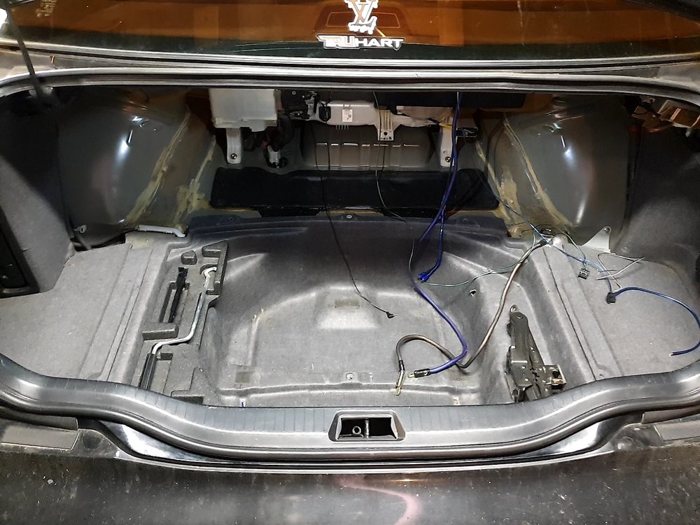

Ive attached some pics of the trunk and just some cardboard visual aids that kind of show a couple of different mounting options but are no way my limiting factors, I am open to anything, I want the loudest bass possible from these, I want them to at least be an upgrade from the SDR12D2's I had in a prefab box lol. I have several sheets of 3/4 x 24" x 48" MDF and 1/2" x 24" x 48" MDF for bracing, corners, port etc....

I ended up utilizing my spare tire well since I wouldnt have access to a spare tire with a box this large anyways, and I was able to build some of the enclosure underneath the rear deck so I could run a port straight up into the cabin. My first box design was a 4th order, I honestly dont remember the specs of it right now but I wasnt impressed and tore it down and restarted again building just one large 12.3^3 ft enclosure that consumed my whole trunk. I then upgraded my amp and wiring from the Kenwood 2000w monoblock amp to a Taramps 3000 watt amp, this setup has much more bass than anything I have previously had in this car but nowhere near what it should have.

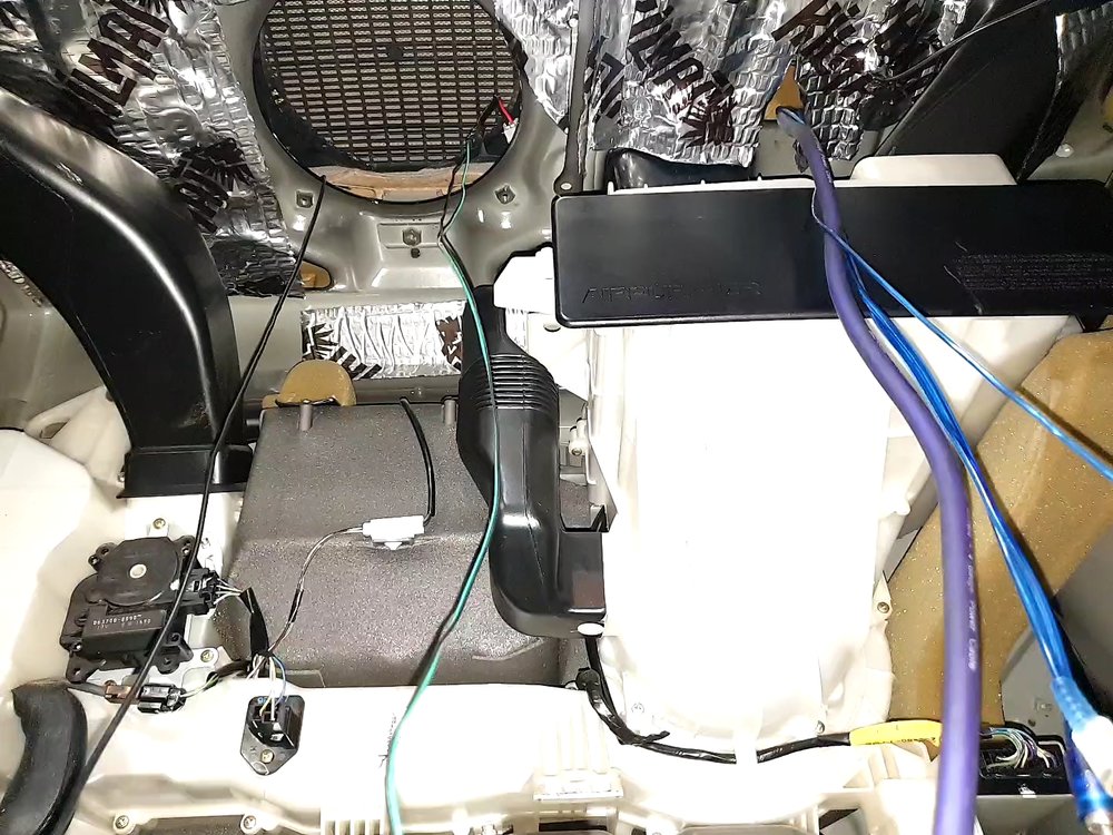

Is the issue simply not being able to get enough of the sound into the cabin? I only have a single 8" diameter hole in the rear deck to allow the port through, would it be better to port into the trunk and just let everything from the trunk come through that 8" subwoofer location or should I continue to port through it as I am?
I just got done with a friend that built a single box for his Skar EVL12 in a GMC suv and it is MUCH MUCH louder than my EVL18 setup. I ordered another EVL18, bought an air nibbler and am ready to cut the rear deck through, I dont use the rear air purifier that often, and I dont use the rear AC ever, unless I have something in the rear fridge so I am going to remove the rear AC and air purifier, cut the fridge open so it has access to the trunk and allow as much sound through as possible.
Here are some misc pics to cover some of what I mentioned.
