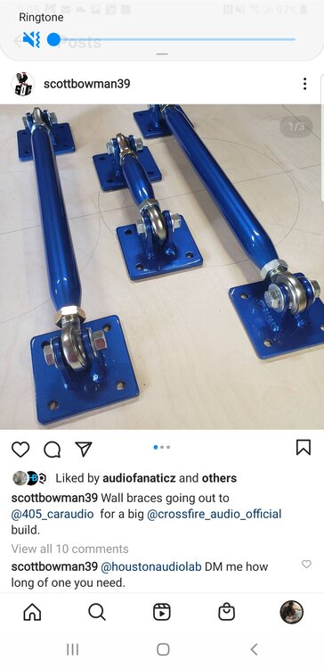

1point21gigawatts Posted December 17, 2020 Report Posted December 17, 2020 Mdf would work too. For sure. But you would have to brace it to achieve optimal output. Since mdf is more flexible, bracing is needed more now. Contact that guy and ask him about bracing. Then go on YouTube and look at 6th order enclosures and you’ll see that they are braced. So make sure that guy factors in bracing. “How can we help you?” “And don’t forget to tell them that the customer isn’t always right.”
Dafaseles Posted December 17, 2020 Author Report Posted December 17, 2020 2 hours ago, 1point21gigawatts said: Mdf would work too. For sure. But you would have to brace it to achieve optimal output. Since mdf is more flexible, bracing is needed more now. Contact that guy and ask him about bracing. Then go on YouTube and look at 6th order enclosures and you’ll see that they are braced. So make sure that guy factors in bracing. These are dope! 2011 Chevy Silverado under construction My build log here. Check it out!
