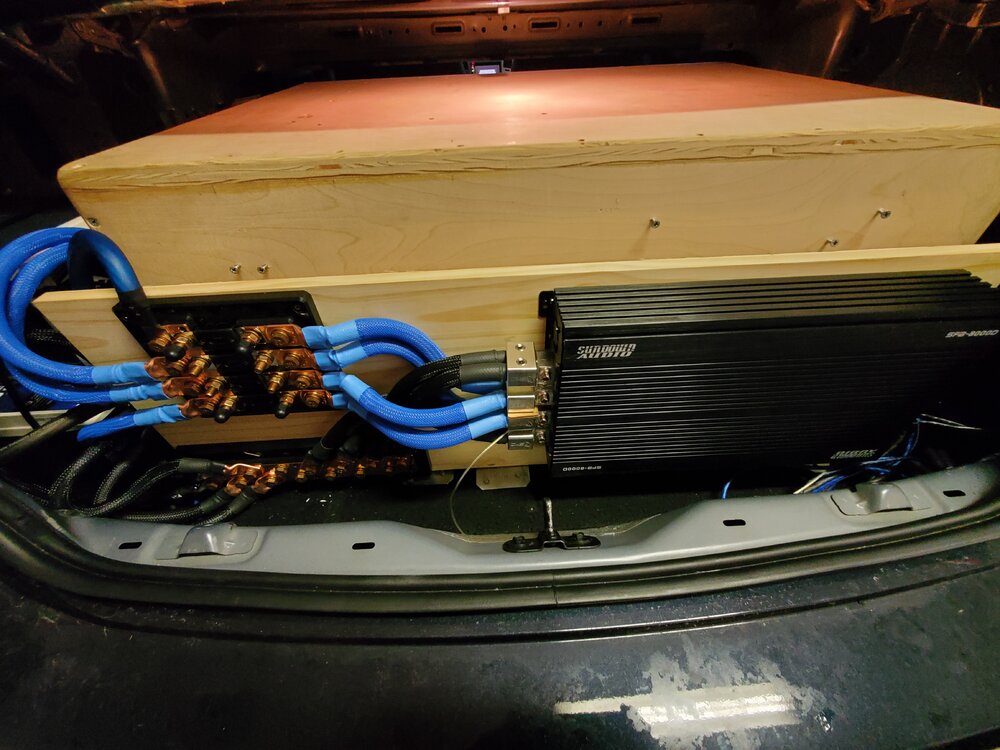

Finally got around to installing the fancy SMD distribution blocks. Some more TechFlex installed with Skyhigh cable, lugs, ferrules, heat shrink. Did not get around to the second run of 1/0 front to back. The Ground from engine/alternator to chassis and battery negative. I have not tested with any burps but only heavy sin wave Rusticalls/DJSNT tracks get voltage below 13. I think I am running into thermal limits of voice coil before voltage/power limitations on music, at least with engine running.  Plays at volume 27 all day, starts to stink at 28 after so many songs.
There were a few other quirks this round....1) Skyhigh heat shrink is not adhesive lined and very thin. 2) SMD XL2 fuse holder barely fit the hilariously oversized Skyhigh 1/0 lugs.  3) Wire ferrules combined with overzied 1/0 added enough thickness that the set screws for the two 12v dual inputs were making a connection. I imagine it would be fine if they were touching BUT I do not want extra stress on the terminals or wasted energy from sparking across the gap. I torqued them down best I could and split the gap with a piece of cardboard. 4) SMD full distribution block, the locations on the ends are just a bit to close to the stand-offs for the plexiglass cover If you run the very oversized Skyhigh lugs. They cannot go on perpendicular and those are only 1/0.
Next up, Clamp power. Second run 1/0 front to back. Add some 1/0 to rear bank. Clamp power again after to look for difference? Build new box for two 12's to replace the one 15. Batteries or Second alternator...still undecided. Weather is starting to warm up so that should give me motivation to do some more work. 👍
