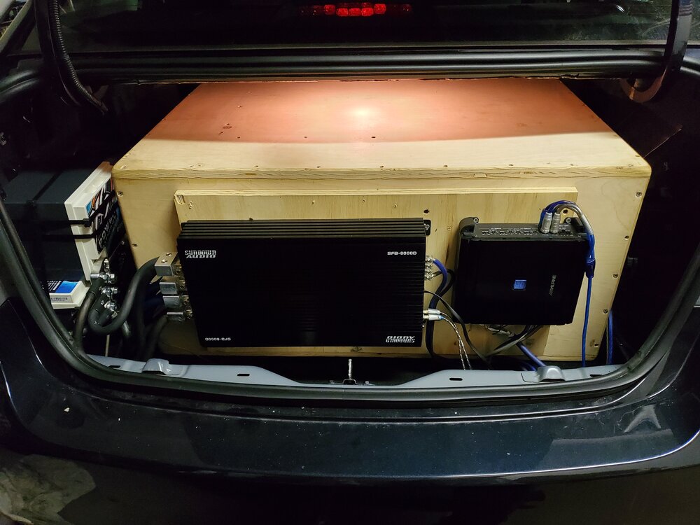

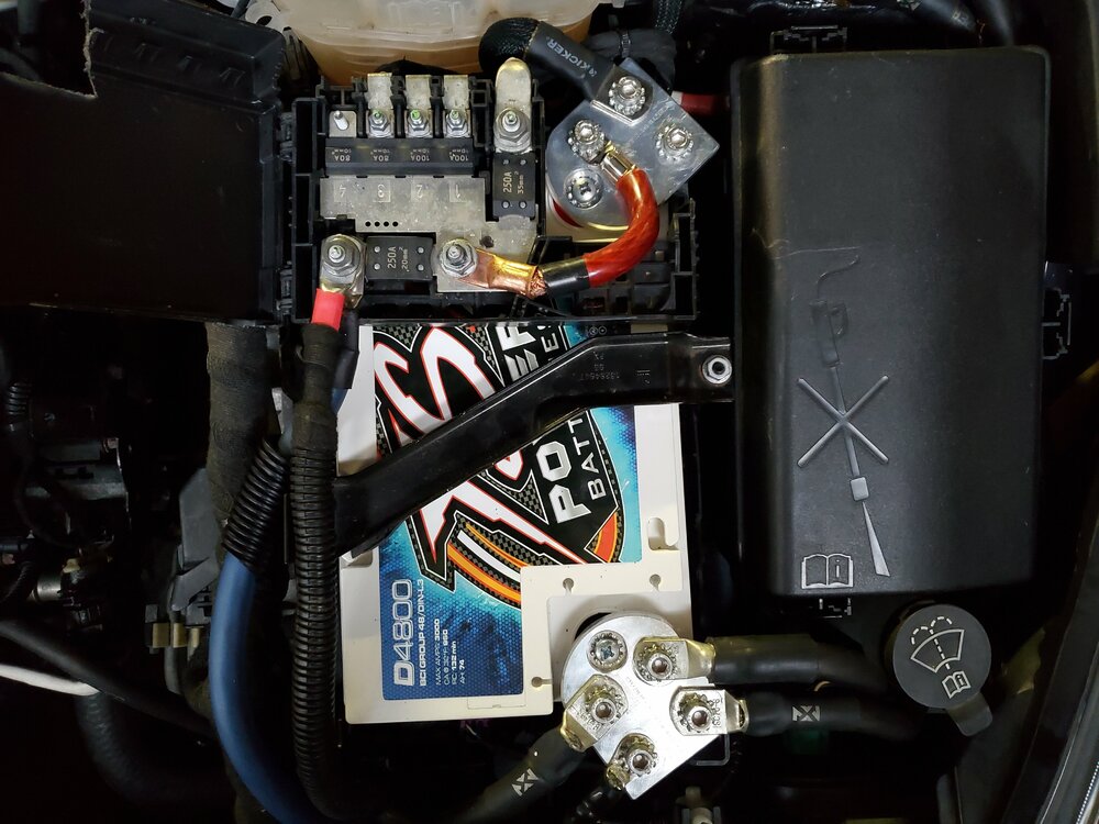

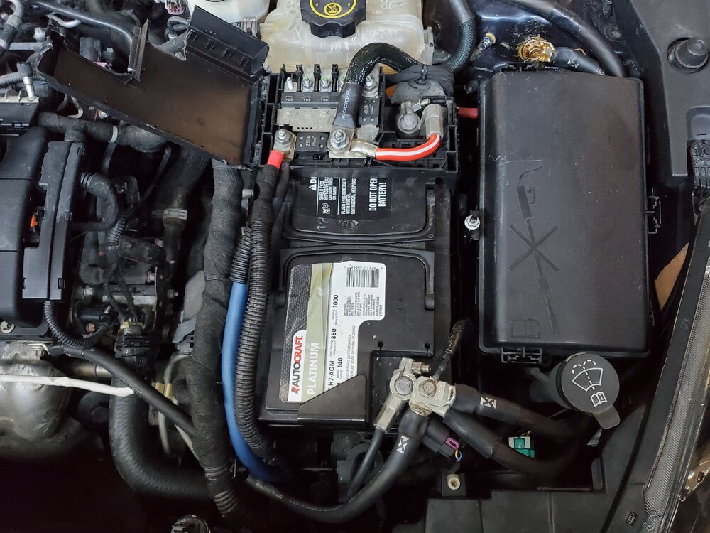

liteblue Posted January 6, 2021 Report Posted January 6, 2021 Starting some upgrades to my current system. Daily driver 2014 cruze. I did Door speakers when i first got it, Alpine Type-s Coax 6.5. Kept the stock tweeters on the dash. Alpine MRV f300 powering the doors, 50 x 4. I have had a few different subs in the vehicle. One 12, then two 15s. Now one 15 and planning on two 12's. Bunch of amplifiers and now i have an SFB 8000 from Sundown Before upgrades i had an Autocraft AGM (Advanced auto parts brand) and one D1200 from xs power. Not enough for 800 watts. Upgraded the alternator to 200 Amp singer (largest plug and play alt i could find). Swapped the Autocraft for XS d4800 and added a second D1200 to the rear. Saving up some money for a third d1200 or perhaps a Supercap? any input would be appreciated. and saving for some more 1/0 copper.

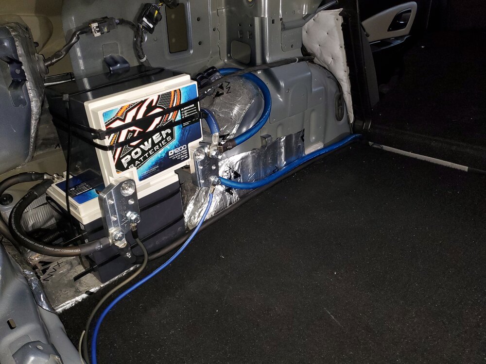

liteblue Posted January 12, 2021 Author Report Posted January 12, 2021 yes kyblack, not close... yet. Ran into my first issue. Back two batteries are reading a lower voltage than the front battery when the car is running. On vehicle start up both front and rear read the same voltage. Rise up to about 15v, then drop down to 14.3/4 after a few seconds. But after playing some bass the rear bank dips and never really goes back up. Thankfully it has occurred while testing and never let it dip below 12.4. Even when the rear batteries read 12 volt the front is still reading 14.3/4. Voltage stops dropping when i stop playing music and Does not go back up until i restart the car.
Dafaseles Posted January 12, 2021 Report Posted January 12, 2021 23 minutes ago, liteblue said: yes kyblack, not close... yet. Ran into my first issue. Back two batteries are reading a lower voltage than the front battery when the car is running. On vehicle start up both front and rear read the same voltage. Rise up to about 15v, then drop down to 14.3/4 after a few seconds. But after playing some bass the rear bank dips and never really goes back up. Thankfully it has occurred while testing and never let it dip below 12.4. Even when the rear batteries read 12 volt the front is still reading 14.3/4. Voltage stops dropping when i stop playing music and Does not go back up until i restart the car. Did you check if your car has a battery management system out something along those lines? You might have mentioned that prior. If so, sorry about that 2011 Chevy Silverado under construction My build log here. Check it out!
liteblue Posted January 12, 2021 Author Report Posted January 12, 2021 One run of 1/0 gauge for +12v and Ground. and a 1/0 gauge chassis ground. no kind of management from the terminals of the front battery to the rear batteries.
1point21gigawatts Posted January 14, 2021 Report Posted January 14, 2021 I got mad before on that old post you commented on and wasn’t accurate on. But that isn’t a big deal and it happens. Just because I don’t like a comment doesn’t mean I don’t like that person and doesn’t stop me from helping that person. Sfb’s are current hungry amps. You either need to switch to lithium or get a bigger alternator and a tad more agm. There are companies that would make you an alternator. You have to email JS alternators or message brand x on Facebook. No worries. They are both good and trusted companies. What type of subwoofer are you using? “How can we help you?” “And don’t forget to tell them that the customer isn’t always right.”
