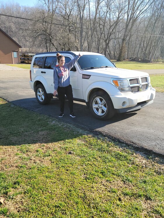

So we got our baby basshead a 2007 nitro. She wants to compete and possibly hairtrick but I'm not wanting to spend a ton on her first system. I'm running crossfire in my durango and am about to post my build in the build log. I'd like it all to match but I don't think I'm going to stay under budget doing that. On my radar are 2-15" Crossfire c7s, resilient sounds platinums, skar vxf(I like the price tag) and sundown x's. Anything else I should throw in the mix? Amp wise it's probably gonna be either the sundown sfb 5k or 8k or the deaf bonce aab4900 or 7900. I don't like the taramps 4ch and I think Korean is out of our budget. Any other amps I should look at?

Local shop can't beef up the stock one so I have to look into one. He recommended Ohio Generator but they were one of the most expensive for my durango. As far as battery power I have to figure out how much room I'll have with the enclosure. Keeping the second row seats so she can haul her brothers around so space may be an issue. And alot of guys here in Ohio are running the platinums. They do well but I haven't heard them in one not setup for pure spl. They are all windy and loud tho.
