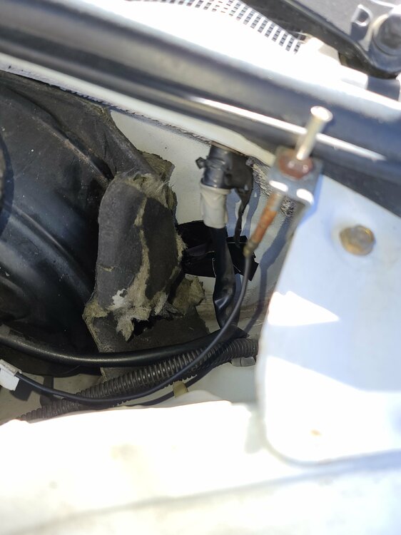

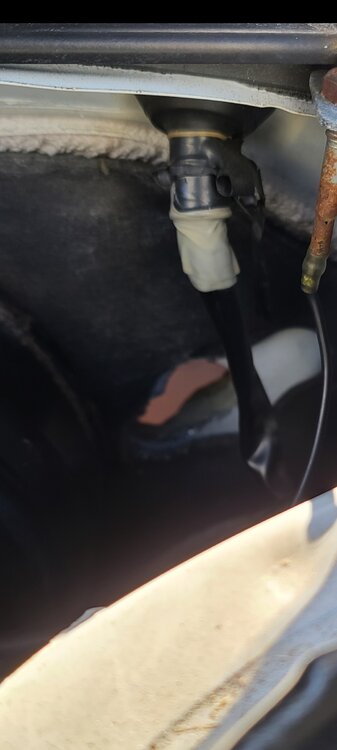

This is what it looks like. It was 2 holes..a larger and a smaller that have become 1 hole. I'm thinking put the Gorilla tape around the hole edges and around the wires itself, then use silicone to seal it. It won't be pretty,but.. Thanks for the reply.

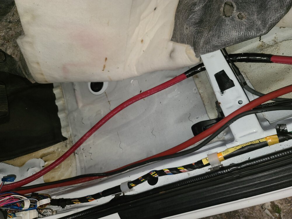

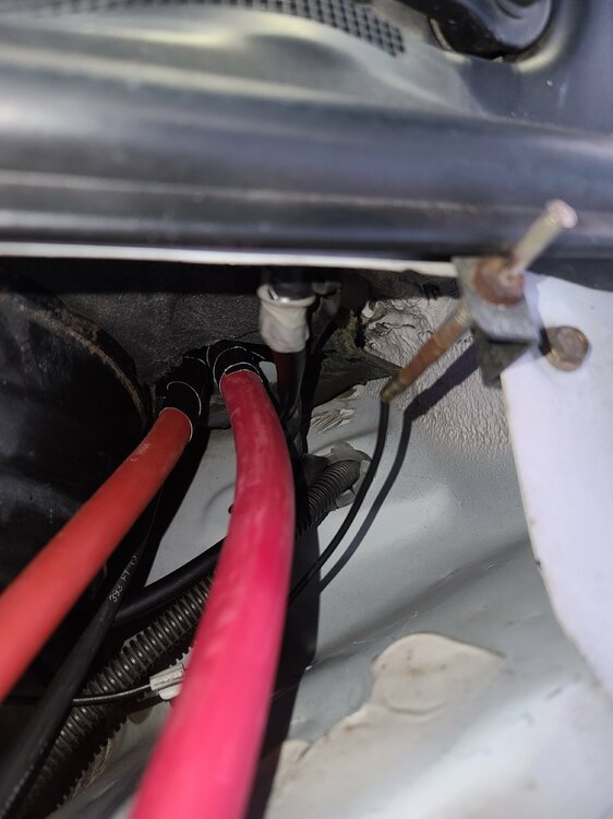

Here's what I did. Gorilla taped the firewall hole. You can't see it very well.

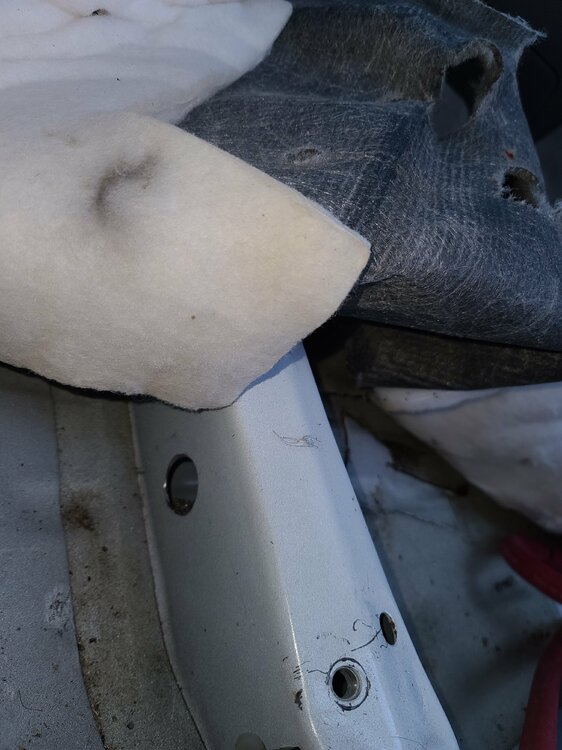

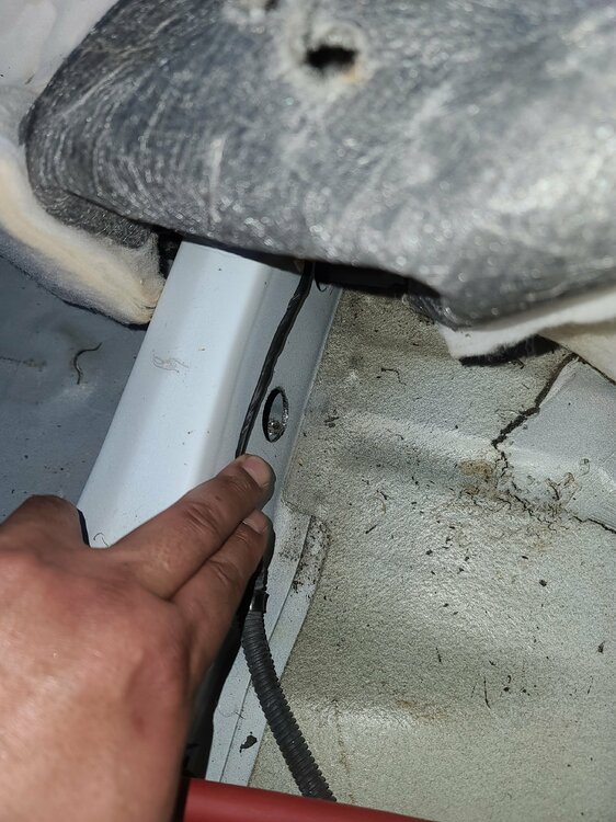

Had to drill this out under my seat to run the 4/0.

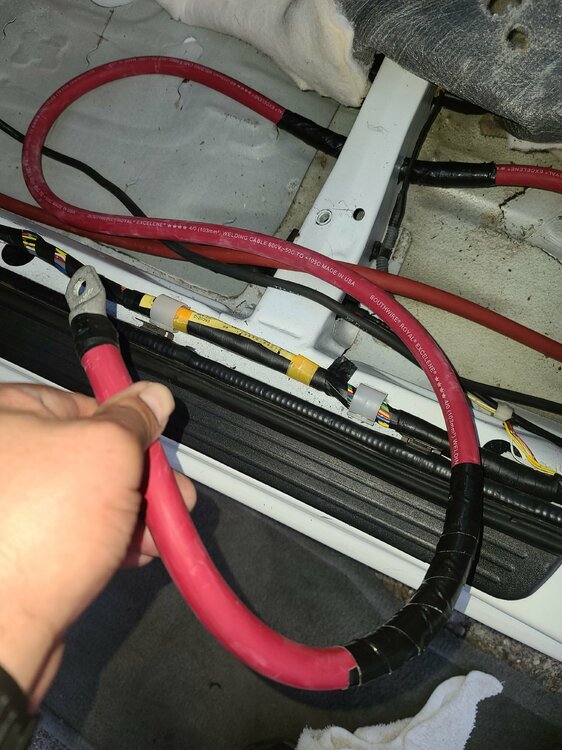

Wrapped the 4/0 in Gorilla tape where it will pass thru under the seat and thru the firewall.
The 2/0 and 4 gauge can squeeze along the running board area.

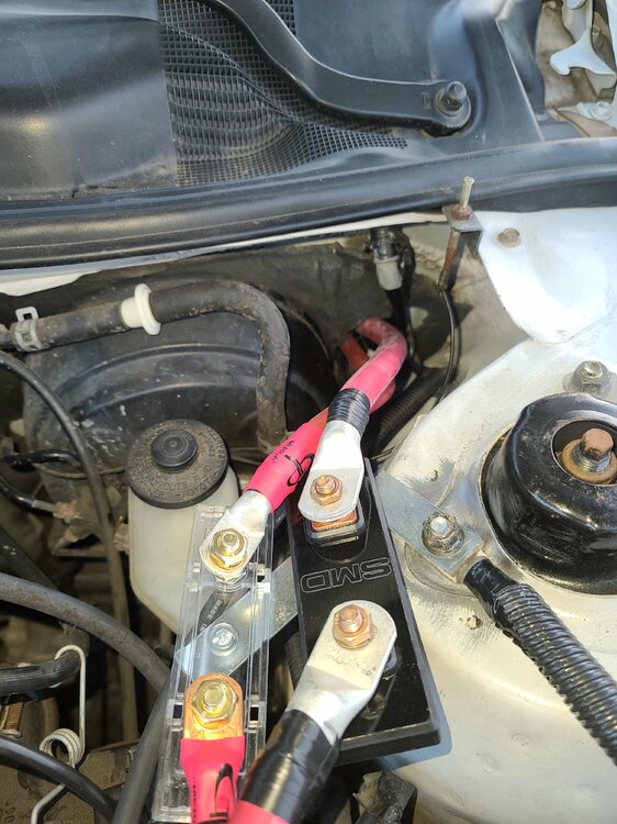

Just wanted to show my SMD fuse holder(got the distribution block also) and my big 3..small stuff to yall big dawgs.😊 I think the Gorilla tape will fare well. Btw, where do you add your signature as far as car and system..I can't find it.
