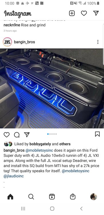

I'm going to say if the website it's offering the Image Dynamics subs, go with those. I'm guessing that box is made with those specific subs in mind and 3 will get you loud enough for the space you have.
I might add.... that's a funky looking box. Not being familiar with that truck, why does it have 3 tiers? It looks like the top of a castle wall..... anyway...... if building your own box is too much of a hassle for you (it's actually easier than you might think), bass is bass.
The box is made like that to fit the rear power motor and the center seat belt.  Going behind the seats in a 2011 f250 crew cab.  Wont even know the box is in there.  Im parting ways with my soundqubed hdc3 15 which is taking up my entire back seat and would like to have them back.  Ive built all my past boxes but this one is very specific to how it fits in there and just dont have the expertise to do that.  Ive just followed blueprint cut sheets before.
That's the thing about prefab boxes, they'll fit. Have you looked into under the seat boxes? I've seen 4 10's sealed under the seat before in those big fords
Well then yeah, if that's your only option, you gotta make do with what you got.
Ported enclosures "get louder", but sealed enclosures get low! I guess it depends on the music toy listen to. But my own personal opinion, if I was in your situation, I'd go 3 10's sealed assuming the power would be the same (1 10" 300 watt rms ported against 3 10" 300 watt rms subs sealed equaling 900 watts total)
