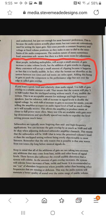

Dafaseles Posted March 23, 2021 Report Posted March 23, 2021 7 minutes ago, Anthony10111 said: Okay I'll do that but can you help me better understand the different db levels ? (0db, -5db, -10db) for subs and for highs Maybe this will help 2011 Chevy Silverado under construction My build log here. Check it out!
Anthony10111 Posted March 23, 2021 Author Report Posted March 23, 2021 2 hours ago, Dafaseles said: Maybe this will help Do you agree with using -10db for setting subs gain? No offense to the one who said it I'm just trying to get more than 1 opinion I'm learning lol
Dafaseles Posted March 23, 2021 Report Posted March 23, 2021 Usually, with big subwoofers and big voice coils, you can get away with -10db easy. The little bit of excess heat generated, the subwoofer can deal with that. Put it this way @1point21gigawattshas taught me most of those information I'm giving you in the first place. You can trust him. Dude knows his shit👍 2011 Chevy Silverado under construction My build log here. Check it out!
