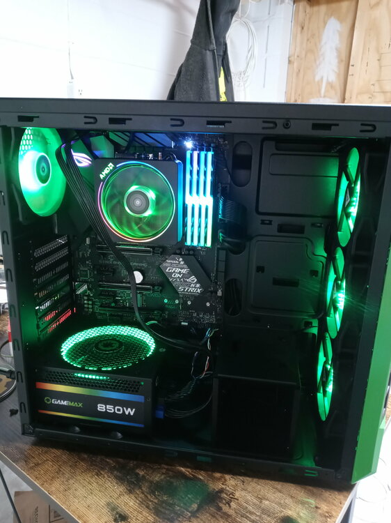

Hello everyone long time no see i just recently started my own pc build and for some reason i cant get any output from the HDMI output of the motherboard i dont have a GPU yet and yes it will power on and everything lights up ill attach a photo to show that, but i was wondering if anyone could help me on this forum
heres a list of what is in my tower
Motherboard - ROG STRIX B450-F
Power supply - Gamemax 850w
Ram - (4) TridentZ DDR4
SSD - Gold P31 M.2 1TB
Processor - Ryzen 7 3rd Gen
If anyone can help that would be amazing thanks everyone

Might be a video driver thats not up to date. Or it may be a bios update. Check the support section for your mother board and check to make sure you have all the latest drivers and bios.
Ryzen 7 3700x/3800x does not have integrated graphics. That hdmi port on the motherboard is only for processors with the g suffix. Examples ryzen 3 3200g and ryzen 5 3400g
You will have to buy a gpu, or amd processor with an apu until gpu are available.
