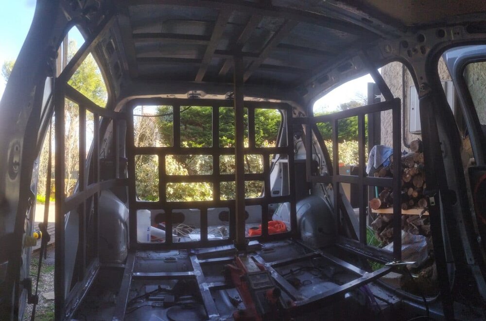

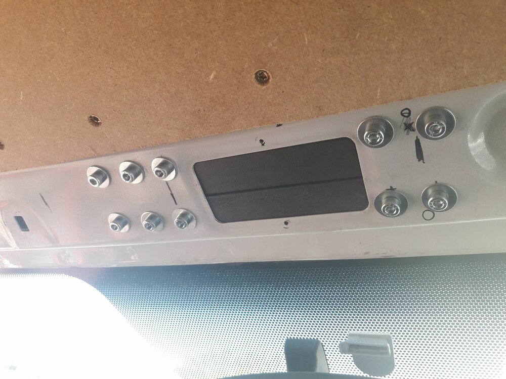

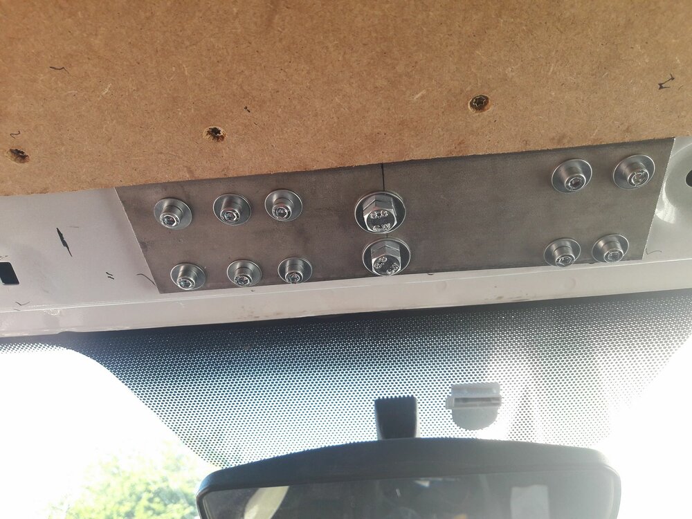

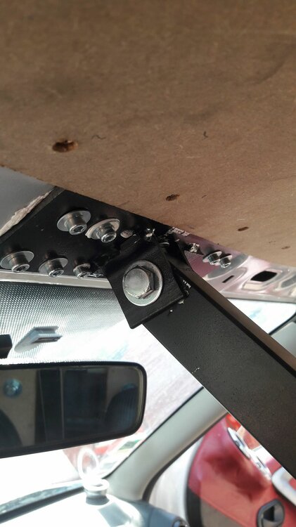

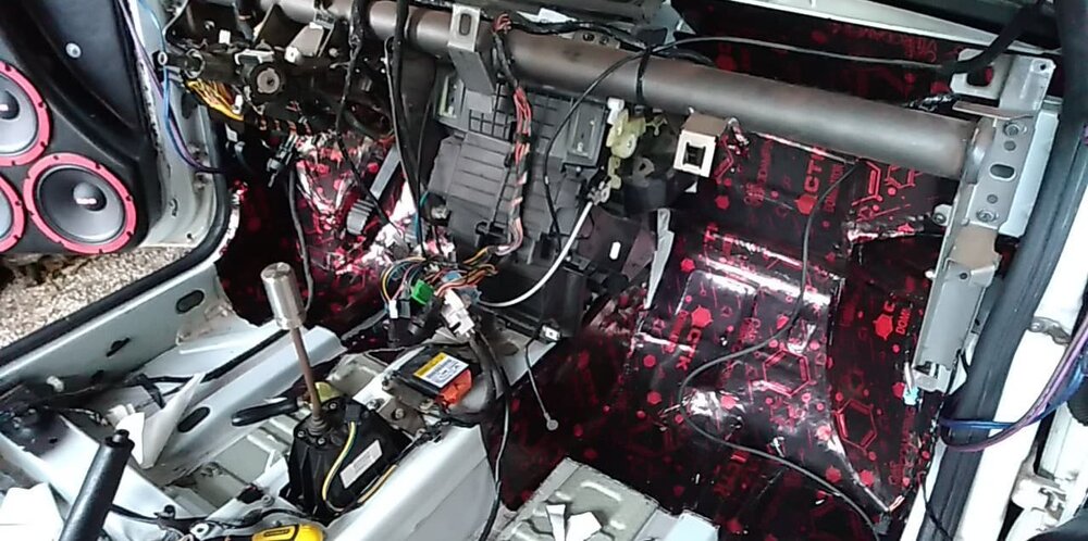

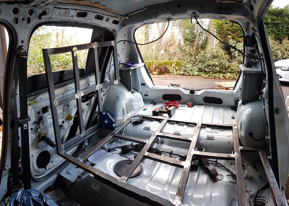

I've done a bit of bracing above the winshield during the preview build, simple as 3 pieces of metal bolt together, and a pole attached to it.

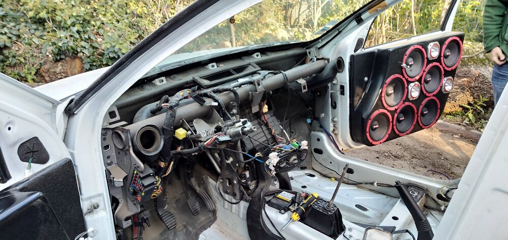

I also removed the dashboard, to put deadener on the firewall.
I put wood on the floor too, but I forgot to take pictures of that, and poored some kind of expanding foam which has resin inside, so it's pretty strong.

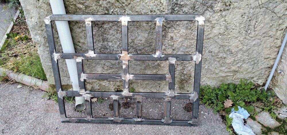

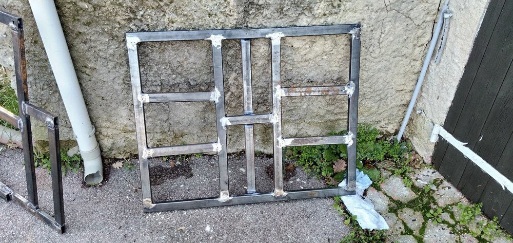

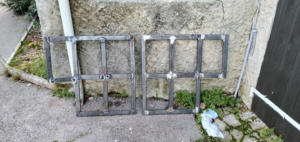

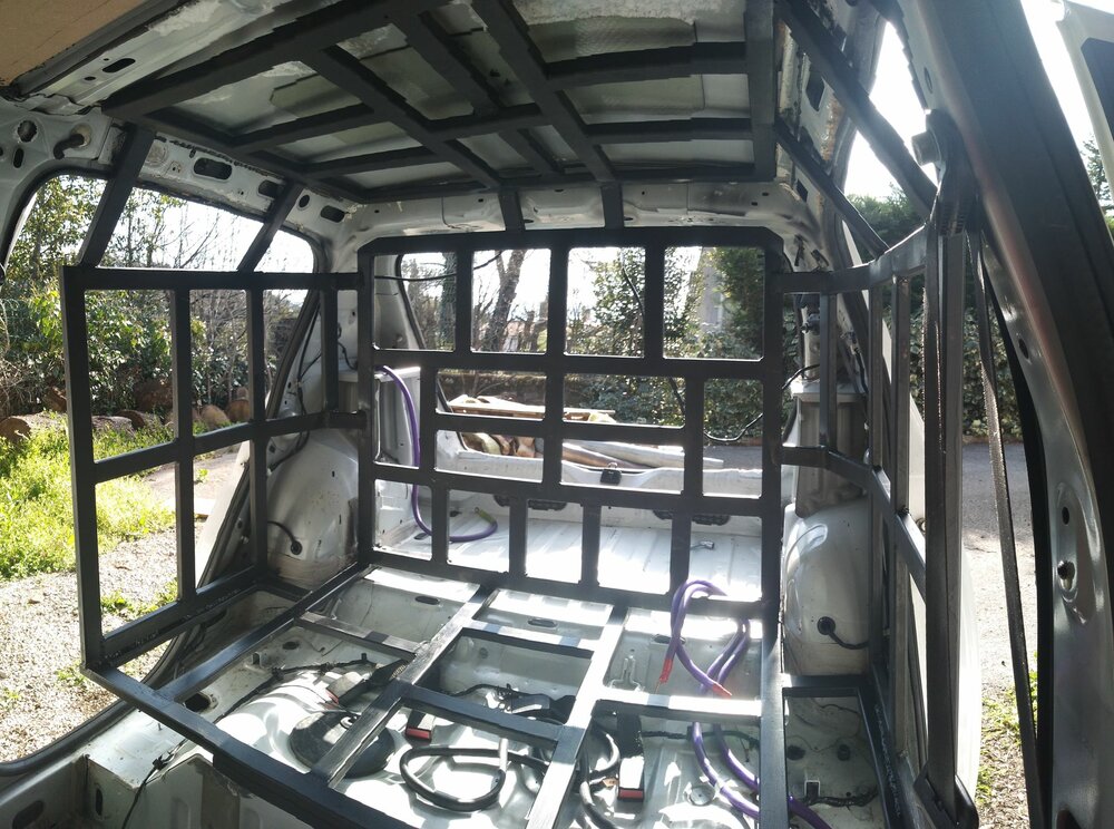

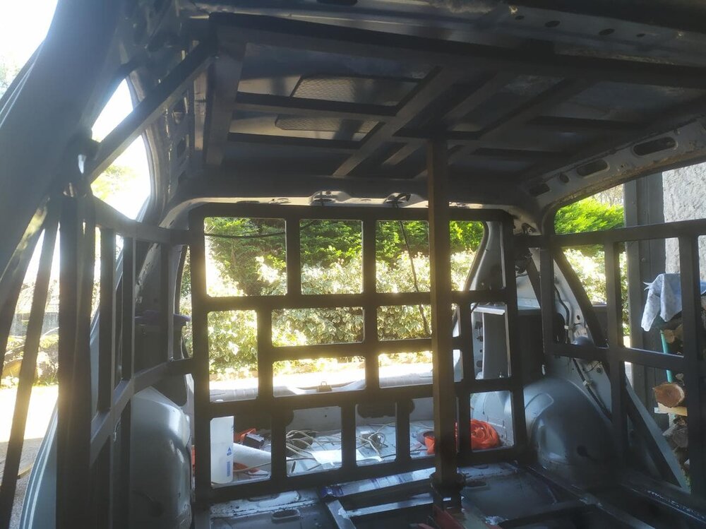

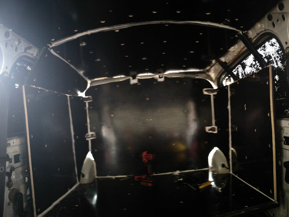

Ending with the steel for the box, I finished the floor piece, made the sides, top, rear, tested more fitting, and done.
Floor
79842824_1006258506401326_1836260546681241600_n.thumb.jpg.75571e2c02f91e5b8581f411f32241c1.jpg
Sides
81742808_847086452390421_9011435372395102208_n.thumb.jpg.05e6dfe07533951c2902f8f5d64cc23b.jpg
Top
2059609296_81325227_794341764414684_7060546881637580800_n(1).thumb.jpg.d5e1883fd886dfb21c0889a6450f359e.jpg
Rear
81037738_2629375737111926_7086787138951315456_n.thumb.jpg.eab1ecaeb058533ba47eb20e9c6b1791.jpg

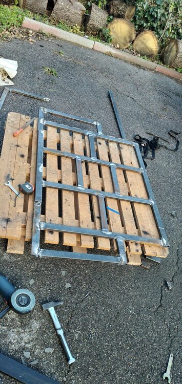

Soldering the first side to the bottom
81006877_446679162671353_5440077998852145152_n.thumb.jpg.878632032d828f750f601ab4e558205a.jpg
Soldering the rest of the box
89436104_653894825441168_6470148754300207104_n.thumb.jpg.7a6bf7bd6b5b8ce5bf19582623412ae5.jpg86610545_476521073042028_7388170457310035968_n.thumb.jpg.77adcbeccbd1072829f28aea57144561.jpg86475804_626746671483455_79315483177779200_n.thumb.jpg.309cc313e0f4c488bf1b99f5435e09b4.jpg

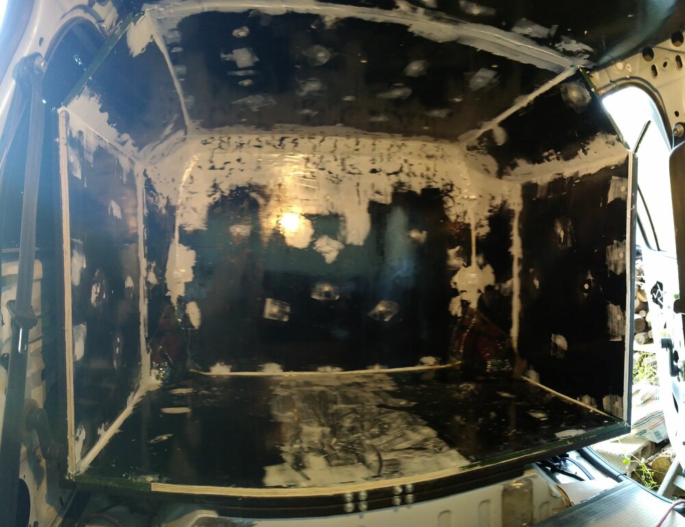

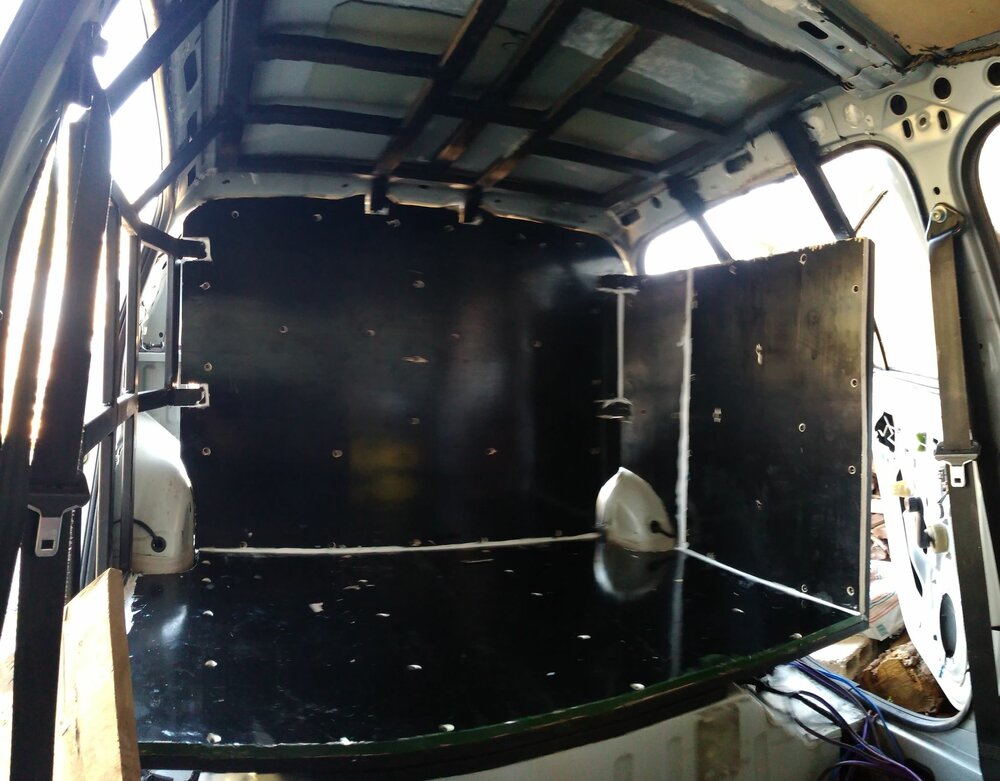

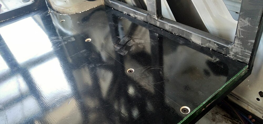

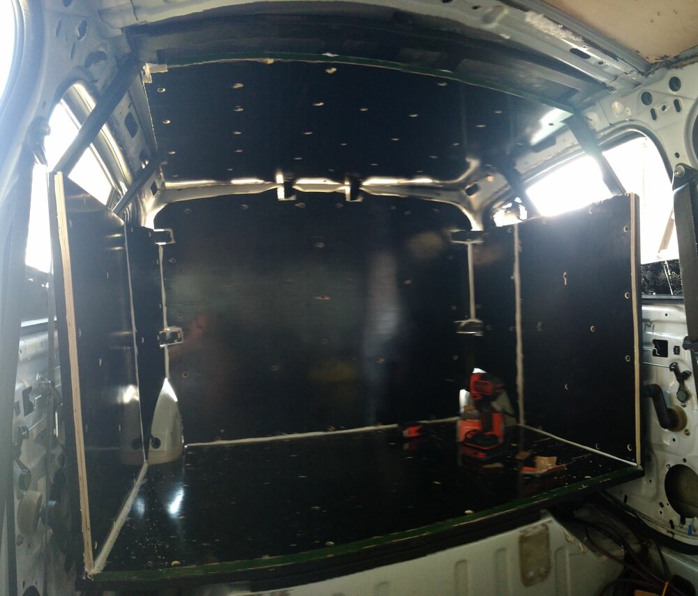

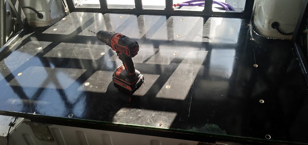

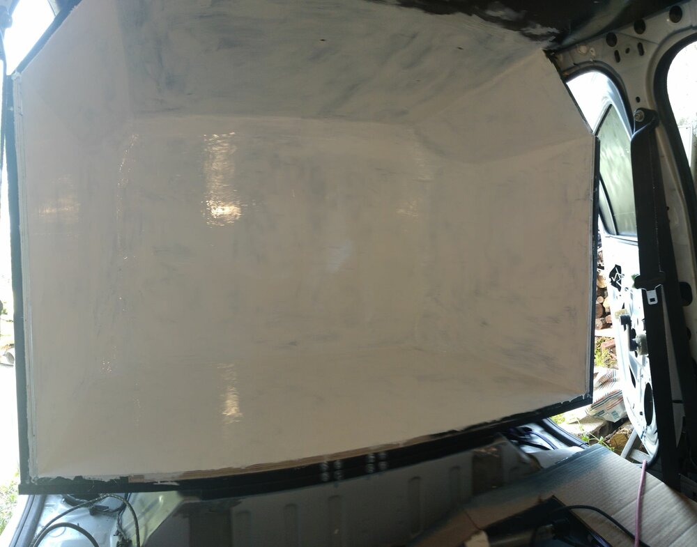

Time for the wood, began with the bottom, I choose to bolt the wood to the steel cage,
I had to drill and mill the wood it at the righ points, drill and tap the steel, glue, bolt....
It took some time but I'm pretty satisfied with the results.
Also used some carpet, resin and fiber to fill the empty spaces in the angles (top of the box against the rear panel + wheels).
After that, I filled all the holed, and have made a first coat of painting to soft the inside of the box.
It was finally looking good !
