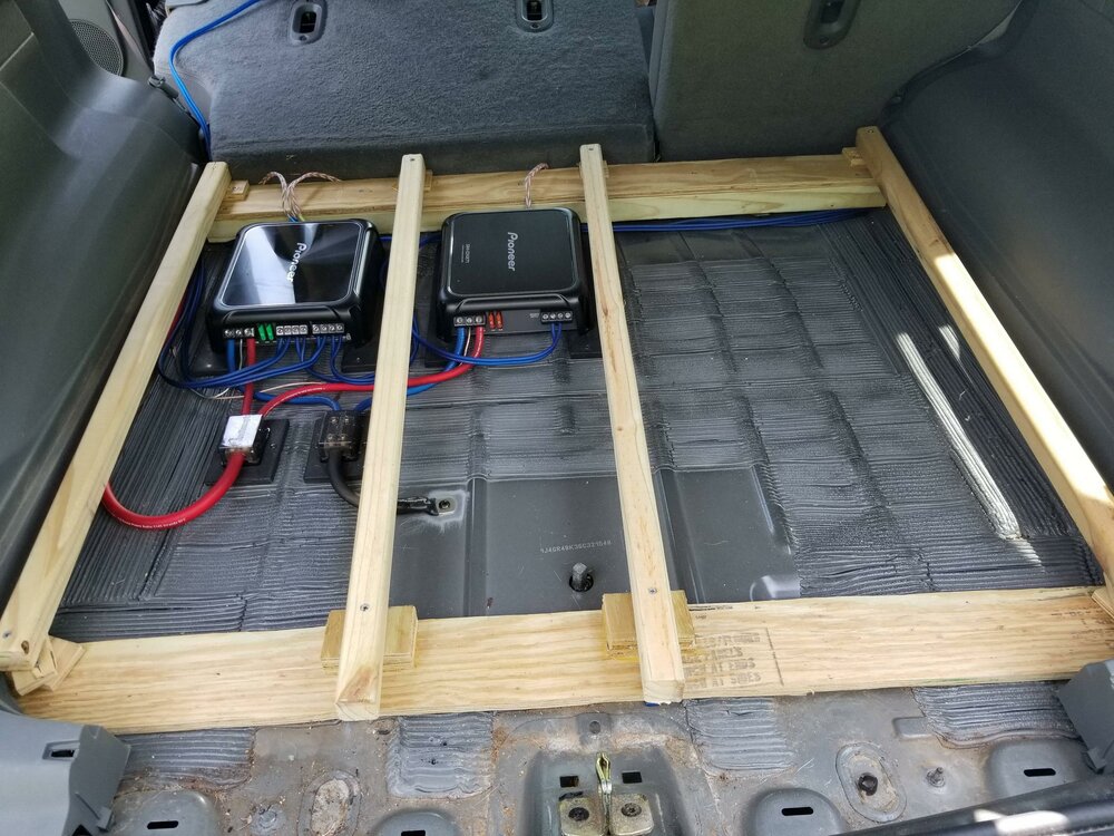

Sa subwoofer are a good choice. A taramps smart 3 would do well on them subwoofers. I’ve seen multiple amm1 readings on that amp and it would be a good amp on them subwoofers at 1 ohm on that enclosure you designed.
:guido:
28 minutes ago, JonDoe said:
the smart 3 looks like a good way to go. would it be safe under my false floor
G7n2Kgr.thumb.jpeg.97f4fb49e96e1dcba705948d160eec06.jpegrjC9xTM.thumb.jpeg.a3e388ff3e1e93edff6380edbcb9dc83.jpeg
No way. Not a taramps.
19 minutes ago, JonDoe said:
and just to be clear the second box with the 4" port and 4cuft? or the first one with the 3" port and slightly smaller cuft?
The second enclosure.
:guido:

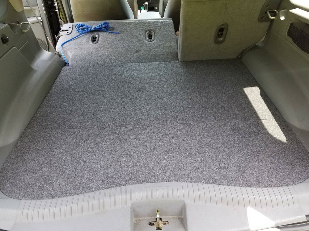

it doesnt have to go there, i could mount it to the back of the seat. i just like to be able to take the box out and use the back if needed.
One more question, what type of head unit do you have? I only ask because taramps like to be around 2v preouts and you would have to tune around a 2v tilt on the tone level you listen to. Do you have a dmm and some alligator clips to go on the lead prongs?
:guido:
