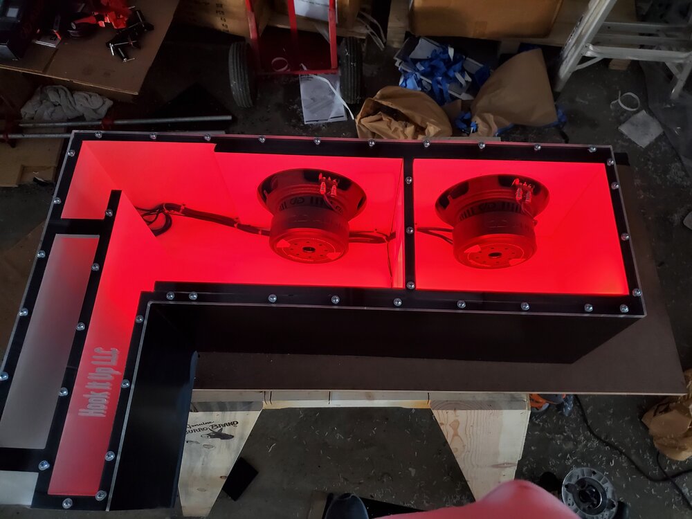

Finally since the top was the only part you would be able to see once the enclosure was installed into the cubie, they wanted the entire top of the box to be acrylic with red LED lighting and the shop wanted their logo somewhere visible.

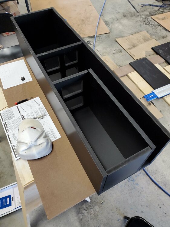

Mocking up the box

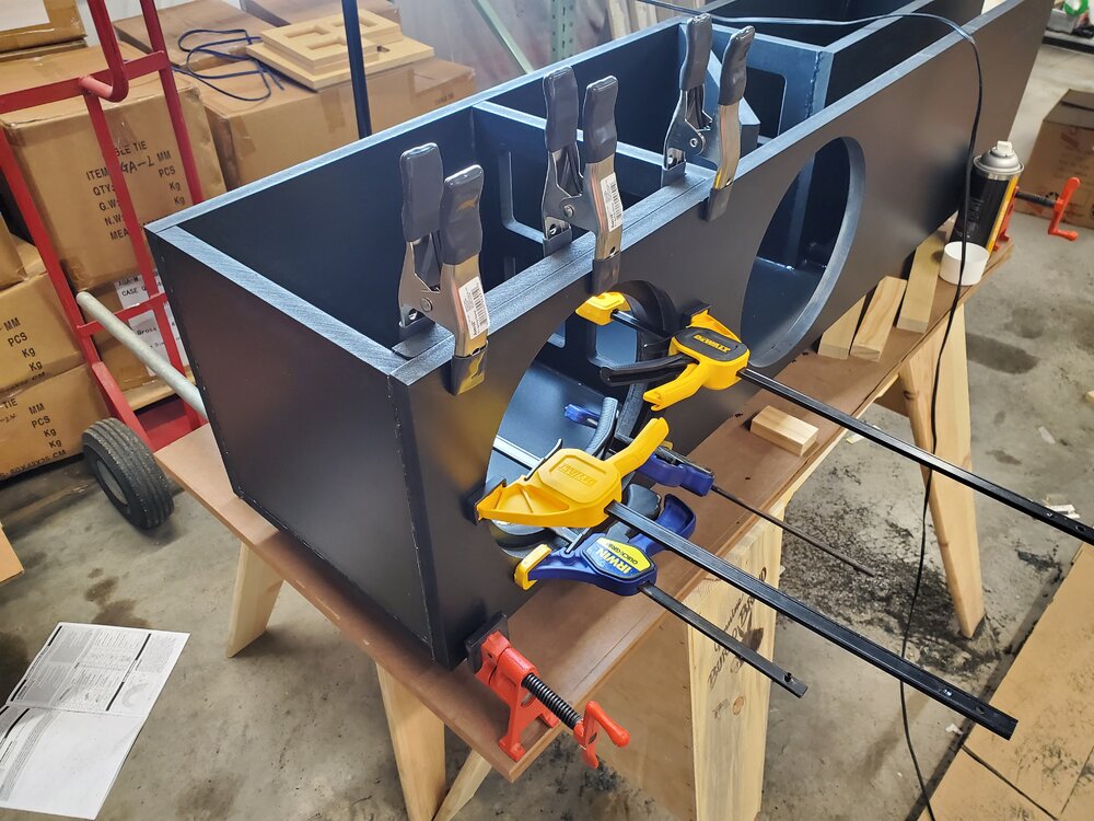

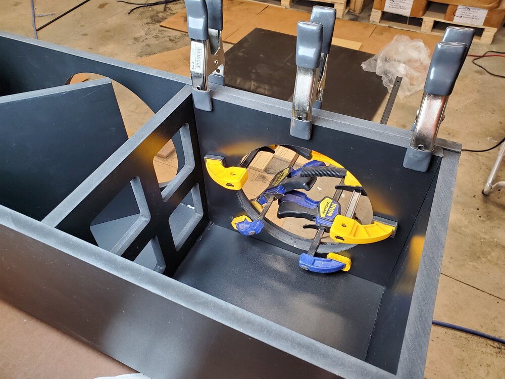

Gluing up the baffles

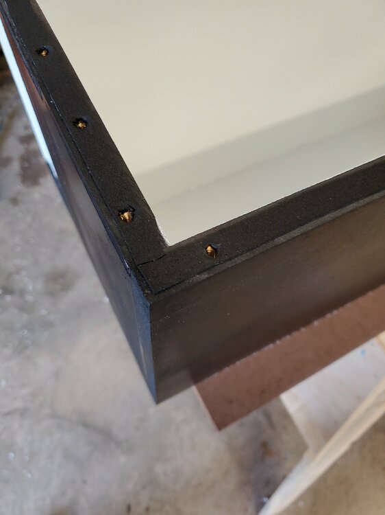

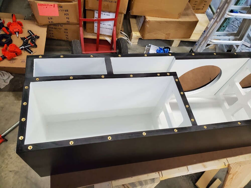

Here you can see all the threaded inserts for 10/32 hardware to mount the acrylic
Adding foam gasket tape.  I used a soldering iron to create holes in the tape for the mounting hardware to pass through

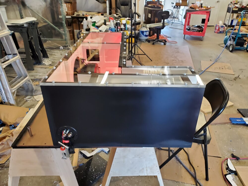

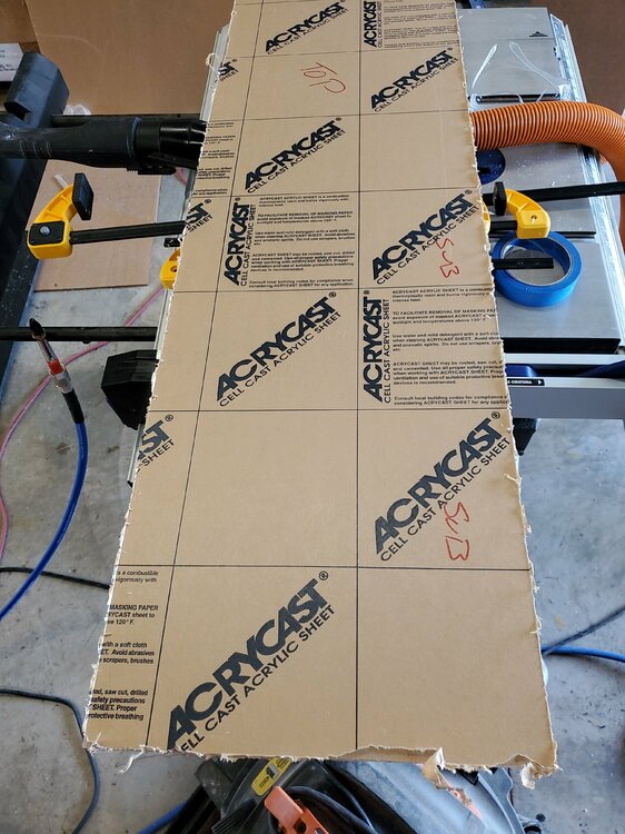

The acrylic top for the box

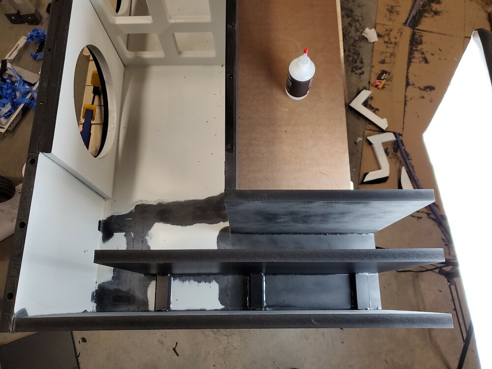

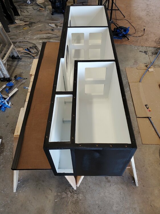

Here is a shot of the box getting moded to fit into the boat
Just like tightbond and MDF, if done right the joints were stronger than the material.  You can see some of the crap material that was torn out to the right on the floor.  I had to do a ton of sanding to get back down to the base and you can still see where the glue chemically altered the material.  I was able to get it all cleaned up, just a lot more priming and painting.

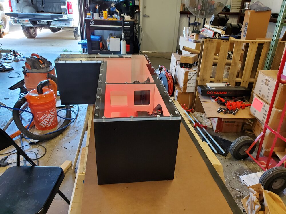

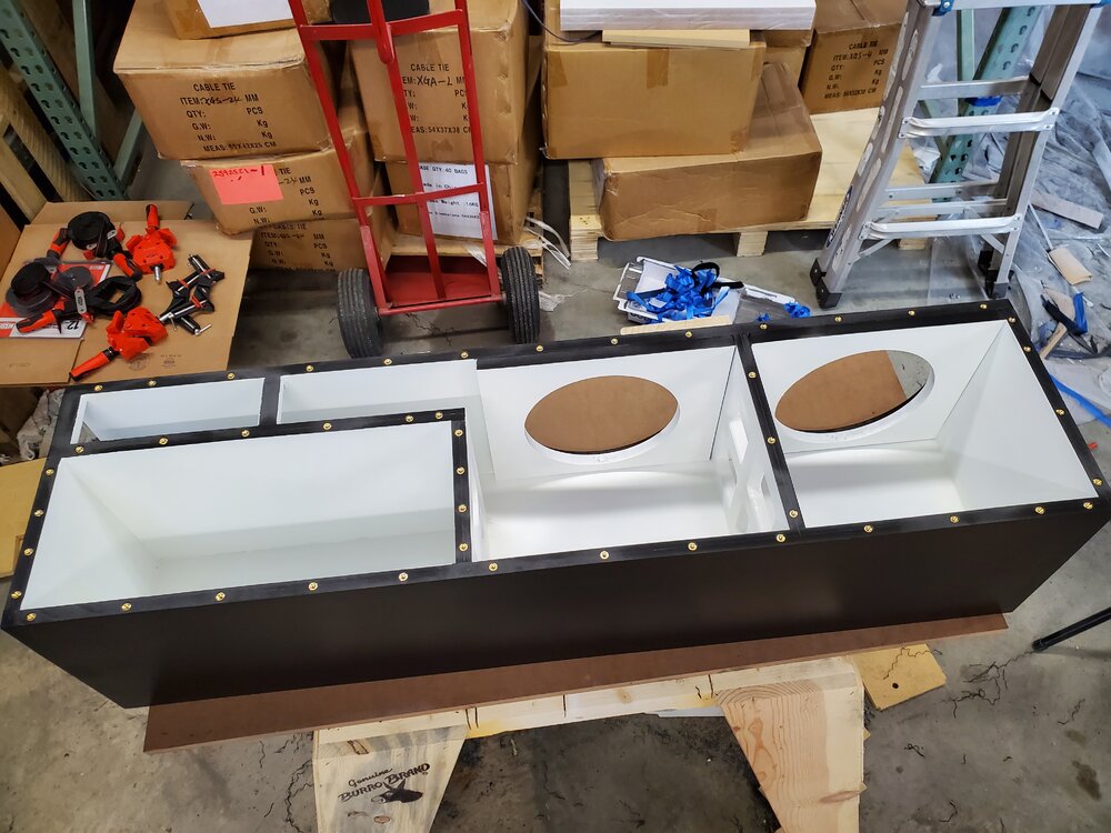

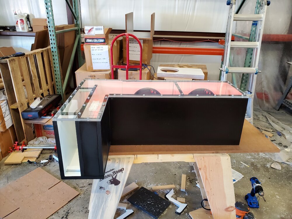

Here is the final box with the acrylic top and the inside finished in flat white.  Drilling and countersinking all of those mounting holes in the acrylic took a few months off my life I'm sure.  There wasn't enough acrylic left to cut another piece if I f'ed it up and hand tools on acrylic give me heartburn but the audio gods were smiling that day I suppose and there were not catastrophic failures.

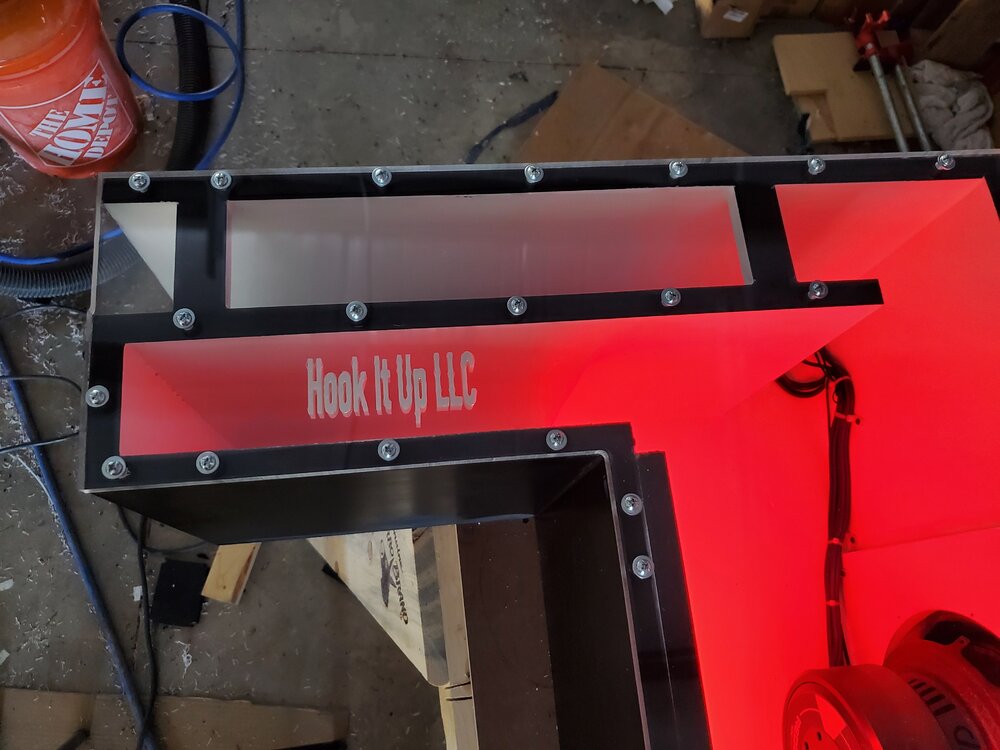

You can see the 3D printed shop logo epoxied in place in this shot, along with the ledges opposite the subs that the lights were mounted under to try and create an indirect lighting effect
When I cut the acrylic I oversized it ever so slightly so I could run a flush trim bit around it, sizing it to the box as accurately as possible.  I learned the hard way that you need something like painters tape or some other substrate to let the bearing ride along.  I got the flush trim done, but the bearing didn't like riding along that PVC and that bit was RIP after this job.  It sucks to as it was a spiral flush bit I had ordered from mobile solutions and they aren't cheap.

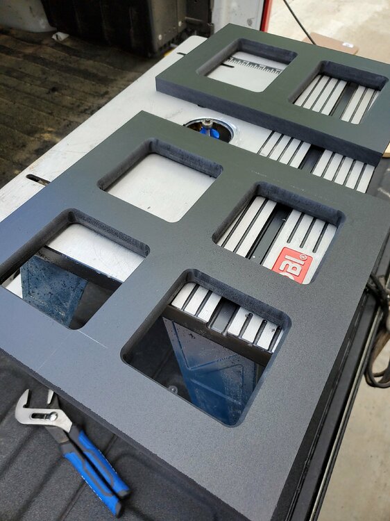

Just for grins and not worth another build post, but here is cutting out a box with expanded PVC using the shop CNC.  I know access to a CNC is definitely a luxury, but this thing makes my life SO much easier for box builds and saves so much time.
This was another enclosure for a boat.  If I remember correctly, it was a single 12 that went in, but this was in January and I've slept a few times since then...
