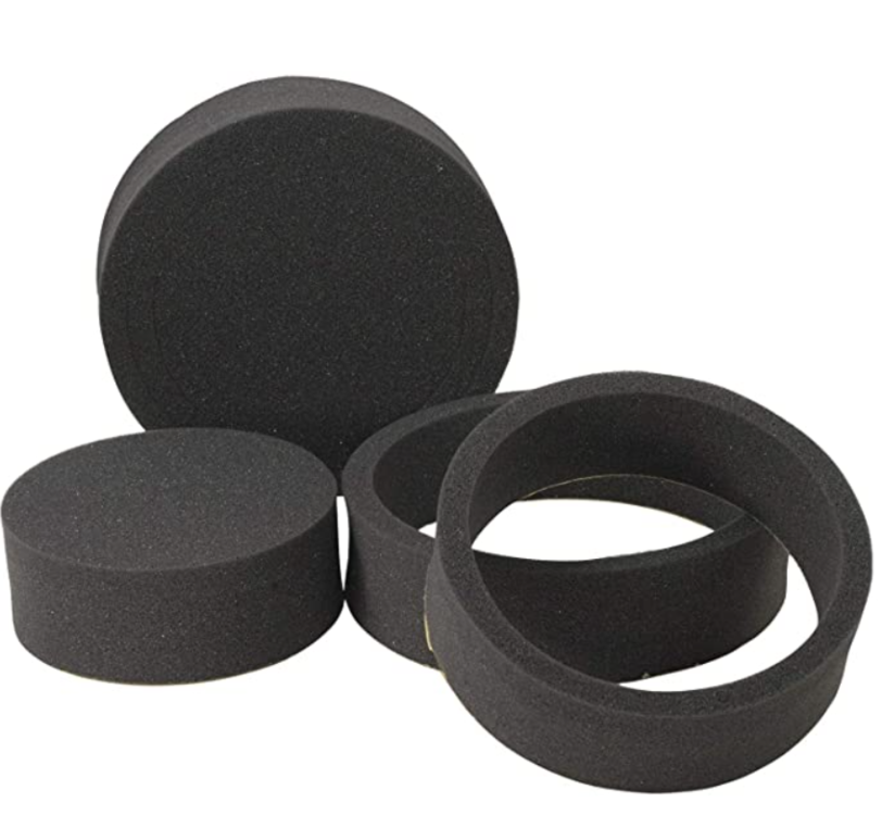

Also, another completely random thought - if the 6.5s are mounted in the door, you might be fighting what are called standing waves, which is where the sound wave reflects off of a hard surface (like your door skin) and essentially bounces back at the driver which can negatively affect the drivers sound, volume and performance.
Using some Fast Rings like these might help:
amazon.com/Road-Kill-RKFR6-Speaker-Enhancer/dp/B076MM4DJV
The round plug (bottom left in the picture) sticks to the door skin directly behind the speaker and helps diffuse any standing waves while the thin foam ring goes around the speaker once it's installed to help funnel all of the sound/energy through the factory grill locations in your door card.  You may have to trim the foam ring or the foam plug.  You want to make sure the plug stuck to your outer door skin doesn't get in the way of the window rolling up and down and you want the ring to be just deep enough to make contact with the door card but not fold over and interfere with the driver's surrounds.
