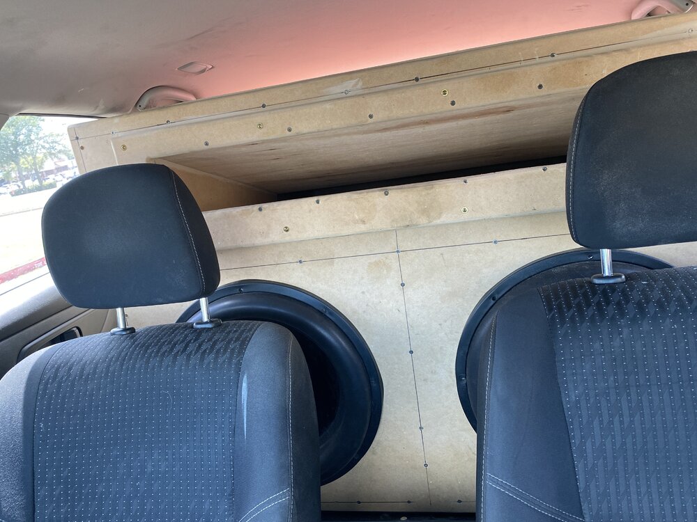

So I let another guy design my box as I was having trouble, now the box is finished and playing. He put a “adjustable port”. I checked the tuning using test tones and It looks like 46 hz 😭
the subwoofers are 2 18” sundown x18
if I shorten the port will that help? I’m really trying to crush lows, I was wanting it tuned at about 32
alsi it was supposed to be a wall and ended up as a big box…. Any advice is very much appreciated. He charged me 1200 to make the “wall” for me
Longer port length equals lower tuning, so you would have to extend that port but make sure it’s the same distance from any inner wall as the height of that port. That’s not sealed off either. So you need to put another beauty baffle, double to triple beauty baffled, at least, on the front and fill with expanding foam in leaky areas. Then carpet the front with black carpet with spray-on adhesive or finish with black bed liner spray. It’ll hide the expanding foam.

Just layer up a beauty baffle and seal it off and carpet it and do flat black touch up. That would lower your tuning and raise your spl.

Making that beauty baffle thicker would lower the tuning because it would be extending the port length.
 So are yo saying to foam around the enclosure to seal it off into a “wall” the carpet it up?
Layer up the existing beauty baffle? Or make a new baffle on top to help seal off the space?

Hopefully this gives a better idea of how the box is designed, there is a space between the topside of the port and the topside of the box also there is no bracing of any kind to stop the box from flexing or moving sadly. And I feel like I should be vibrating things alot more than I am. Currently it’s wired at 4 ohm to the amps so 2 each, but I’m actually seeing about 5-5.5 according to my multimeter
