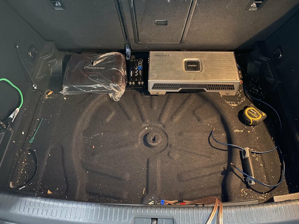

1) With the size of the clarion, I would most likely have to install the LC2I elsewhere than the trunk (maybe glove compartment up front?) see photo 1 - I’ll also need some clearance for the wiring going into the amps. the space in front of the amps gives me exactly enough for a 1ft cubed internal airspace box. Box size I measured out using 3/4inch MDF:
39-1/4 width
4-1/4 tall
17” deep
2) OEM amp is placed under drivers seat (see picture 2) this is literally a perfect fit for my crossovers once the OEM amp is removed. Not really an issue just thought I’d share.
39-1/4 width
4-1/4 tall
17” deep

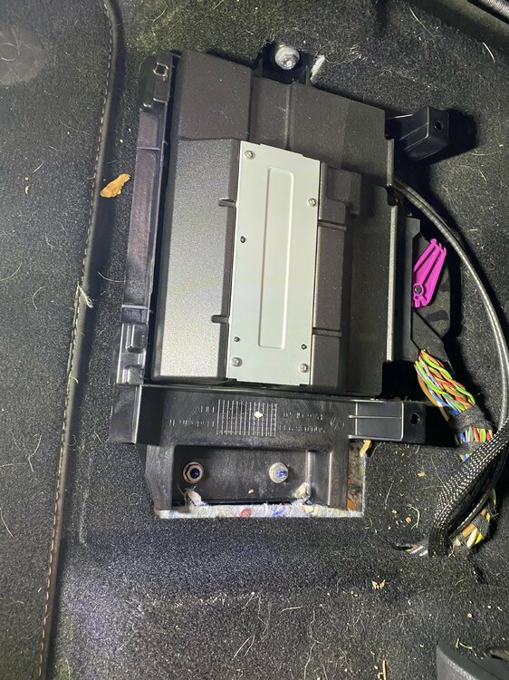

Sounds like a plan to me. Hey, if the Sundown doesn't fit, it doesn't fit. Two 10's should do you well though. Should be a little more than the 12 you just took out.
