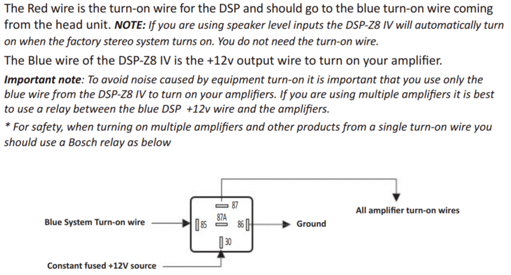

Now, concerning remote turn-on signal...
The NavTV Zen-V has a remote turn-on sensing from the MOST fiber. This in turn should also activate the Zapco via the optical cable (I hope), At least this is what the Zapco instructions alluded to)
I am wondering if I can get away with taking the Zapco remote turn-on output and simply split three ways to the three amps, or if most people put a relay in between to play it safe? I bought a relay Monday (you can see it on my photo above of the amp rack) but it is a normally closed relay which isn't right, I would need Normally Open (which would mean as soon as power/signal input, it closes the circuit and sends power to the rest of the remote wires).

44 minutes ago, BboyTaktix said:
Proceeded to add the 4-ch amp power and ground wires to the distribution blocks - the other ends are loose until I get to the point of installing the two levels into the car - I left enough slack so I could easily slide out the upper amp rack forward onto the seats for ease of access, tuning, etc. Just missing the 8-ga wire and ferrules which should come in tomorrow
img_0863-jpeg.319192
That amp rack already looks like it's going to be clean as hell!
I've always used a relay.... but then again.... I'm that guy who will use a relay for just 2 amps🤣 so maybe don't listen to me lol
Lol thanks Dafaseles,
I will take a look at the Zapco - I know it suggests using a relay if more than 1 amp to remote turn-on, I am going to see what its maximum remote turn-on amperage is, I know the Zen-V remote turn-on is 500mA but in most of the research I did, ppl said use the DSP to remote turn on the amps and not the Nav TV if possible. I still have to find out if the nav TV optical signal is enough to turn the Zapco on.

OK so I figured out what I will need to do - the DSP will not turn on just with optical signal, only if it was speaker level inputs (see below from Zapco instructions). So, I will use the NavTV zen-V remote output to feed the Zapco remote in (red wire), and then use the Zapco remote out (blue wire) to go to a Bosch relay and power up the three amps. Boom!

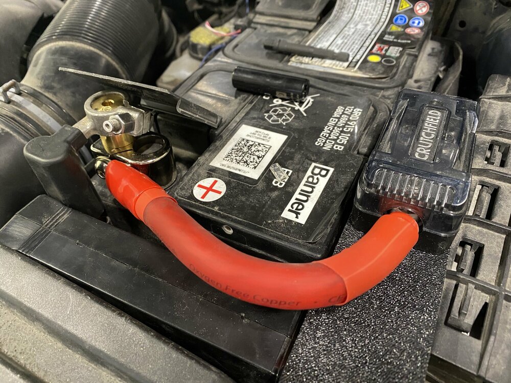

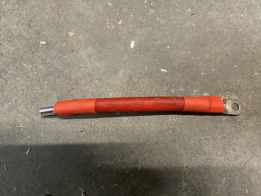

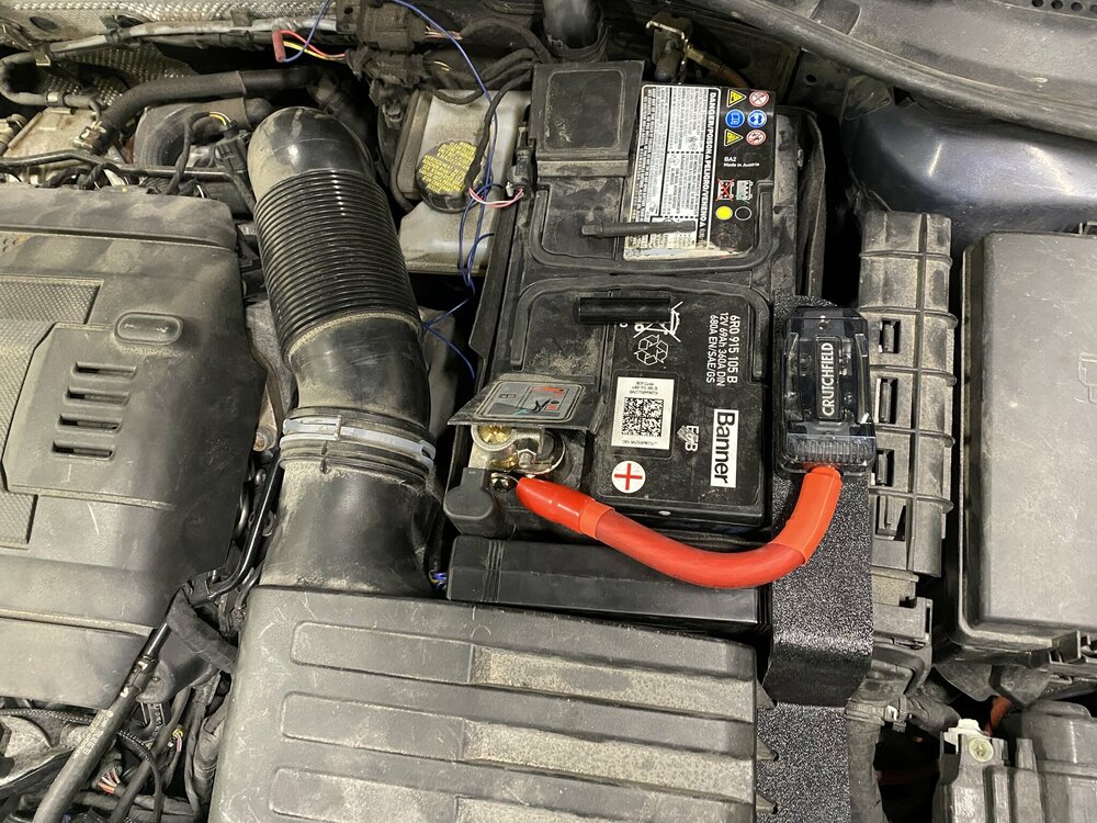

Found the exact relay I needed in my old electrical box. Yay! Wired it up the power and ground, as well as a small terminal block that will split the remote turn-on signal to the three amps to keep it super clean. No photos yet, will take a photo once I finish the 8-gauge wire runs, which should arrive today in the mail (I hope!). Also tested the relay on the car battery (I put pos neg on battery then put the relay activation on positive terminal, heard it click and saw voltage readings on my terminal block) - SUCCESS! ready to wire them to amps.
Afterwards, I hooked up my Knukonceptz terminal tot he battery along with the post, so I could retain factory connector on VW positive battery side. It's all good and tight and as clean as I can get it considering the circumstances (I really didn't want to cut the factory mounting ring off).
Here are some finished photos (note - fuses not in the fuse holder until whole system is complete and ready for install)
IMG_0868.thumb.JPEG.3069dde05839400041664e6a03c34c6e.JPEGIMG_0869.thumb.JPEG.22123b61c9695e96a450713930fcbffb.JPEG
Once again don't mind the dirty engine bay - it is definitely due a cleaning - winter here now and it will get dirty again for sure in short time!
