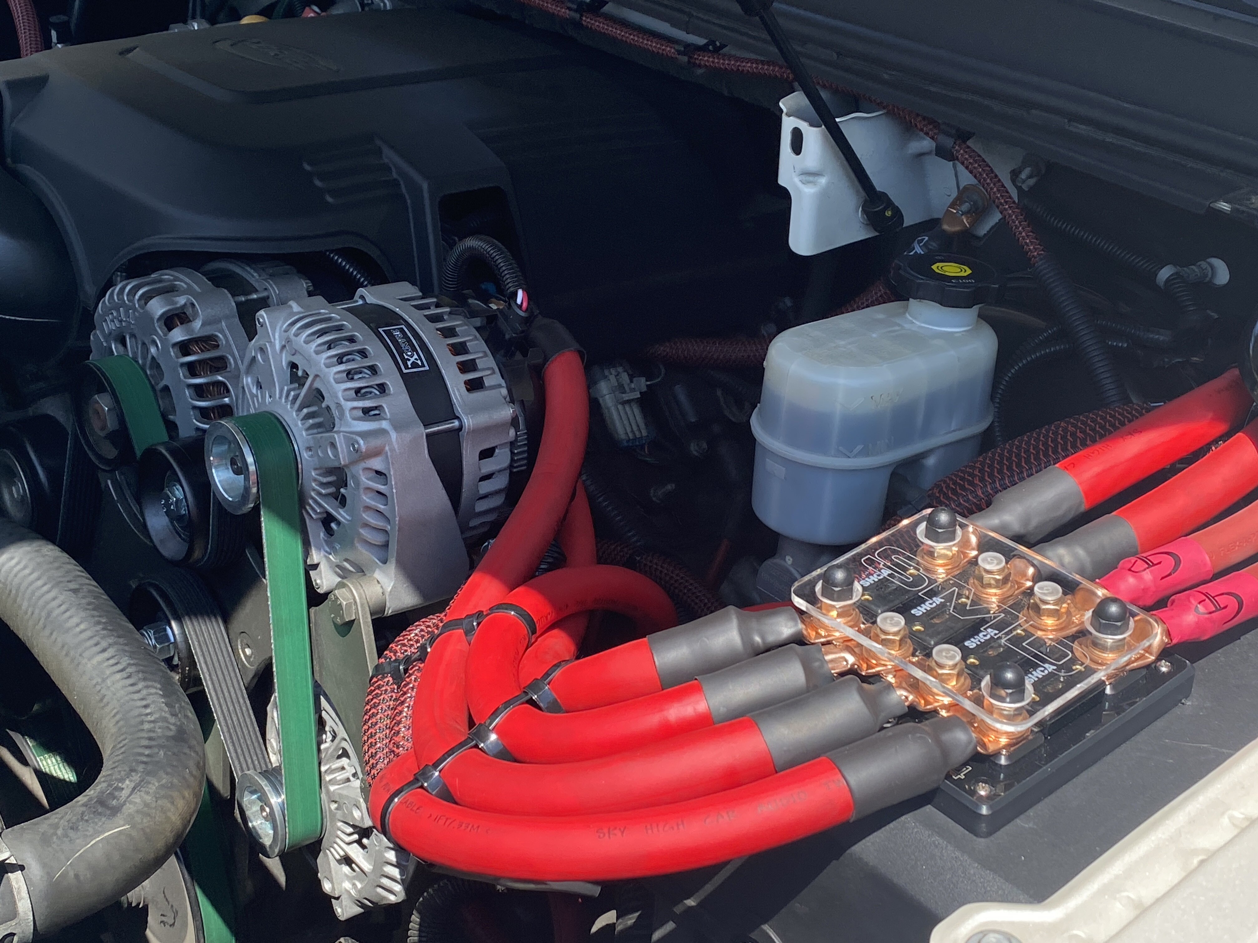

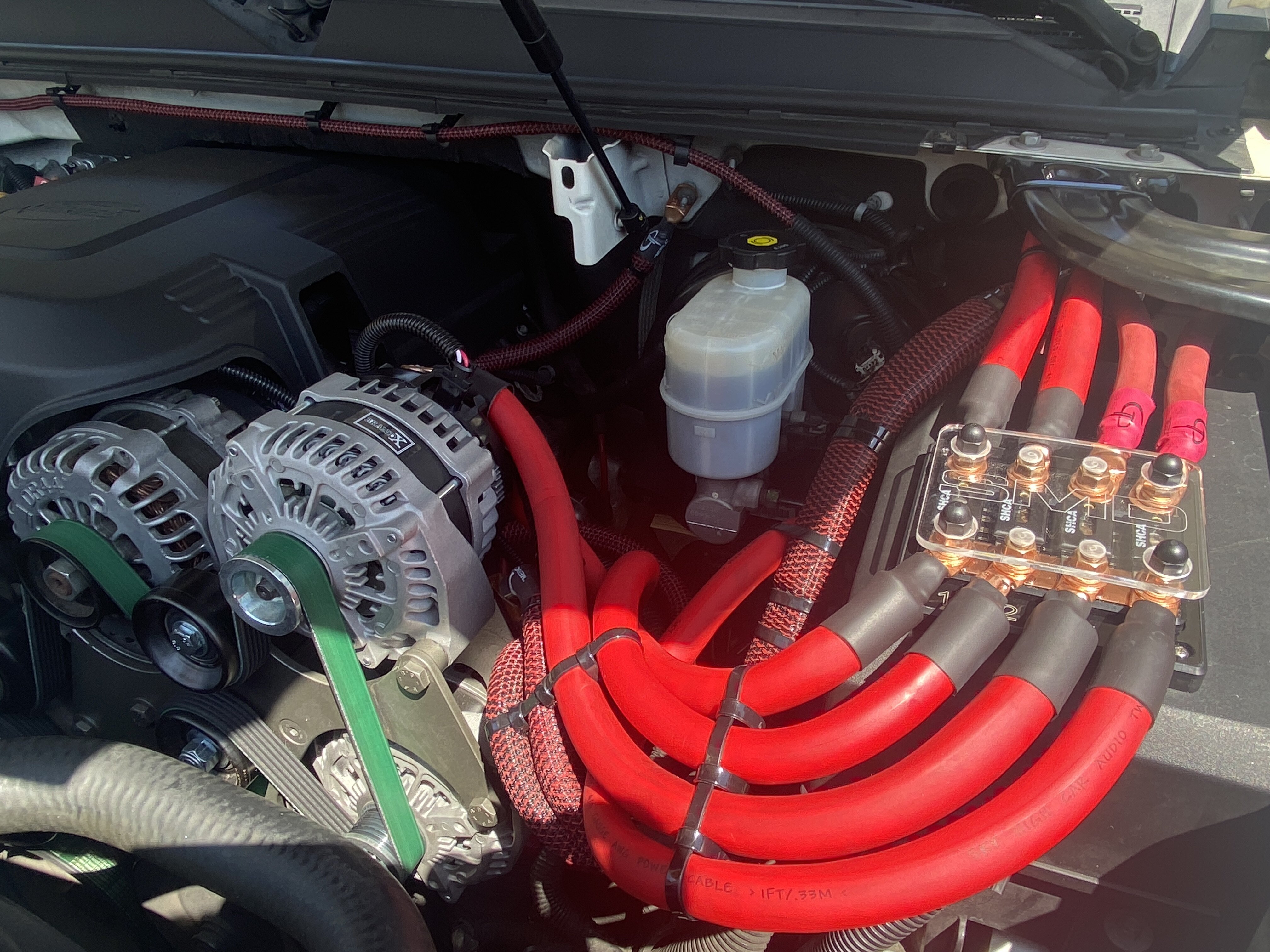

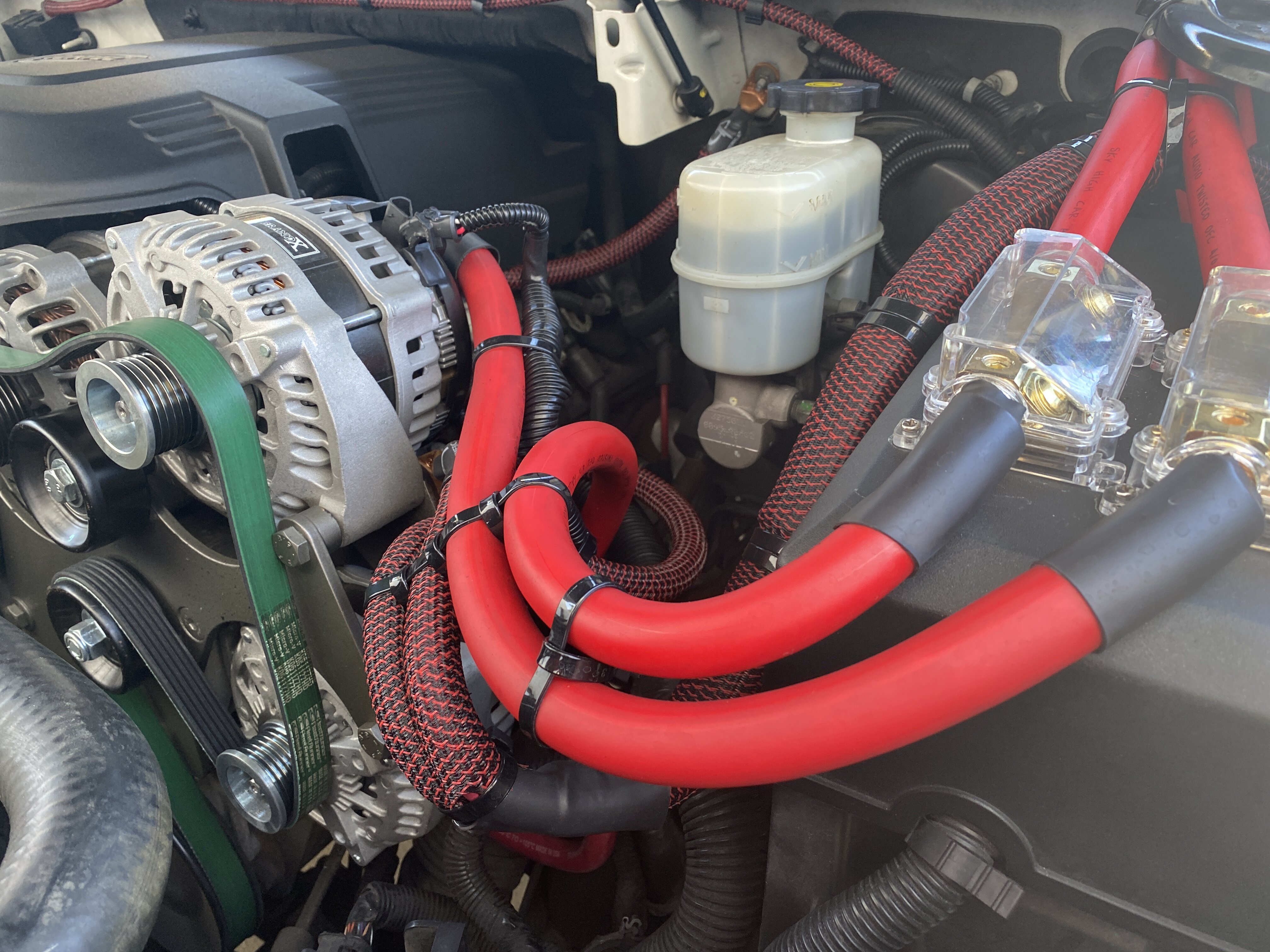

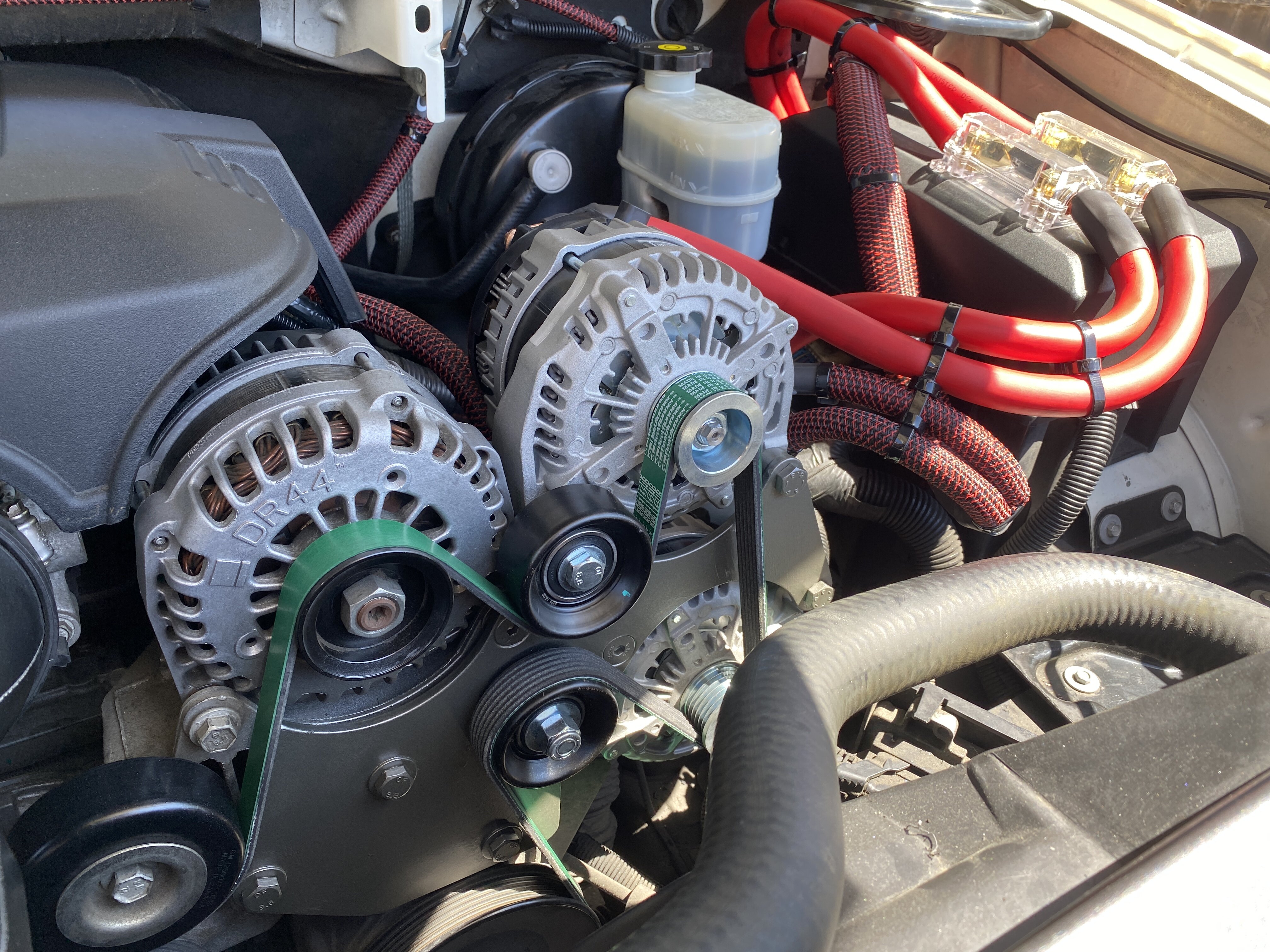

  Super happy to have swapped out the 2 waterproof fuse holders for this copper SMD fused distribution block, excellent product!
   I ran two more runs of 4/0 ofc Sky High from the 390 amp BrandX alts to fused input then added 2 additional runs of 4/0 Excelene to the 40ah Underground Power lithium in the cabin.
   Two images are the old waterproof fuses and the other two images are what is current. :]
