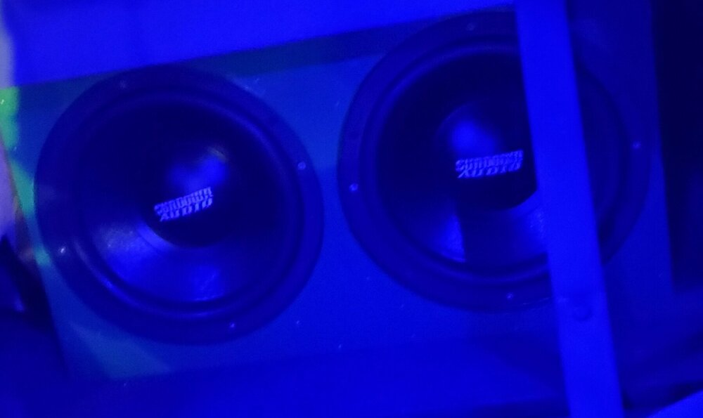

Never Enough Bass Posted November 10, 2021 Author Report Posted November 10, 2021 06 Charger Pioneer double din Pioneer 6.5 and 6×9's Knukoncept Krystal kable rca's 0 ga knukoncept kolossus wire Big 3 same wire ^ 1 run 8g karma ss speaker wire Sundown sia 3500d at 1ohm 2 Sundown U series 12's Duralast platinum agm H7 (Main) Xs power d3400 Trying to find a ho alt
Dafaseles Posted November 10, 2021 Report Posted November 10, 2021 6 minutes ago, Never Enough Bass said: That's a cool picture! 2011 Chevy Silverado under construction My build log here. Check it out!
Never Enough Bass Posted November 10, 2021 Author Report Posted November 10, 2021 1 hour ago, Dafaseles said: That's a cool picture! Thanks it sucks tho the subs are 1500 a piece and all I have running them are 1500 06 Charger Pioneer double din Pioneer 6.5 and 6×9's Knukoncept Krystal kable rca's 0 ga knukoncept kolossus wire Big 3 same wire ^ 1 run 8g karma ss speaker wire Sundown sia 3500d at 1ohm 2 Sundown U series 12's Duralast platinum agm H7 (Main) Xs power d3400 Trying to find a ho alt
