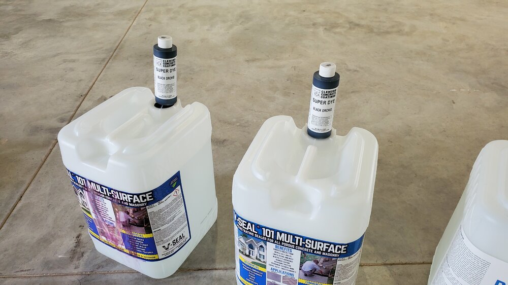

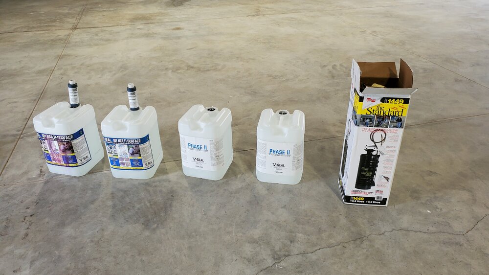

Today I got in the shop around 10ish in the morning and spent the entire day applying a spray on sealer with a little bit of concrete stain to darken it just a bit.  I used a product called V-Seal.  It's pretty easy to work with and has almost no odor at all:
I went with the 101 and Phase II.  In hind sight I could have easily gotten away with a single 5 gallon jug of each.  That said I ended up doing 2 applications of the 101 and a single application of the Phase II.

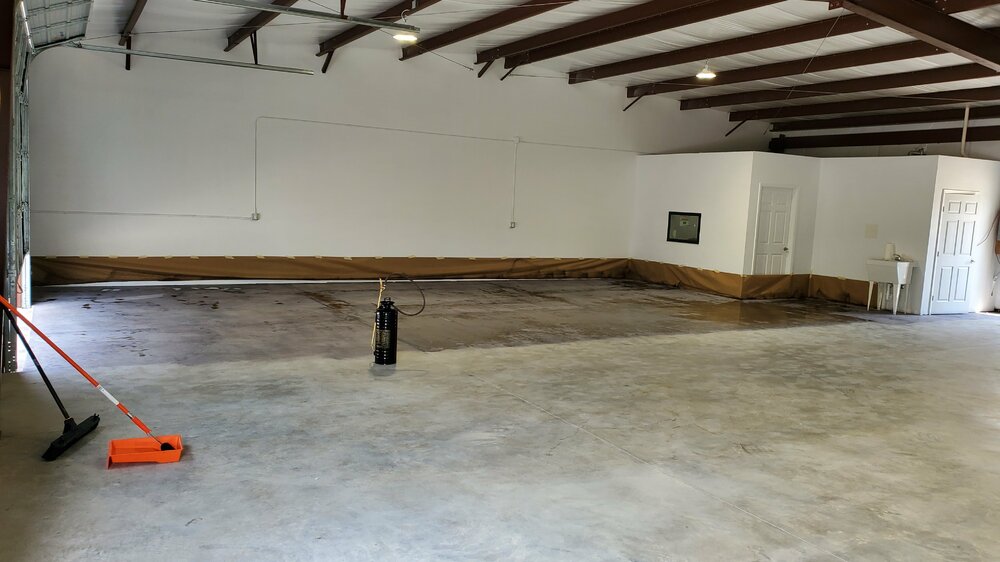

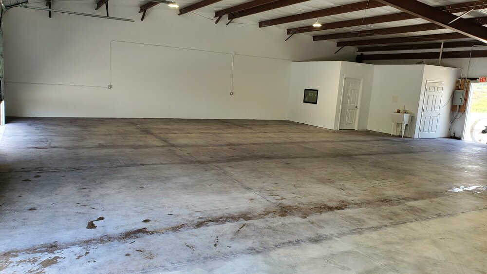

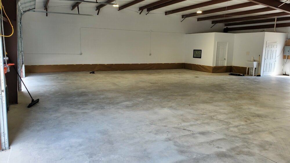

Here is the before with the (mostly) clean floors and some paper masking the painted drywall:

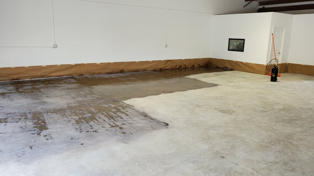

Here are a couple of shots applying it in sections.  You spray it on and then work it with a paint roller:

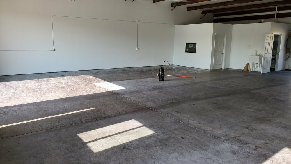

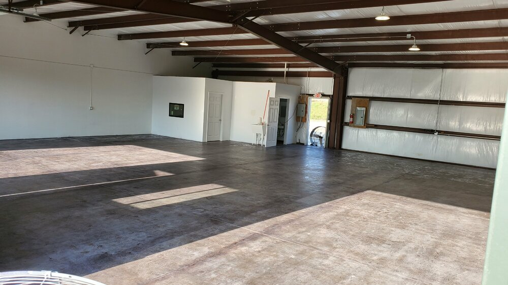

And finally finished with both applications of the 101 with the stain and the Phase II:

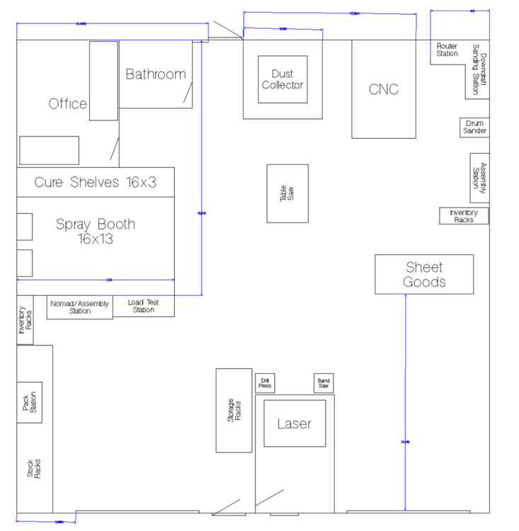

Here is a shot of what I have planned for the build-out / layout:
If I added the stairs I would have to shift the spray booth to the right by the width of the stairs as well as move the inventory rack that is next to the Nomad / Assembly Station.  I think I will also move the entry door to the Laser room to in-between the band saw and the drill press and shift the laser to the other end of the room.

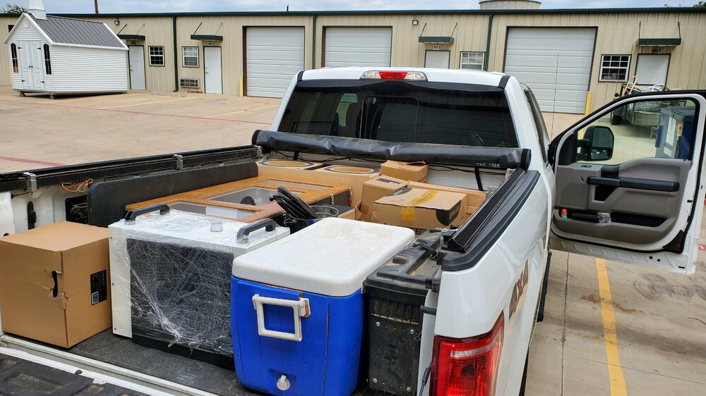

I took another load of boxes over to the new space, just whatever would fit in the bed of the truck.  Figure I'll keep doing small loads like that through the week and will eventually only have the big stuff left.

No videos today, but I snapped a few pictures.  I loaded up the truck with some more random stuff/boxes:

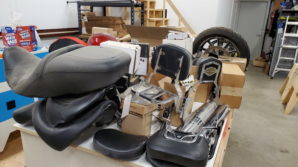

I also started pulling down and sorting all the crap that's been stored on top of the office.  I managed to get (I think) all the Harley parts in one place and put together a Craig's List add:

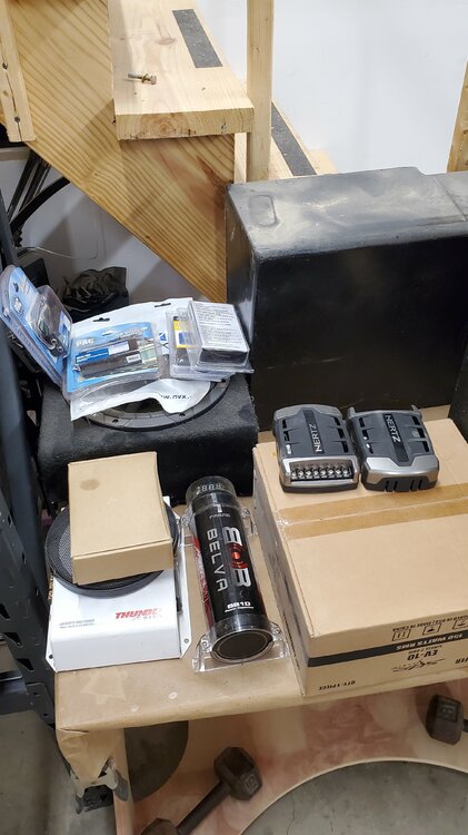

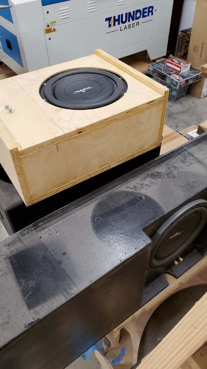

And I got all the old car audio stuff I've had stored for ever down and am just going to donate it to my buddy that owns the car audio shop here in town:
I can tell that stuff is old because I haven't done anything with Skar since maybe 2015/16?  Once bitten, twice shy right ^_^

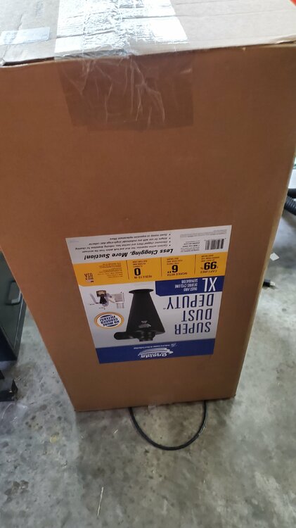

a 6 inch cyclone separator for the wall mount collector I ordered from Rockler that is apparently not getting here until some time in October now.  At least it gives me time to get all the ducting run

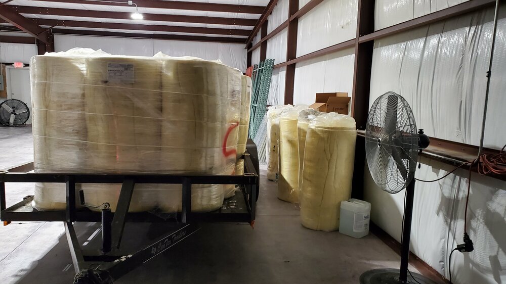

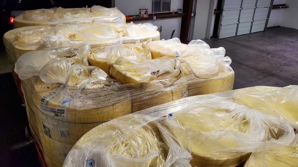

The best part though - my buddy came through with over a trailer load of insulation.  It's all stuff that the company he works for scrapped so it came at the unbeatable cost of free:
That's 30 rolls of 4 foot high, 2 inch thick, 75' long marine grade fiberglass insulation, once I'm done, the interior wall is going to be the one loosing the most cooling/heat!
