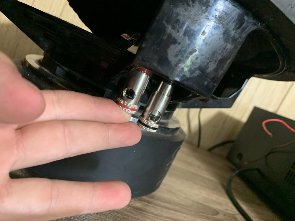

Dafaseles Posted September 11, 2021 Report Posted September 11, 2021 3 hours ago, Liljxthexripper said: i appreciate the quick response, but do you know the actual size of the stock terminals? that way i can buy the correct reducer lol. Looking around the net, everything I see says 8 awg. I haven't personally owned any though, so this is just information I've found 2011 Chevy Silverado under construction My build log here. Check it out!
Never Enough Bass Posted September 11, 2021 Report Posted September 11, 2021 1 minute ago, Dafaseles said: Looking around the net, everything I see says 8 awg. I haven't personally owned any though, so this is just information I've found Proud owner right here lol 06 Charger Pioneer double din Pioneer 6.5 and 6×9's Knukoncept Krystal kable rca's 0 ga knukoncept kolossus wire Big 3 same wire ^ 1 run 8g karma ss speaker wire Sundown sia 3500d at 1ohm 2 Sundown U series 12's Duralast platinum agm H7 (Main) Xs power d3400 Trying to find a ho alt

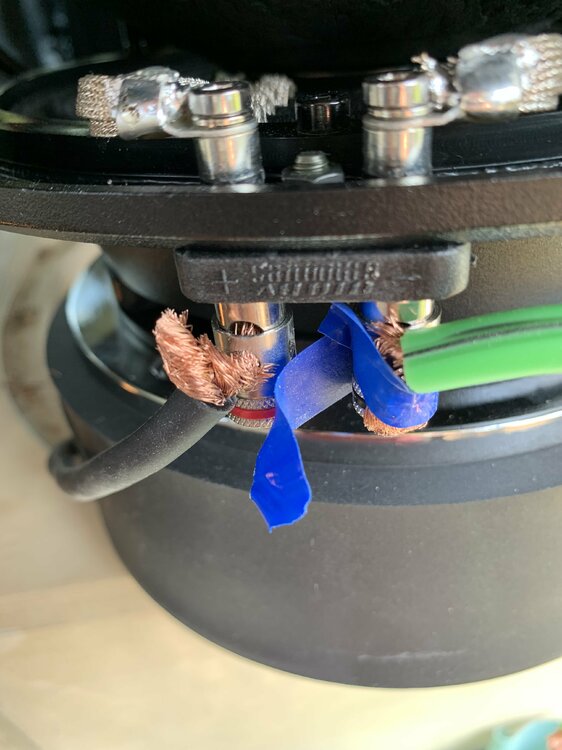

Liljxthexripper Posted September 11, 2021 Author Report Posted September 11, 2021 ill take a pic in a few. combining my 12 gauge wires now and going to run it at 1000 watts combined for now till i get my alternator in, and anyways and itll be a good break in. i thought sky high was supposed to be only about 25% oversized but no. this 8 gauge is like 5 gauge wire because the 2 12 gauge look to be perfect size for the terminals. i was splitting and electrical taping it up so the wire was still contacting the terminal but it was just too sketchy for me to feel good about it.

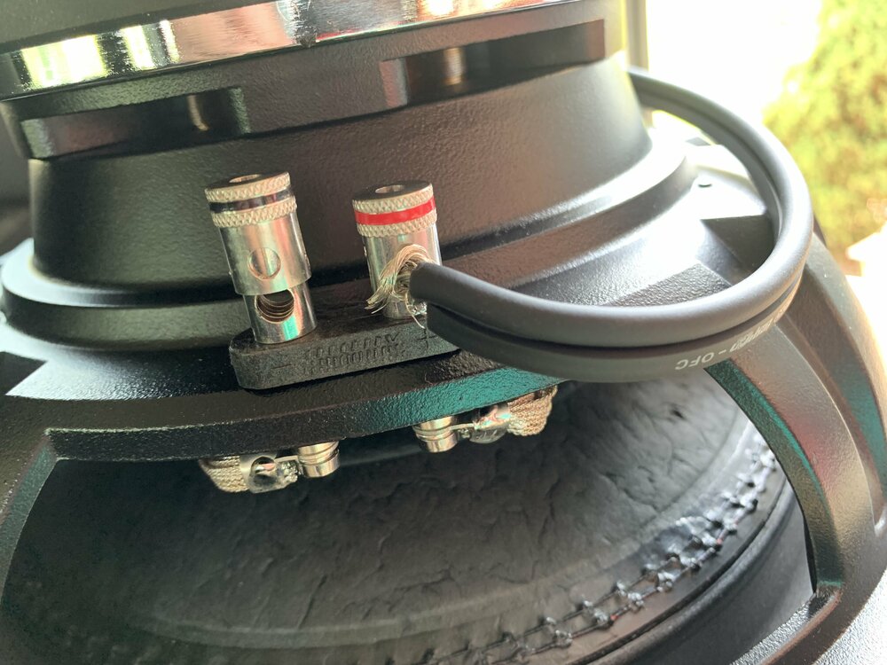

Liljxthexripper Posted September 11, 2021 Author Report Posted September 11, 2021 so even my twist 12 gauge wont fit. the terminal spring cap is 12 gauge, while the inside is actually 8 gauge. legit. these were new in box. already got my custom box, port was 3 inches from bottom so raised it to be about 5 but kept port length for tuning. already about 1400 in with the 0 gauge from gp. itll be clean eventually. im very dissappointed with these terminals. no wonder the guy i got my r3s from had custom 4 gauge terminals on it lol if i kept both i couldve switched but sold my other that i made a house sub out of just before i started this. ima just hope these wires stay in.
