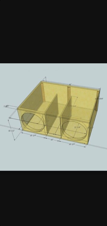

 Not exactly sure what kerfing is. My current enclosure has a rectangular port that flares out on the inside, goes straight, then flares out again at the opening. Is that what u mean? And yes I want the speakers and port facing front. I'm gonna go get a picture of my current box and post it. This is a design I found online for an avalanche but he had never built one before so it may not be the right specifications. But it's close to what I'm wanting. Screenshot_20210912-192444_Gallery.thumb.jpg.864e9a62208a84031f09d1239901631a.jpg
kerfing is bending wood, you cut slits in it then fill the slits with fiberglass/resin to reinforce it
I tend to use the subboxpro site because I can never figure out winisd but that only works on simple designs. Right now I'm doing a less than simple design so I'm at a standstill until somebody smarter than me can help with the calculation. Like I said, I'm no enclosure expert. I'd like to see your setup, you already ordered the 18's so you're committed! I've never heard 18's..
The problem I see with that box design is what I meant about 180" of port area. 10x18=180. I think the way it works, using a port that size would be ok if you net 10-11 cu ft

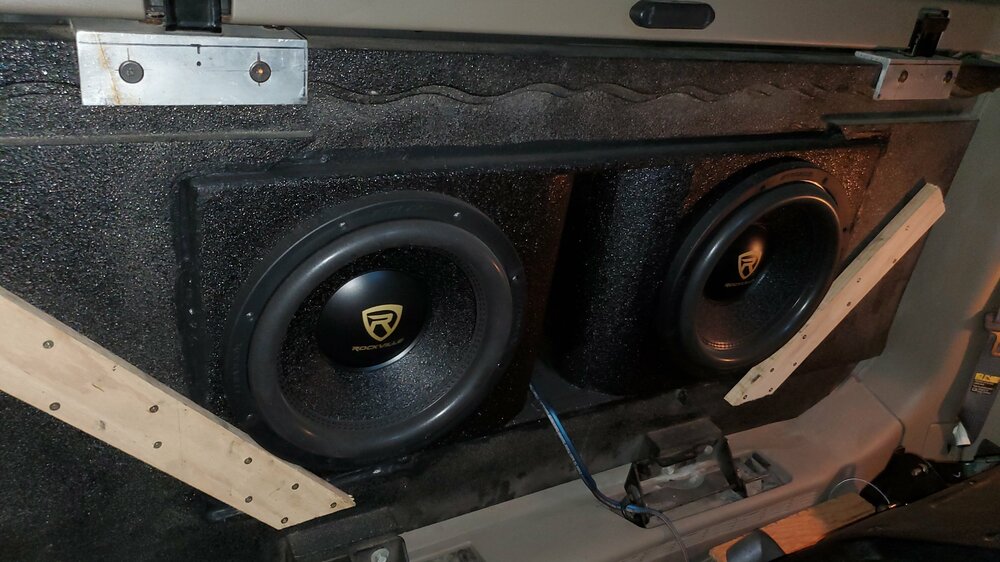

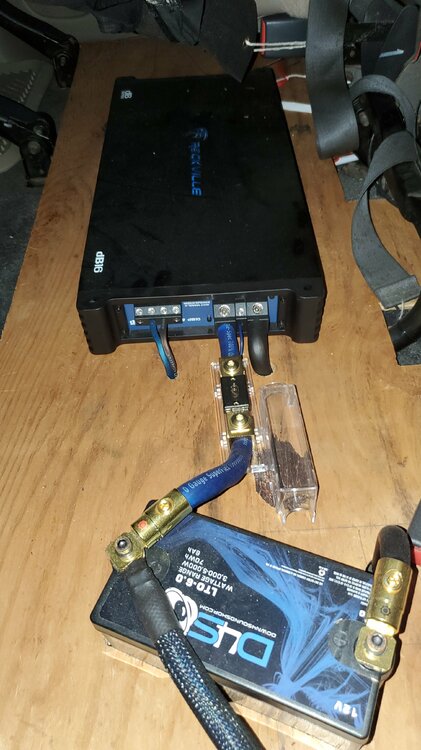

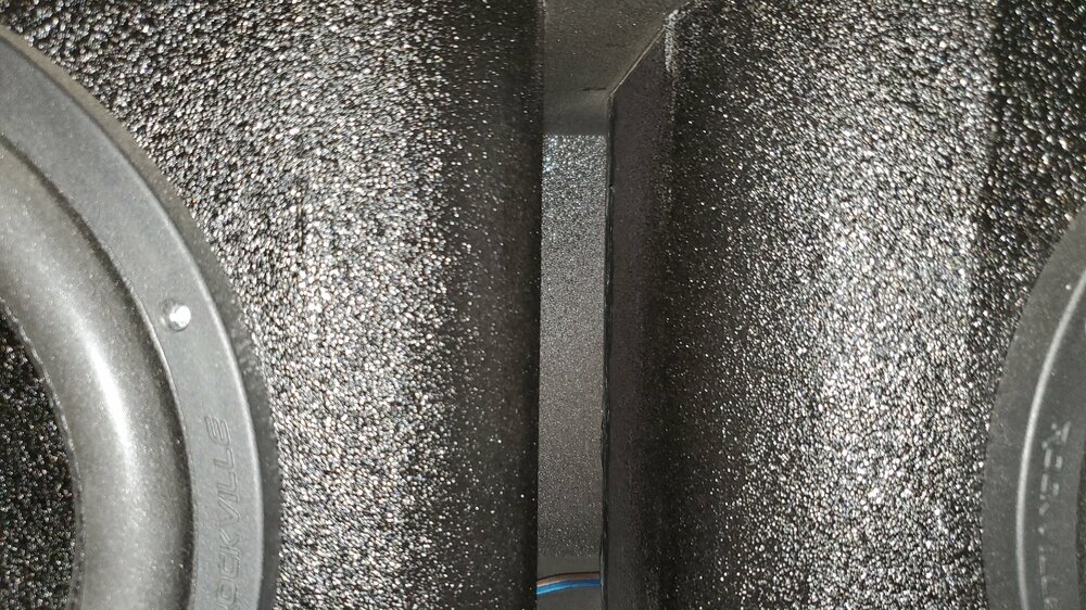

I've never heard 18s in person. Youtube doesn't do them justice because phone mic usually doesn't do well when recording them. But I like the hair trick and the shaking they do to a vehicle. Btw I'm almost 49 so maybe this is just midlife crisis. Here's my current box and set-up20210912_193245.thumb.jpg.d4e29a31a42ad698c175ac8e696bb242.jpg20210912_193313.thumb.jpg.a74f20fae102b9d2d41b2ec0636a3a24.jpg20210912_193419.thumb.jpg.927dcd5d3056b51d0dd86b69d4297df7.jpg
Nice, do you know what subs are in that box? I know the K9's are well regarded for their cost. The only Rockville item I installed was an OFC amp kit. I almost ordered a K9 12 numerous times but I always backed out. I was in the market again last week but I decided to go with CT Sounds.
Hopefully somebody else can give a better opinion on the 18" plans, I didn't do the math after subtracting port & sub displacement, but I think that port area will work as long as you don't net over 11 cu ft.
