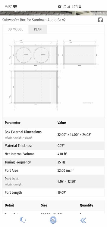

Never Enough Bass Posted September 21, 2021 Report Posted September 21, 2021 Would this box work or can anybody help fix it 06 Charger Pioneer double din Pioneer 6.5 and 6×9's Knukoncept Krystal kable rca's 0 ga knukoncept kolossus wire Big 3 same wire ^ 1 run 8g karma ss speaker wire Sundown sia 3500d at 1ohm 2 Sundown U series 12's Duralast platinum agm H7 (Main) Xs power d3400 Trying to find a ho alt

Triticum Agricolam Posted September 21, 2021 Report Posted September 21, 2021 How much power you running? "Nothing prevents people from knowing the truth more than the belief they already know it.""Making bass is easy, making music is the hard part."Builds:
Never Enough Bass Posted September 21, 2021 Author Report Posted September 21, 2021 Sia 3500 at 1 ohm so before rise 3500 or more 06 Charger Pioneer double din Pioneer 6.5 and 6×9's Knukoncept Krystal kable rca's 0 ga knukoncept kolossus wire Big 3 same wire ^ 1 run 8g karma ss speaker wire Sundown sia 3500d at 1ohm 2 Sundown U series 12's Duralast platinum agm H7 (Main) Xs power d3400 Trying to find a ho alt

Triticum Agricolam Posted September 22, 2021 Report Posted September 22, 2021 7 hours ago, Never Enough Bass said: Sia 3500 at 1 ohm so before rise 3500 or more My suggestion would be to use more port area. Ideally I'd like to see a minimum of 75 sq in of port area based on the amount of power you are going to be running. At 52 sq in you will likely have significant port compression and port noise. Port compression can eat up half your power pretty easily, so it not something you want to have if you can avoid it. "Nothing prevents people from knowing the truth more than the belief they already know it.""Making bass is easy, making music is the hard part."Builds:
Never Enough Bass Posted September 22, 2021 Author Report Posted September 22, 2021 Ok so more port area I was just going with the recommendations of the subs 06 Charger Pioneer double din Pioneer 6.5 and 6×9's Knukoncept Krystal kable rca's 0 ga knukoncept kolossus wire Big 3 same wire ^ 1 run 8g karma ss speaker wire Sundown sia 3500d at 1ohm 2 Sundown U series 12's Duralast platinum agm H7 (Main) Xs power d3400 Trying to find a ho alt
Triticum Agricolam Posted September 22, 2021 Report Posted September 22, 2021 14 hours ago, Never Enough Bass said: Ok so more port area I was just going with the recommendations of the subs Yeah, for whatever reasons, a lot of manufacturers recommend less than optimal port area for their subs. Adding more port area in your situation will certainly be beneficial though. "Nothing prevents people from knowing the truth more than the belief they already know it.""Making bass is easy, making music is the hard part."Builds:
Never Enough Bass Posted September 22, 2021 Author Report Posted September 22, 2021 Ok so what if I went aero port instead of a slot port 06 Charger Pioneer double din Pioneer 6.5 and 6×9's Knukoncept Krystal kable rca's 0 ga knukoncept kolossus wire Big 3 same wire ^ 1 run 8g karma ss speaker wire Sundown sia 3500d at 1ohm 2 Sundown U series 12's Duralast platinum agm H7 (Main) Xs power d3400 Trying to find a ho alt
