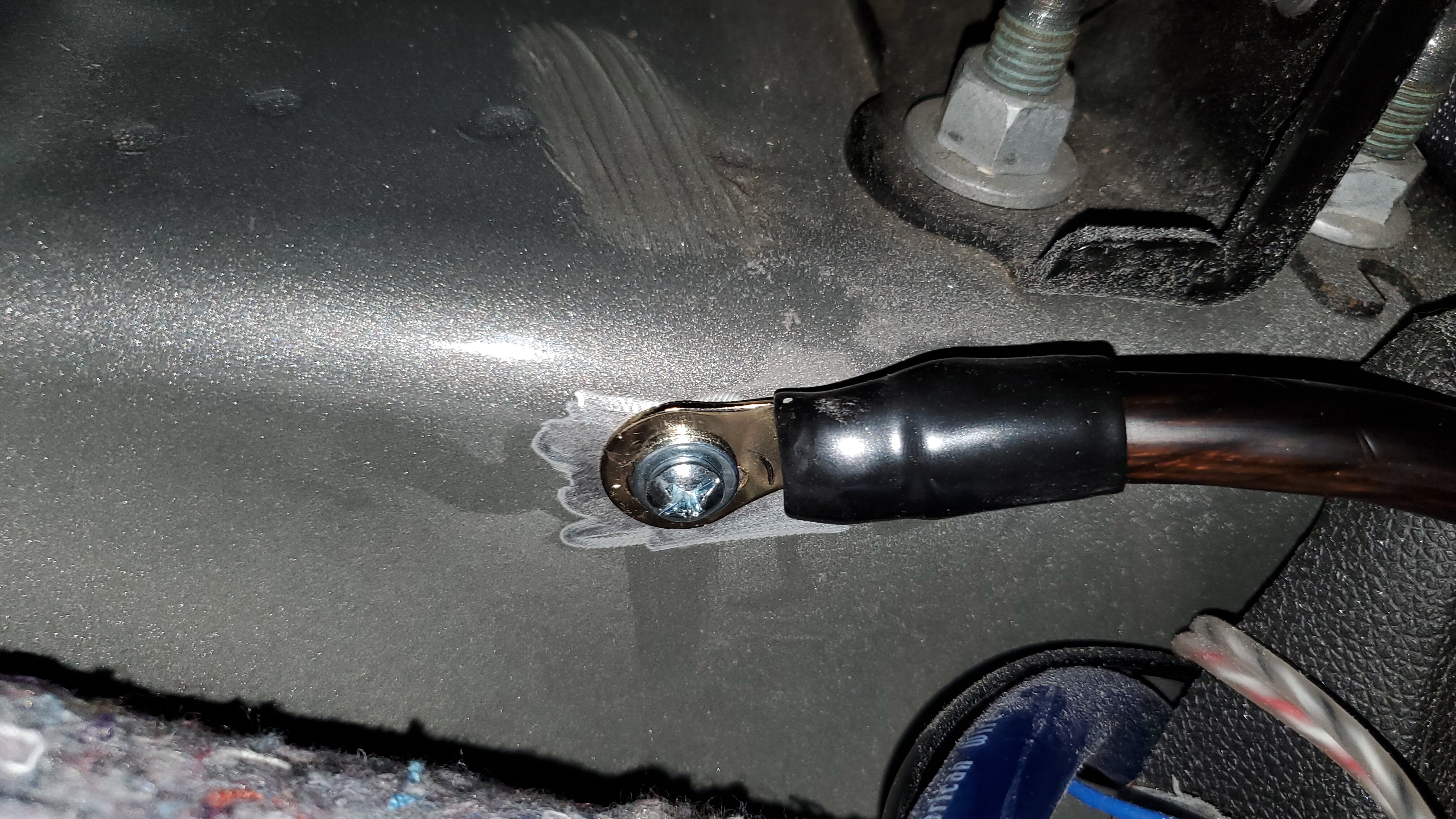

It doesn't look like you cleaned the paint off that ground at all. Also, a bolt and washers will make that ground way tighter, thus a better conductor.

So the speaker wire is 12 ga knukonceptz. I just got home and hardwired them directly to the amp bypassing any terminals. I also grinding down the paint on myground location and secured it with proper nuts and bolts and washers. It is maybe 5% louder than before and clearly something is still wrong :(

That ground looks a million times better, but once you bring the DMM out, I would also check that location and make sure it's a good grounding location (videos on YouTube will show you how to do this). Just because it's think sheet metal, if it's a welded piece, or maybe some other reason, it might not be a good conductor.
I can't see how long your ground cable is, but make sure it's as short as possible. If you can find a good, maybe even better grounding location closer to the amp, that's always better. Best would be going to the frame.

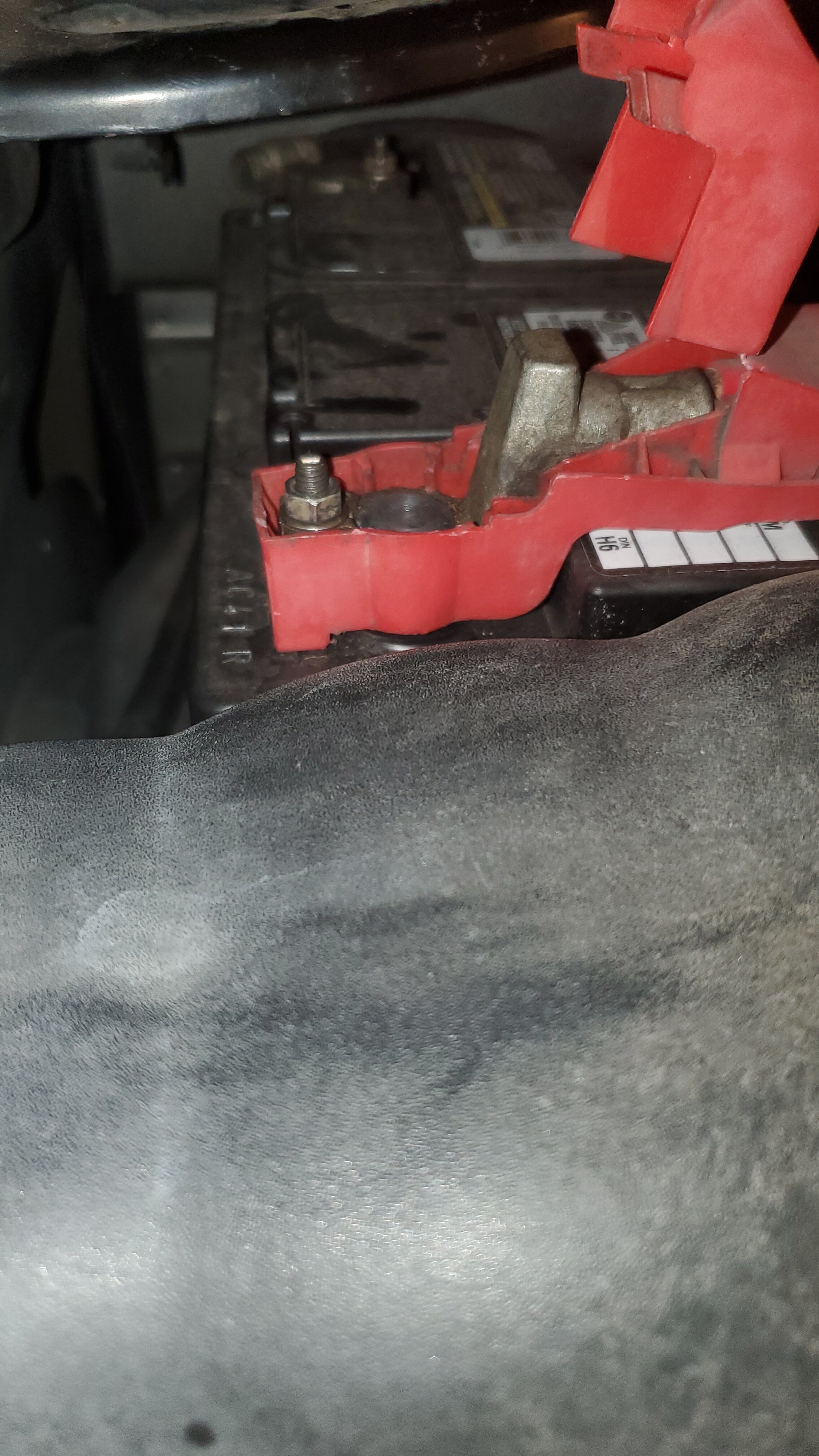

It didn't mention anywhere if you had the big 3 done in your car. If you haven't, or I just missed it, you should do that as well. Since your ground is connected to the chassis, a nice, thick wire from the battery negative to the chassis would be a good idea as well.

These are my battery terminals, the power was just ran from the small stud and there is nothing added to the negative stud. Can i just add a 0 ga from the neg to the chassis and try that? Otherwise I'll have to order more to do the entire big 3, which i will at some point. 20211019_210446.thumb.jpg.64a6ea8128003ad73357ac2419965b4f.jpg
Chassis to engine block I did mine right to the alternator bracket and battery to chassis and positive battery to positive alternator
