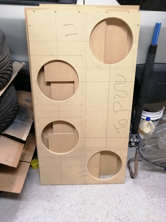

killerc998 Posted November 7, 2021 Author Report Posted November 7, 2021 So box ended up being 9.88932 gross, 7.7 net tuned to 35 hrz. Port is 7.5"x15", .75" external port that will be half rounded off. Internal port will be rounded.

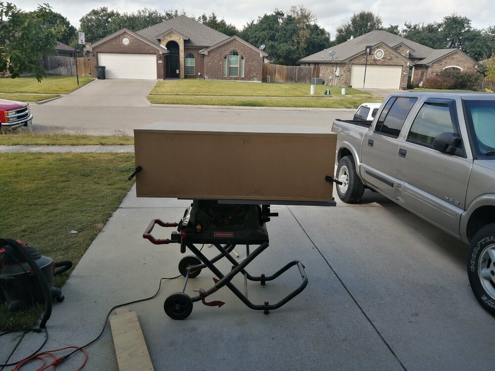

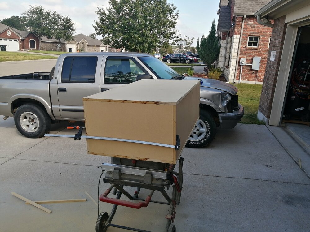

killerc998 Posted November 23, 2021 Author Report Posted November 23, 2021 Thought this was an interesting picture. Was test fitting width. Port has been round over rounded the port sides, now time to glue the rest of the box together.
Dafaseles Posted November 23, 2021 Report Posted November 23, 2021 1 hour ago, killerc998 said: Thought this was an interesting picture. Was test fitting width. Port has been round over rounded the port sides, now time to glue the rest of the box together. It's coming along! 2011 Chevy Silverado under construction My build log here. Check it out!
