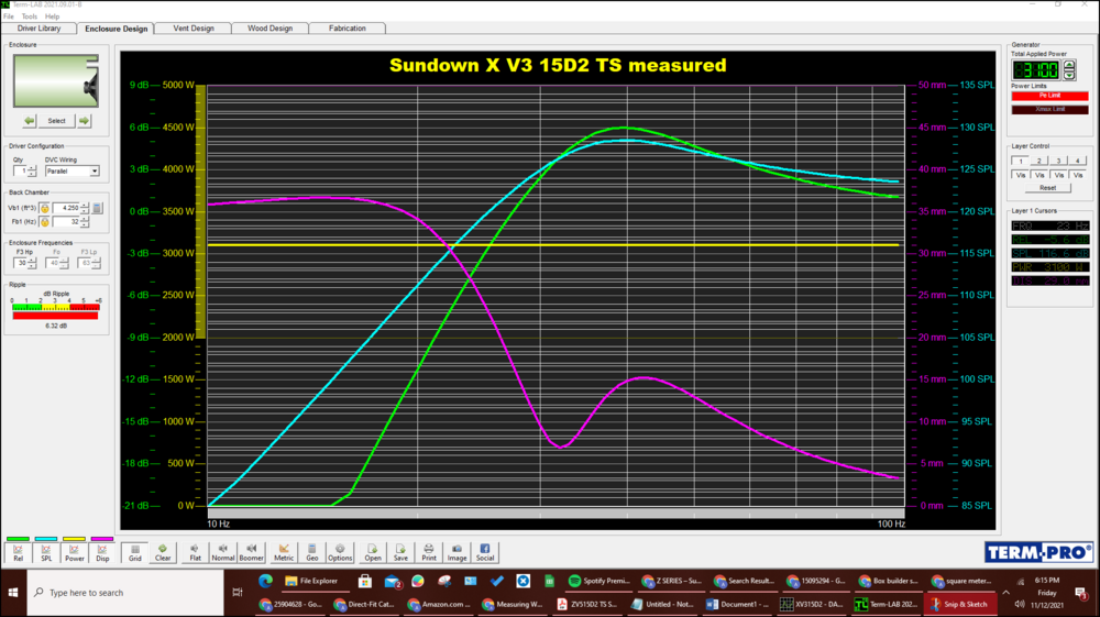

tyma1026 Posted November 10, 2021 Report Posted November 10, 2021 I just recently bought the Term-Pro Enclosure Design Software. I like it and it works pretty good. I use bassbox pro in the past, winisd, hornresp, and torres.

tyma1026 Posted November 12, 2021 Report Posted November 12, 2021 On 11/10/2021 at 10:13 AM, Dafaseles said: I was just looking at that term pro software last night. You like it? It seemed pretty in depth and legit Yep. I think it was worth the money. The only issue I have is that it crashes sometimes. So save your work often lol It's legit and will help you to create what you want. it's as easy to use as bassbox pro 6 if you've used it. Maybe easier than that. Just beware of the crashing. I'm still learning how to do more with the program but here is a screenshot below if it helps any.
