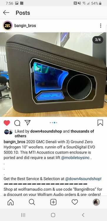

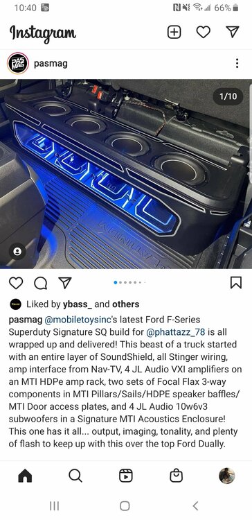

17 hours ago, Dafaseles said:
One of my favorite under the seat enclosures.
4 10" w6's sealed
Granted, they're firing up, and it's an F250 platinum if I remember correctly.
And I was thinking a port like this
I don't know how hard that would be though
Gobs of beauty right there, mixed feelings on the ported one though, port should at least have the area equivalent to three 4" ports going by the sub manufacturer box specs, also the length of the port seems kind of short? Anyways if you can't allow yourself such expenses it's good to know that a well built simple box would not be of inferior performance.
