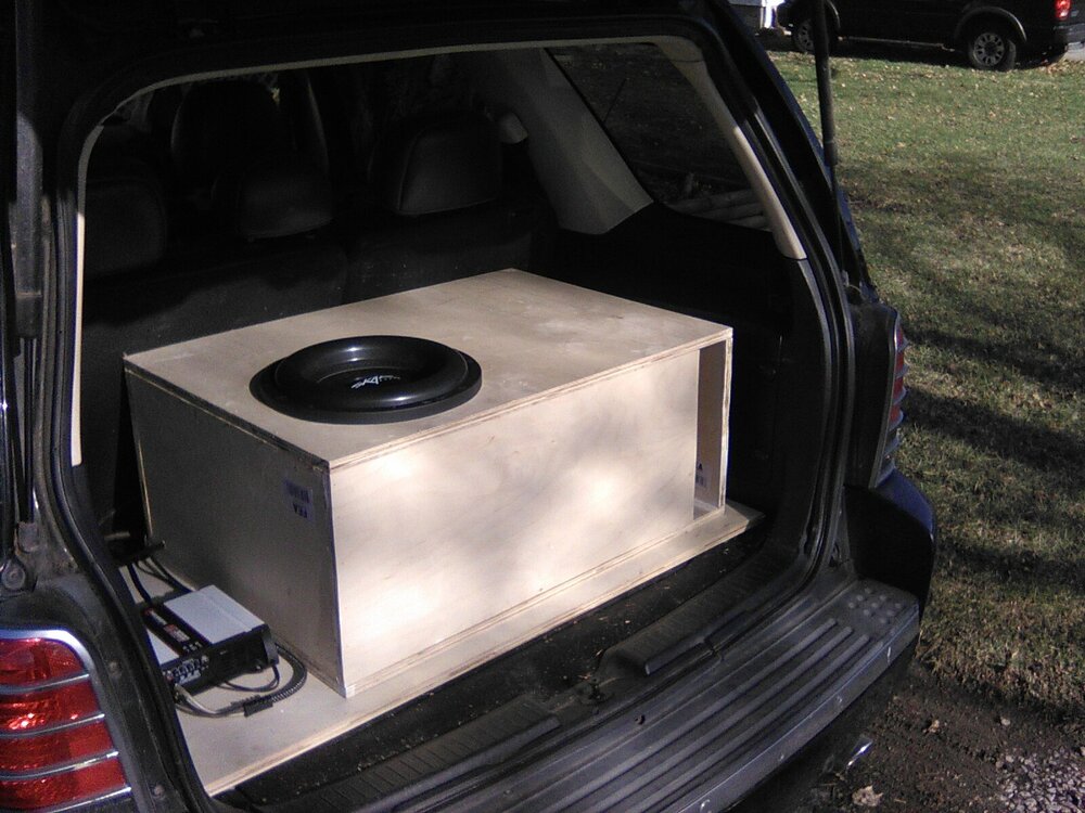

This is what I went with, I really like it
still need to brace it up, but hey, I enjoy it!
Crazy design built crazy fast but I do agree with you, if you enjoyed the outcome, in the end it's all that matters.
