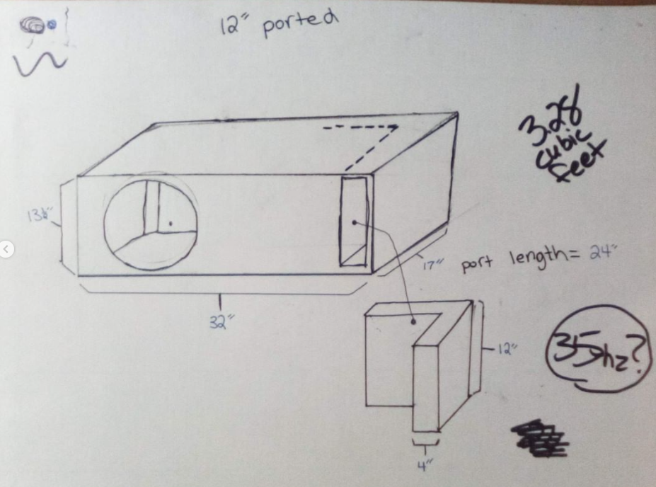

Joe X Posted January 1, 2022 Report Posted January 1, 2022 In order to calculate your port center line length, please measure for me the distance shown in the picture:
BassHeadBlakeYo Posted January 1, 2022 Author Report Posted January 1, 2022 1 hour ago, Joe X said: In order to calculate your port center line length, please measure for me the distance shown in the picture: 7"s
BassHeadBlakeYo Posted January 1, 2022 Author Report Posted January 1, 2022 2 hours ago, Joe X said: In order to calculate your port center line length, please measure for me the distance shown in the picture: it's not 7"s, I'll go measure it for yea

Joe X Posted January 2, 2022 Report Posted January 2, 2022 9 hours ago, BassHeadBlakeYo said: 7"s To give you an idea of what you are dealing with, if that measurement was actually 7" you would be tuned to 42.5 Hz !
