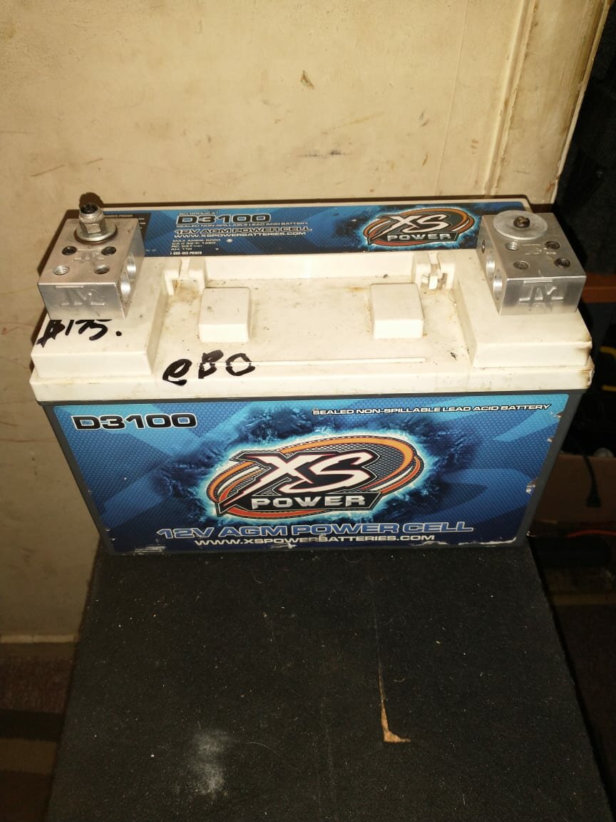

BassHeadBlakeYo Posted January 9, 2022 Author Report Posted January 9, 2022 4 hours ago, Dafaseles said: 100% the FIRST thing you should do is upgrade your electrical to handle your power. Right, figure a big 3 and a 2nd battery is going to be the biggest help here. I was offered a older xs power battery (3100d). I could get it for $100, is that a good price? and what do I need to look out for buying something like this battery? I have a oem battery under the hood, like a liquid filled one, can I just add this to the back of my system with no problems? Do liquid filled battery's and agms play well with each other?
