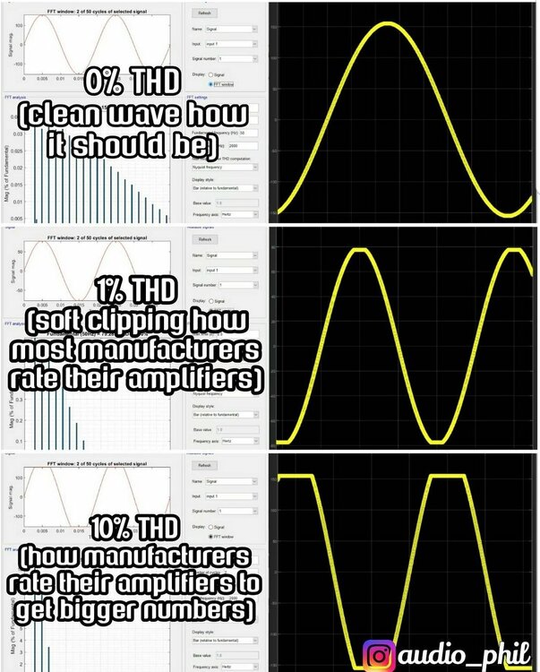

Dafaseles Posted January 19, 2022 Report Posted January 19, 2022 Your signal is a wave. It basically tells the speaker what to do. You want your wave in a nice curve at the top and the bottom. Clipping means your cutting off the top of the wave, and instead of a nice curve, it's flat at both peaks. The subwoofer will go up, stop, go down, stop, and so on. The voice coil needs the constant movement to keep cool. When it stops, it builds up heat that it can't overcome and will eventually fail. Here's a picture that might help explain. There are a couple of things that can cause clipping. Your volume is ripened up to high on your head unit and your head unit is sending the clipped signal. If you use your phone through blue tooth or an aux cord, that volume might be too high. Your gain on your amplifier might be set too high, or the gain in any other component like a DSP or EQ. Or, if your electrical can't keep up with the demand of the amplifier, that can cause clipping as well. 2011 Chevy Silverado under construction My build log here. Check it out!
