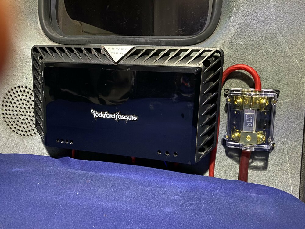

StuntBoy Posted January 25, 2022 Author Report Posted January 25, 2022 How long do you recommend for power wire to be? This system is in my semi,amp is mounted near rear window. I’ve only had system in there for two days.  Today I spend all day on phone truck driver problems 😂 I’ve only played like two songs, most of the day volume was at zero. It doesn’t get super hot that you can’t touch it. Just stays warms out of 10 I’d say 5.   I have the same amp in my personal truck,I’ve never paid attention to the warmth of it. But the one on my rig i have since I can touch it from reaching my hand back there. I read that Rockford fosgate amps run hot. Here’s a pic of where it’s mounted. I actually looking at an amp fan nowÂ
Dafaseles Posted January 25, 2022 Report Posted January 25, 2022 45 minutes ago, StuntBoy said: How long do you recommend for power wire to be? This system is in my semi,amp is mounted near rear window. I’ve only had system in there for two days.  Today I spend all day on phone truck driver problems 😂 I’ve only played like two songs, most of the day volume was at zero. It doesn’t get super hot that you can’t touch it. Just stays warms out of 10 I’d say 5.   I have the same amp in my personal truck,I’ve never paid attention to the warmth of it. But the one on my rig i have since I can touch it from reaching my hand back there. I read that Rockford fosgate amps run hot. Here’s a pic of where it’s mounted. I actually looking at an amp fan now At 12', you're fine. What is the 1/0 from the battery powering? Just that 1 amp? 2011 Chevy Silverado under construction My build log here. Check it out! Â
StuntBoy Posted January 25, 2022 Author Report Posted January 25, 2022 12ft for the power wire? That is 0 gauge from the batteries with a 150 amp fuse to the distribution block putting out 2 ft of 4 gauge power wire to the amp with a 100 amp fuseÂ
Dafaseles Posted January 25, 2022 Report Posted January 25, 2022 So, if that 1/0 is going to the fuse block, and then from the fuse block it's 4 awg to the amp, and that's all you're powering, you don't even really need that 1/0 or the distribution block. I mean, you're not hurting anything by having it there, it's just a little unnecessary. And the length of the wire doesn't matter as long as you're feeding your amplifier sufficiently. Say you just had 4 awg from the battery to the amp, and it was 30' long, well then you might want to up the size of the wire because at around 20' the wire will start to lose its energy. But, if you have 12' of 1/0, well that's below the 20' threshold that most manufacturers use to rate their wire. 1/0 OFC wire is good for about 350 amps of current at 20'. After 20', that number can start to diminish. So, even if you where just to use 12' of the 4 awg from the battery, you would still easily get plenty of amperage to the amplifier (assuming you're using OFC cable, not CCA). 2011 Chevy Silverado under construction My build log here. Check it out! Â
StuntBoy Posted January 25, 2022 Author Report Posted January 25, 2022 Yes it’s ofc,a Rockford fosgate amp kit. Running 0 gauge to the 4 gauge would that be a reason for the am to run warm then?  For the sub wire I’m using 8 gauge cca audiopipe cable.   Is it pulling to much power? Like stated RF amps run warm or do I need to re check everything else
Joe X Posted January 25, 2022 Report Posted January 25, 2022 1 hour ago, StuntBoy said: Yes it’s ofc,a Rockford fosgate amp kit. Running 0 gauge to the 4 gauge would that be a reason for the am to run warm then?  For the sub wire I’m using 8 gauge cca audiopipe cable.   Is it pulling to much power? Like stated RF amps run warm or do I need to re check everything else  4 AWG is what the amp terminals are designed for so no, that should not be the reason, however if you measure voltage at the amp terminals while the amp is playing and that voltage drops below 12V then you should find out why is dropping.  Flip that infrasonic filter switch on.  I wouldn't be surprised this amp heats, it's efficiency at 1 ohm load impedance is 63%, that means nearly 40 percent of the power consumed will turn into heat at the amp itself.
