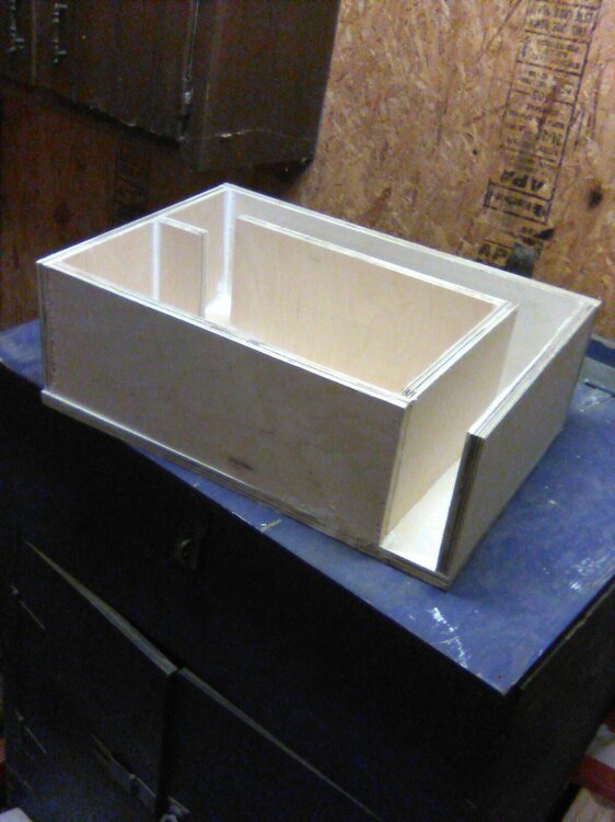

I just built this box for my room, sounds incredible. even with the sharp turns and tiny 6" displacement.
Actually gets down, and sounds SO powerful in my room. thought what the heck, lets see what is sounds like in my suv. Like crap it sounded!
wounder why? But I'm almost betting that it's tuned around there(25ish hz)

Usually, it's just room acoustics. It's very hard to get great sound in a car because there's so many other obstacles you have to overcome. That's why 300 watts in a home sub shakes the room and 300 watts in a car barely blends with the mids and highs. It's really just environment.
Well, if all else fails, you've got a really nice home sub application and you can justify upgrading your sound in your truck lol.
If you want to know for sure the approximate tuning, you can play test tones through it, and when you reach the tuning of the box, the sub will move the least. It's not exact, but it'll put you really close to the tuning.
