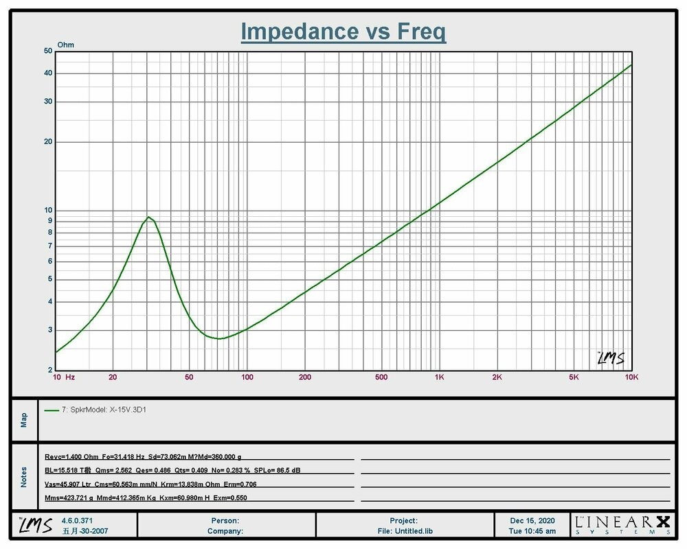

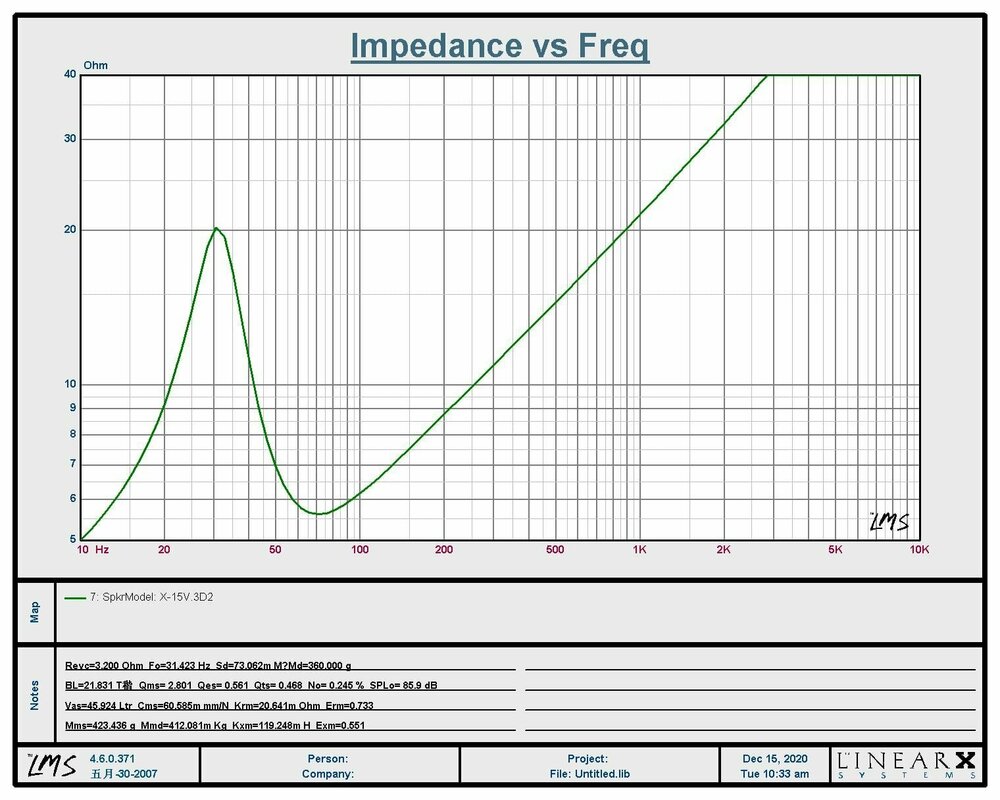

Man I have a x15v3d2 sundown audio. All I could find after some digging was that the box needed to be 4.25 ft³ and the port needed to be something like 62-64 in³ and tuned to 32hz. That's about all I could find on mine. No paperwork or nothing. I pulled some designs up online close to this and built the box and imma tell you im very impressed with the x15 v3 d2 15" subwoofer.  Very very impressed and will buy sundown from now on probably.  This thing hits so hard my wipers bounce off the windshield. I got the taramp smart3 1-2ohm 3000rms monoblock and oh my God you would be amazed at the sheer power of the amp and the bass the speaker puts out.
