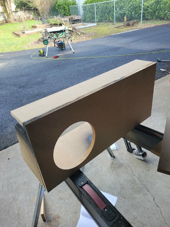

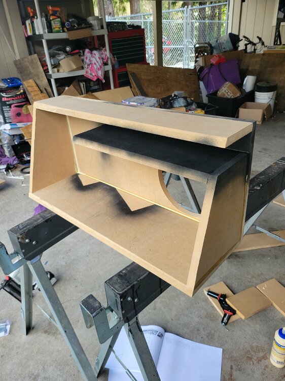

This is one I'm building today for a RF P2 10, we can design something similar if you want to stick to 1 sub. The main issue I see is your available height. You can probably do a pipe side port but optimum port area may require more length than what'll be available. That can be combated using a flared port. You can also grab something like this:

It makes a difference but it isn't like a 12" L7R will be equal to a round 15" CompR or anything. The enclosure in the picture is only 1.25 sq ft. It's too tall for you, but it shows a different shape so it doesn't stick out as far. There's 12's that work in as little as 1cu ft, going wider gives you room for a port. I'm not saying the particular box I'm building, I'm using that as an example. Your 1 cu ft square'ish box doesn't have enough room to port it with its current shape. If you don't care & want to stay sealed, shape doesn't matter. If you're looking to port it, that particular box will need some sort of external port because of its shape. We can design you a wider/more recessed box if you want to go ported but I guess I'm still unsure what you're after. Are you looking to replace gear, use your old gear or what? You seem like you want to keep that particular box, which is totally ok, but if that's the case, you should be looking for a 12 with a high qts rating and a larger amp.
