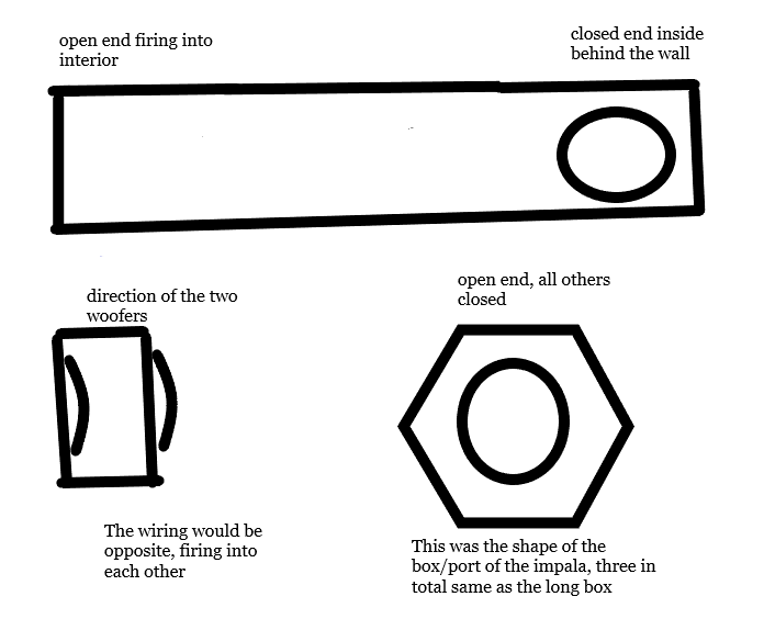

I'll try and do something in paint or something to get the idea across, but I'm no artist, Just a warning
On 2/22/2022 at 10:03 PM, BumpedCX5 said:
It may have been a manifold for an infinite baffle (free air) setup. Hard to tell without pics but if you muster something up in paint post it and we can figure it out.
I'm beginning to think it was some sort of infinite baffle as well, a lot of systems in show cars might have been more about the look than performance. I did some very basic drawings, that I'll attempt to post here. Like i said the Impala one ( the one with the hexagonal boxes) had three or 3 pods with two subs each I believe 12's, but might've been 15's. The van one had all of these box like things attached to a solid wall and the port side fired into the listening area. I don't remember the rest of the build, might've been a free air (infinite baffle) design. I posted the pic below, sorry not an artist and the long box is supposed to be straight, sorry
