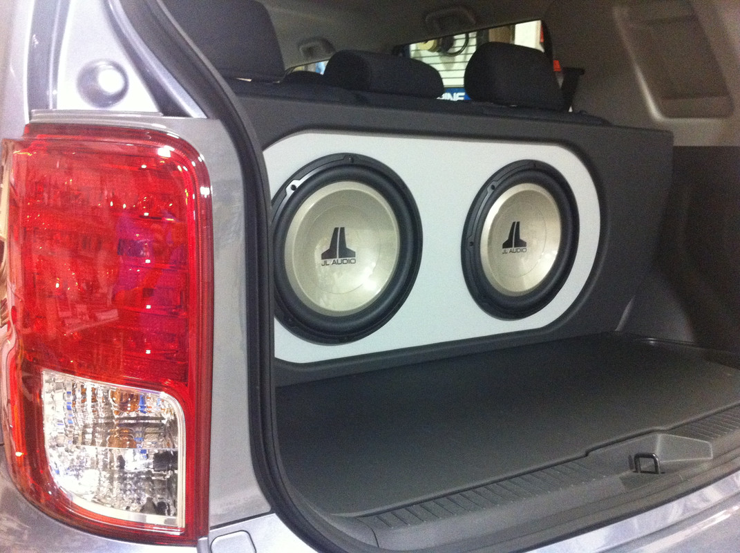

Scion xB boxes are like this:
@Joe X Yea, and ideally I would get that or something similar; however, I do deliveries in this vehicle and have the backseats laid down 99% of the time to make use of the cargo space. That's why I'm limited to the area I've spoke of. I know it's not ideal and I truly do appreciate your suggestions. I'm just hoping I can make something work for the area I do have to use.
I assume that worst case scenario, I can do something similar to what @CorNut spoke of, and have some kind of enclosure to fit shallow subs. Do you guys think that would be a better idea, given the variables at play?
Looking at what type of system you're after, I haven't found a shallow mount capable of what you're after. There is the Sundown SD4's, they claim they're shallows, but they're not very shallow. You could remove that seat though, and build the enclosure so the top of it acts as a bench so to speak, giving you the larger cargo area while front firing your subs. That wouldn't be difficult to accomplish. You'd get the added area and you could get a couple 12's in there with adequate airspace.
