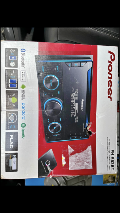

Thompson358 Posted March 22, 2022 Author Report Posted March 22, 2022 I have a cheap pioneer FH-S52B it’s all wallmart had over the weekend and I was anxious to get it playing I haven’t played with any setting on the head unit I had a friend who has allot more knowledge than me set the gain on the amp I didn’t have a multimeter my friend said to play it like this untill I get an alternator but I don’t think it’s my alt this sub hit harder on a 1000w pioneer amp than it does right now and I have no dimming I feel like it’s just clipping way too soon. really appreciate all the replies thank you guys!
