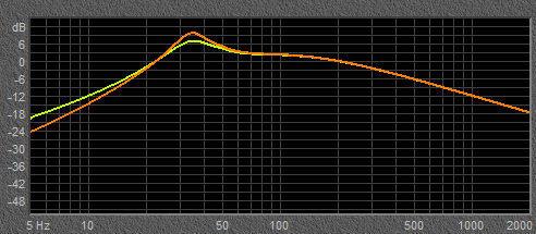

Thank you Joe, I understand sealed would be optimal. I should have stated that I wanted the flattest response from a ported enclosure. A friend suggested 1cf with 17 in square port area at 35hz. That sounds great, but I cant find Torres btc to calculate the port length.

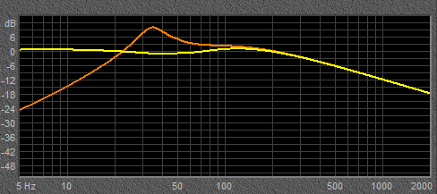

The SA-10 in a 1 cubic feet ported @35Hz is peaky and loud (orange plot), 0.5 cubic feet  sealed (yellow plot) is flat (but silent):
Using heavy damping you can make it less peaky as you can see:

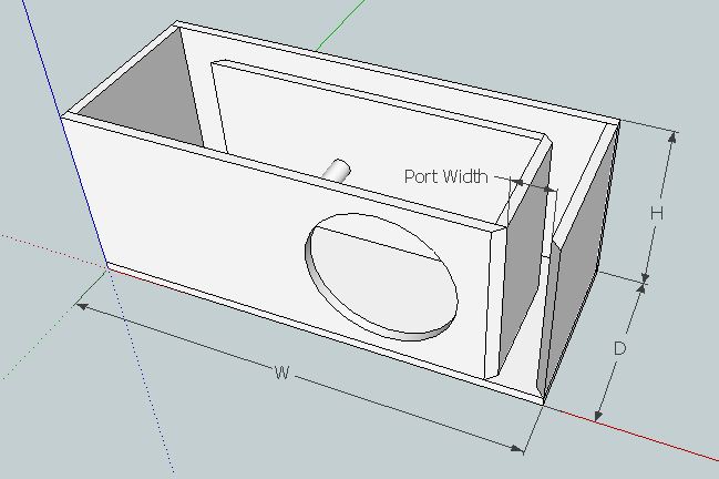

The box itself can be like this:
