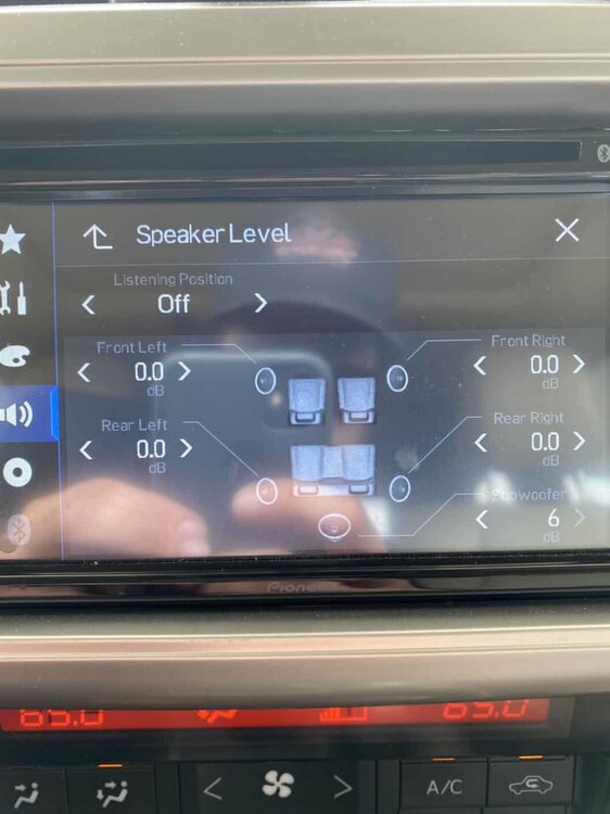

All good lol. I did set my sub level to its max but now after all is set I’m getting distortion
On 5/13/2022 at 10:48 AM, CstrokerV said:
So distortion all the time? Or now you can set it because the light lights up ?
Not all the time but I can set it now because the light will actually light up on the dd1. With sub level at 6 on HU I get distortion light at 34/40 volume. So I left it at 33 and the distortion light disappeared. Then I set my gain on my sub amp until distortion light came on and backed off until it disappeared. Just feel like I’m missing output. I don’t know. This is frustrating. Also my electrical is: dc power high output 270 amp alternator, big 3, and single 0 gauge run to the trunk where I have a 90ah agm battery.
On 5/17/2022 at 4:38 PM, CstrokerV said:
What tone did you use for the sub amp  I use the -10db
I used -10db after finding where my headunit clips at with the max level on the source level adjustment and I couldn’t get enough voltage with the -10db tone to get the distortion light to go off!
