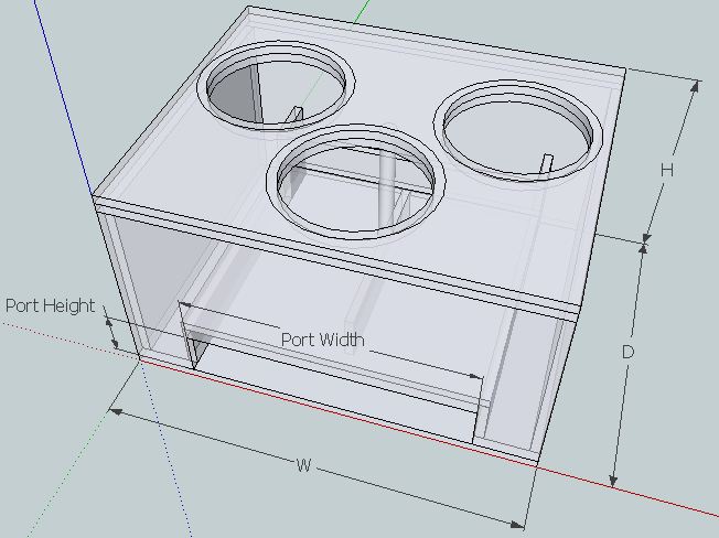

Joe X Posted May 17, 2022 Report Posted May 17, 2022 When you have 3 subs you do something like this:

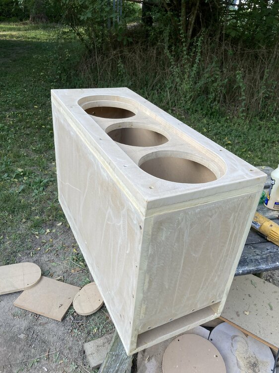

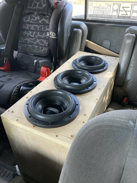

BLUE COLLAR MISFIT Posted May 20, 2022 Report Posted May 20, 2022 I built this box for 3 sundown sa 8s at 32hz they surprised me on how well they hit the lows
tyma1026 Posted May 20, 2022 Author Report Posted May 20, 2022 Nice. They definitely hit the lows. Have you metered it?
BLUE COLLAR MISFIT Posted May 20, 2022 Report Posted May 20, 2022 46 minutes ago, tyma1026 said: Nice. They definitely hit the lows. Have you metered it? No I no longer have them I ended up selling them to do a backseat delete to run 2 15s in my crew Silverado
