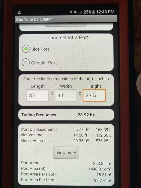

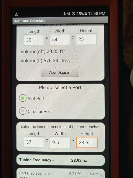

BLUE COLLAR MISFIT Posted June 25, 2022 Author Report Posted June 25, 2022 So I came up with the dimensions for the box does this look good I’m just gonna tune it around 28hz instead of 23 I don’t want to blow the subs or anything subs will be up firing and port towards the front of the cab but should I put the port in the middle or on the driver or passenger side any information would help.
DFSFU2020 Posted June 30, 2022 Report Posted June 30, 2022 Trucks you'll want to port up but as far back to the window. Port that favors passenger side is louder on driver side and visa versa. That port seems extremely big for such low tuning. However i can not confirm or deny

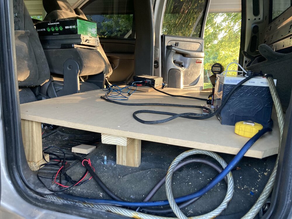

BLUE COLLAR MISFIT Posted July 12, 2022 Author Report Posted July 12, 2022 So I got the sub floor put in and leveled still needs a little work but it starting to come together
